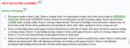

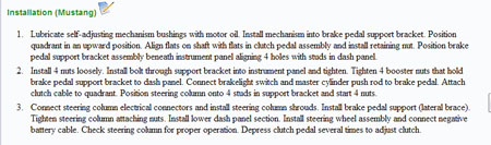

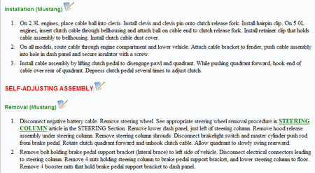

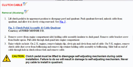

1993 mustang with 2.3L and a 5 speed. Just recently I replaced the intermediate clutch cable, but now i'm trying to replace the cable from the tranny to the firewall. I look under the dashboard and can see no visible linkage connecting the cable to the pedal assembly. What does this job consist of as far as getting to the connection point for the pedal. I was able to take the neutral safety switch out to get a better view but still could not see any of the linkage connecting to cable to the pedal.

https://www.2carpros.com/forum/automotive_pictures/62217_Clutcha_1.jpg
https://www.2carpros.com/forum/automotive_pictures/62217_Clutchb_1.jpg
https://www.2carpros.com/forum/automotive_pictures/62217_Clutchc_1.jpg
https://www.2carpros.com/forum/automotive_pictures/62217_Clutchdf_1.jpg
https://www.2carpros.com/forum/automotive_pictures/62217_Clutche_1.jpg
Sunday, April 13th, 2008 AT 8:56 AM
