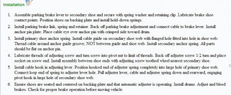

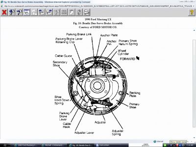

I have been remove the rear brake shoes but could not install them again. Do you have the instraction for install them with picture?

Thursday, March 11th, 2021 AT 2:31 PM
