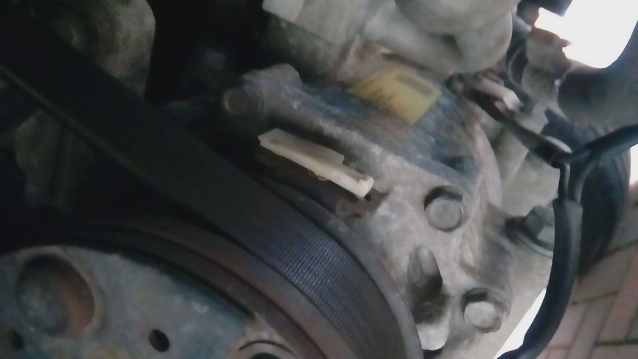

Temperature gauge, speedometer and fuel gauge intermittent work then do not work. I found taped joint underneath car when moving it got a response fuel gauge worked all was well it happened again. I then removed the tap from the joint and wires just fell apart. I had two black wires going back somewhere and a black and green/yellow going towards front of vehicle and into wiring, I do not know if there the right way round but took a chance still nothing worked. I then reversed them still no joy. All fuses test okay, every thing else works. Thanking you, Mr. L Banes.

Yes, I have this car so lets fix you up. Can you take a picture for what you are talking about so I can see whats going on? Upload it here in your response.

Hi Ken.
Got a old connector from breakers it fitted to engine near off side front headlight. Do not know what it works though.

So the wires you are holding are from under the hood? Can I get a picture of the area and color of the wiring please?

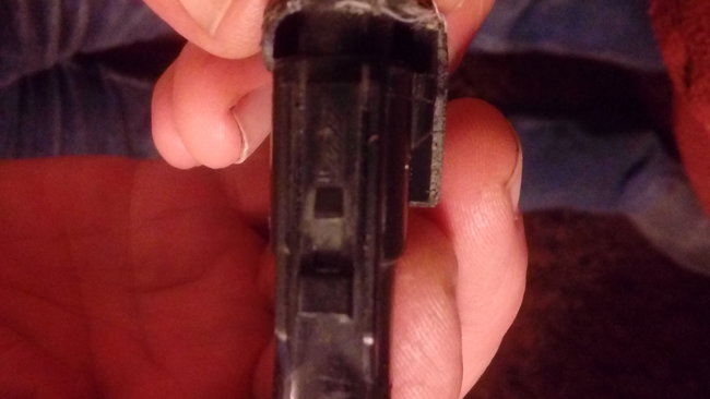

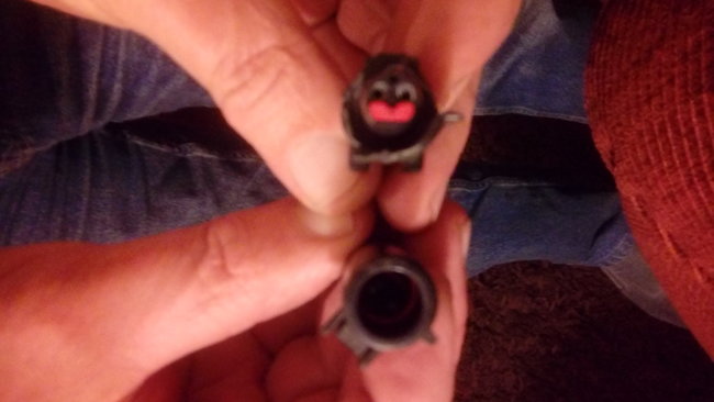

L BANES
  • 5 POSTS
Hi Ken
Here is picture of brake the white shown. When con is fitted there are two black wires to the left and green and yellow to right the left slant of bracket are the two black wires. Sorry to be so jumbled the pulley is the bottom of engine.
-1
Friday, November 27th, 2020 AT 4:47 PM (Merged)
KEN L
  • MASTER CERTIFIED MECHANIC
  • 55,301 POSTS
This look like a compressor wire, is it this wire the one you move to get the cluster to work or is this other problem?

L BANES
  • 5 POSTS
Yes they come to life then but I have not connected them because I do not know which way round. If I get it wrong what is the worst that could happen?

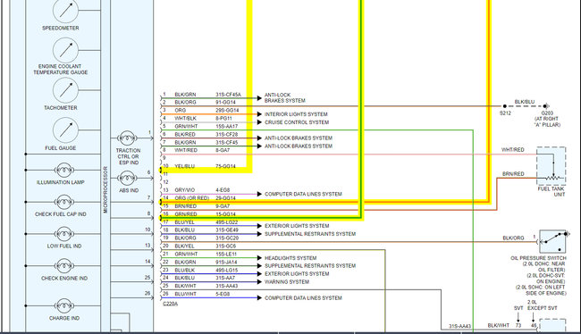

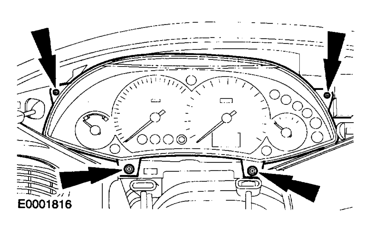

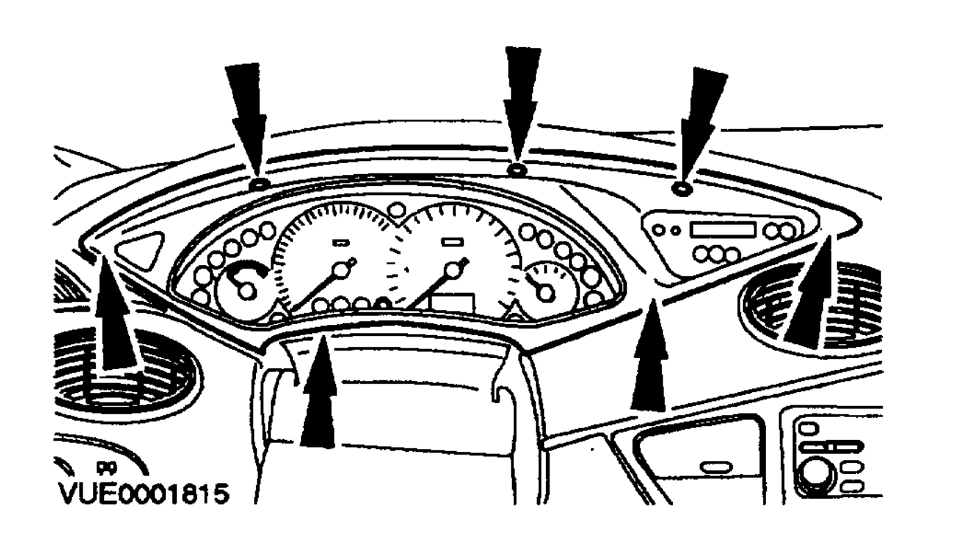

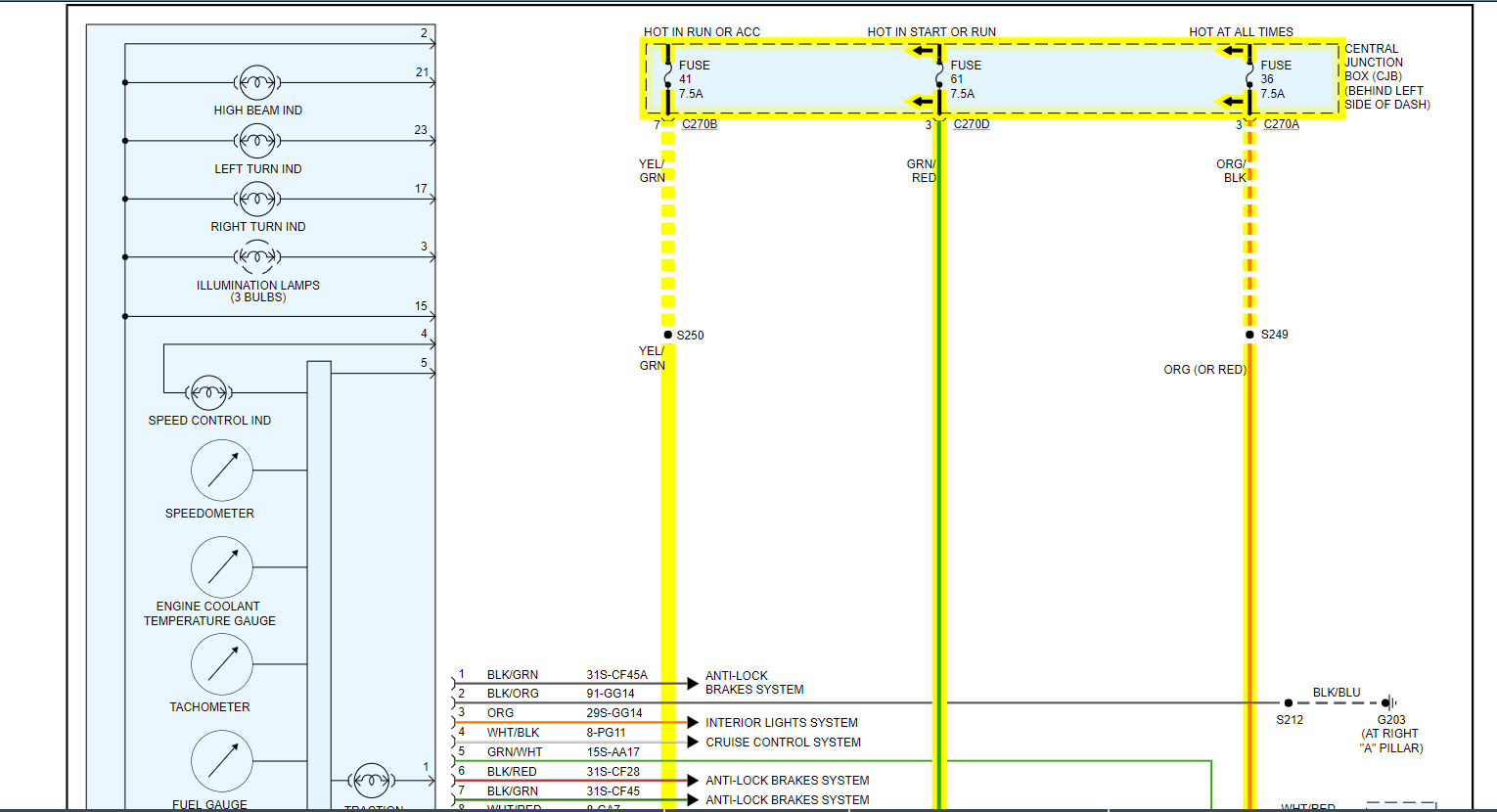

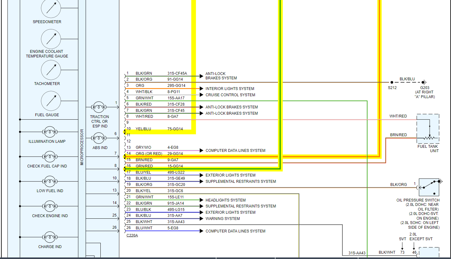

I attached a wiring diagram for you to check. You need to test the fuses listed for power on both sides as they provide power for the cluster to work.
If you have these powers then the cluster has failed and needs to be replaced. The instructions are below as well.
INSTRUMENT CLUSTER
REMOVAL
NOTE: If a new instrument cluster is being installed connect WDS. Upload the instrument cluster configuration information using the programmable modules installation routine prior to commencing the removal of the instrument cluster.
1. Detach the instrument cluster bezel. (Steering wheel removed for clarity).
2. Remove the instrument cluster bezel.
Disconnect the luggage compartment release switch electrical connector.

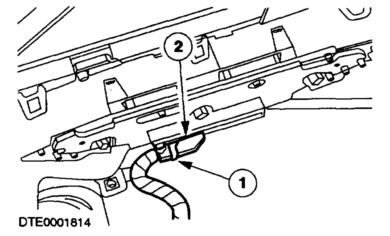

3. Detach the instrument cluster.
4. CAUTION: The instrument cluster must be kept upright to avoid silicone liquid leaking from the gauges.
Remove the instrument cluster.
1 Release the locking tang.
2 Disconnect the instrument cluster electrical connector.
INSTALLATION
1. NOTE: If a new instrument cluster is being installed connect WDS. Download the instrument cluster configuration information using the programmable modules installation routine after the installation of the instrument cluster.
To install, reverse the removal procedure.

You will blow a fuse is all, if they are both black it should not matter.

L BANES
  • 5 POSTS
Okay.
Will give it ago later and will let you know the outcome.
L BANES
  • 5 POSTS
Hi ken.
Good news, made connection gauges up and running been for long drive. Everything seems okay.
Thank you ever so much and take care.
Les.

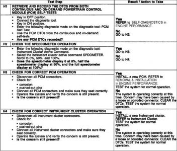

DAVE H
  • 13,384 POSTS
Hello .. thanks for the donation ..much appreciated
Have the car plugged into a good diagnostic scanner to check for fault codes stored on the BCM (body control module)
