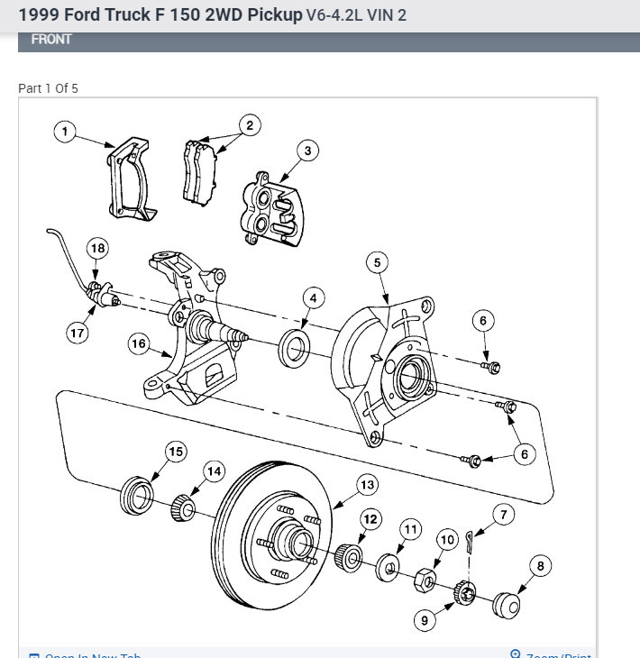

I have replaced front caliper, pads and rotors but have a squeak when brakes are applied. Do you have anything else I could try.

Many times, the squeaks come from the caliper bolts or the contact point for the pad and the caliper.
Have you greased the caliper bolts and use anti squeal compound on the back of the pads?
Also did this issue exist before the replacement?
