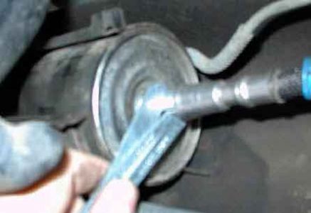

  • 75,992 POSTS
Fuel Line Disconnect Tool
https://www.2carpros.com/forum/automotive_pictures/12900_fuel1_1.gif
SPECIAL TOOL(S)
REMOVAL
https://www.2carpros.com/forum/automotive_pictures/12900_fuel2_2.gif
https://www.2carpros.com/forum/automotive_pictures/12900_fuel3_2.gif
1.Use the Fuel Line Disconnect Tool to disconnect the fuel lines from the fuel filter.
INSTALLATION
https://www.2carpros.com/forum/automotive_pictures/12900_fuel4_1.gif
1.Install the fuel filter. NOTE: When installing fuel lines to the fuel filter, push the lines onto the ports until a definite "click" is heard, then pull on the fittings to ensure they are engaged.
2.Connect the fuel lines.

ZMANJEEP
Here is a picture of the tool you will need. I bought this one at O'Reillys for $3.99. Don't count on them to let you know you need one before you break the clip inside one of the hoses. FORD won't sell you just a clip either or even an individual hose. I had to buy BOTH new hoses from FORD for $112.00. Last NEW FORD I'll ever own. Good luck.
https://www.2carpros.com/forum/automotive_pictures/174832_101_2786_1.jpg
this video will help show you how to use it.
https://youtu.be/Boi0DPXVHbM
this guide can help as well
https://www.2carpros.com/articles/how-to-change-a-fuel-filter
