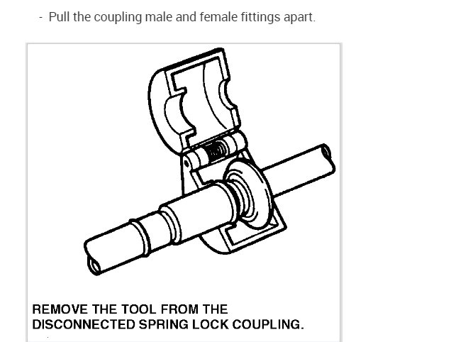

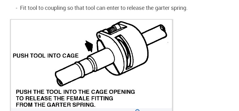

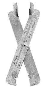

I am changing the fuel filter how do the lines come off
Saturday, May 29th, 2021 AT 10:32 AM (Merged)
RACEFAN966
  • 5,029 POSTS
You will need a tool that you will push up into the line to release the clips then just pull the line off. First pic is the tool the second it how you use it. If you need any more help let me know.

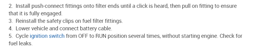

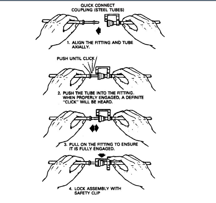

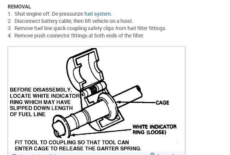

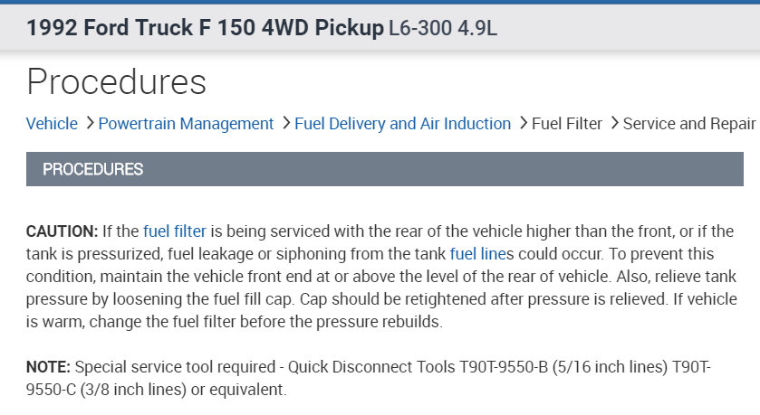

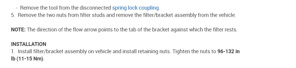

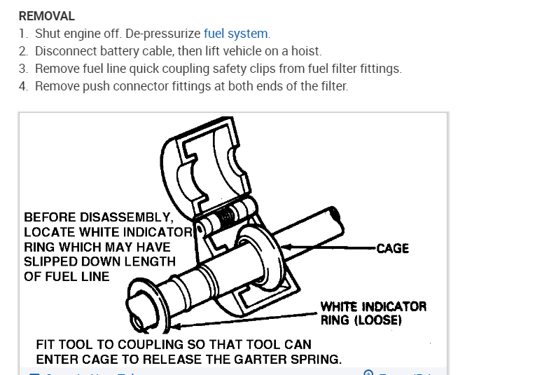

This sounds like it could be a fuel filter problem. The fuel when it is pumped from the fuel tank passes through a filter before it makes it to your vehicle's fuel rail. When this filter gets plugged, then little to no fuel will make it to your vehicle's engine. Here is a link for you to go to:
https://www.2carpros.com/articles/how-to-change-a-fuel-filter
In the diagrams down below I have also included the factory instructions for the removal and installation of your vehicle'
s fuel filter. Please go through these guides and get back to us with what you are able to find out.

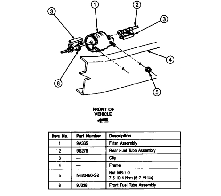

BLUELIGHTNIN6
  • 16,542 POSTS
The fuel filter is located in the framing on the driver side, in front of the gas tank.
FUEL FILTER ASSEMBLY
https://www.2carpros.com/forum/automotive_pictures/261618_Noname_172.jpg

How does the quick connect lines release
Saturday, May 29th, 2021 AT 10:33 AM (Merged)

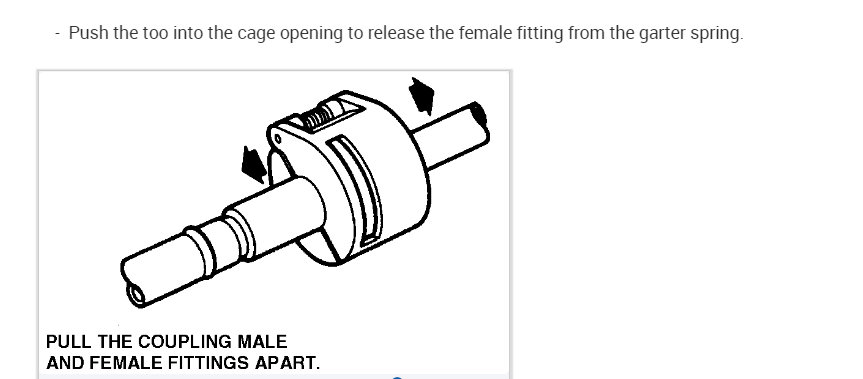

WRENCHTECH
  • 20,757 POSTS
There is a tool that has to be slipped inside to release it.
https://www.2carpros.com/forum/automotive_pictures/561653_Fuel_filter_tool_1.gif
https://www.2carpros.com/forum/automotive_pictures/561653_Fuel_line_disconnect_tool_KD3321_1.jpg
https://www.2carpros.com/forum/automotive_pictures/561653_Fuel_line_disconnect_on_ford_1.gif
