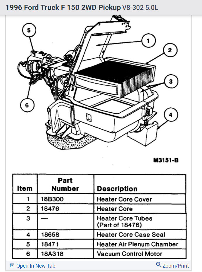

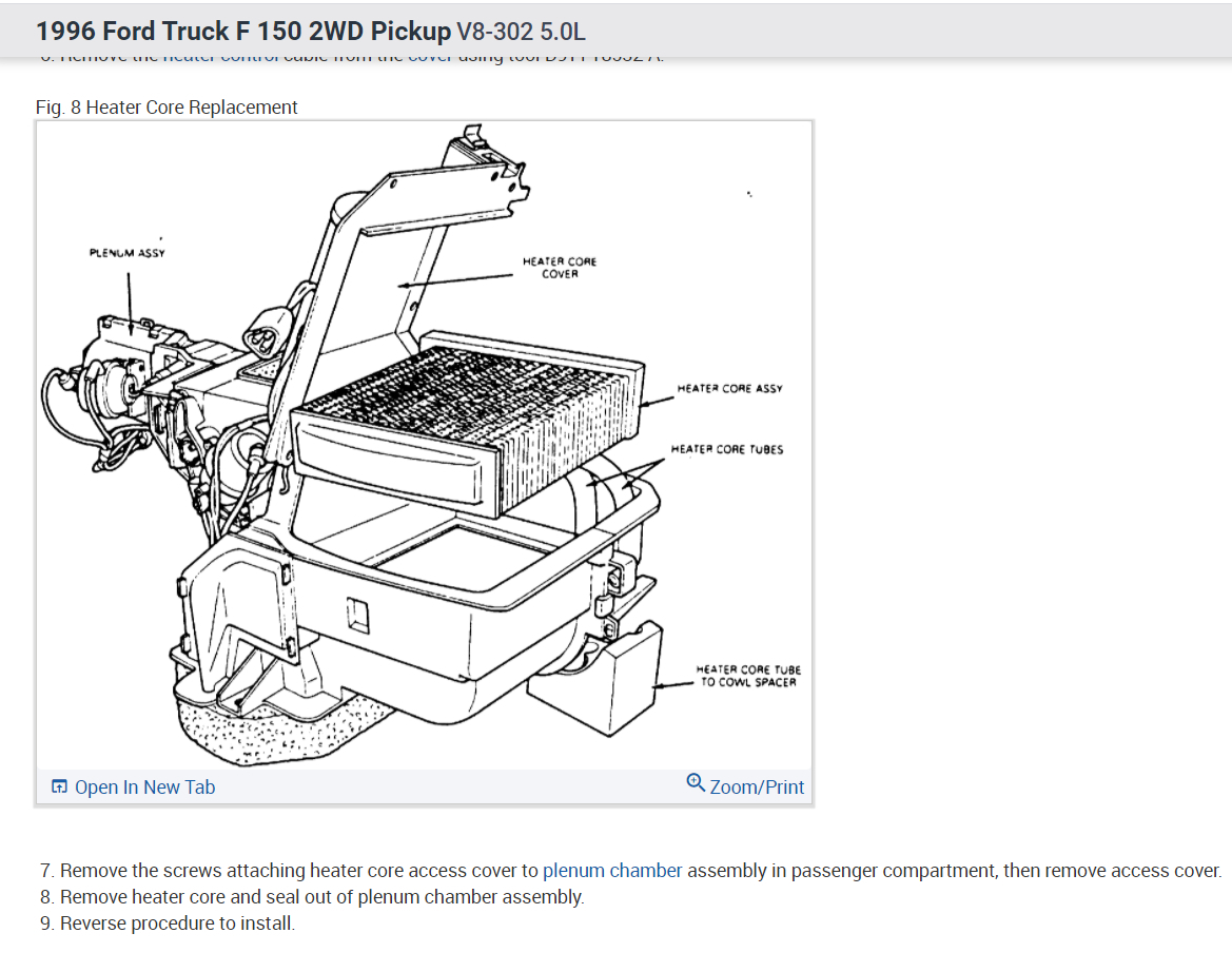

After the cover is off the heat unit how do I remove the old and install the new heater core.
Wednesday, December 9th, 2009 AT 4:04 PM
BLUELIGHTNIN6
MECHANIC
16,542 POSTS
Here are two guides to help us with the instruction in the diagrams below to show you hoe on your truck.
https://www.2carpros.com/articles/replace-heater-core
if your truck has AC it will need to be vacuumed down and recharged this video will show you how.
https://youtu.be/4EqdrBVb0sY
