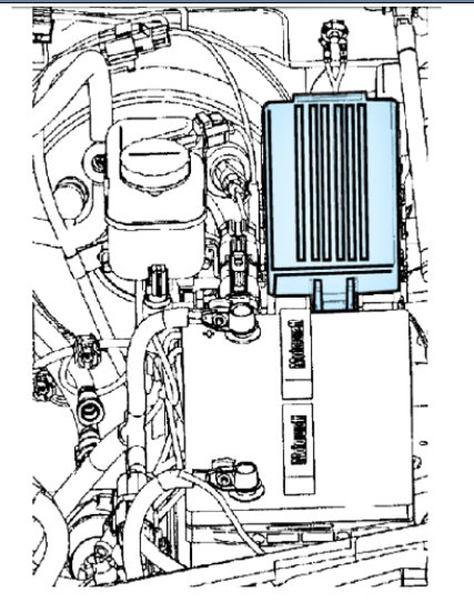

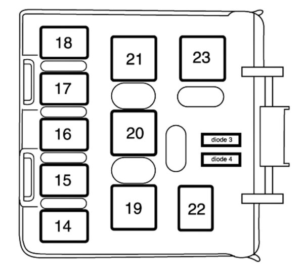

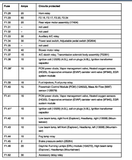

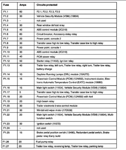

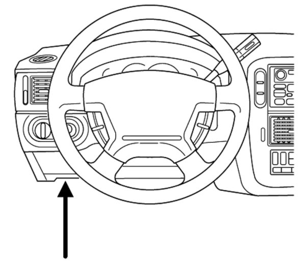

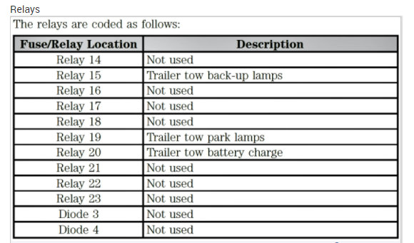

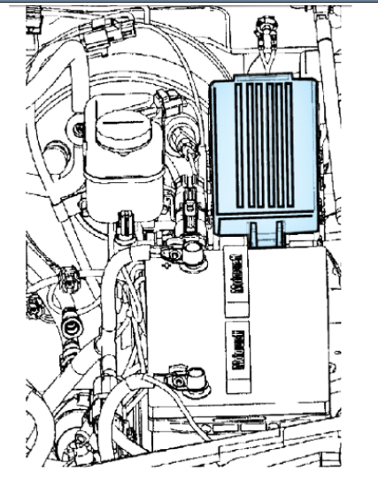

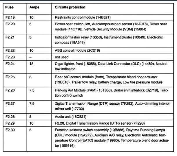

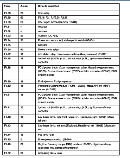

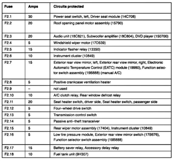

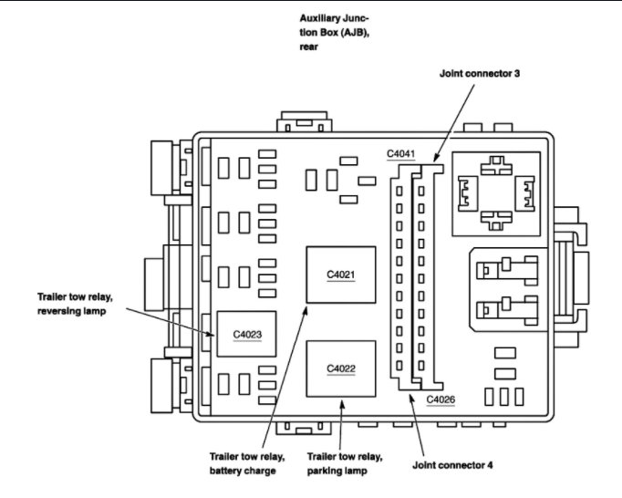

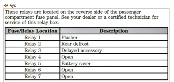

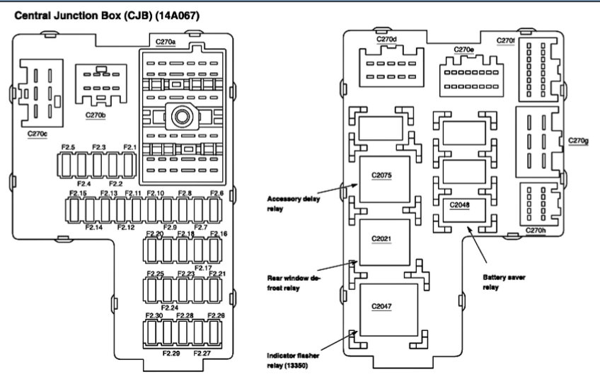

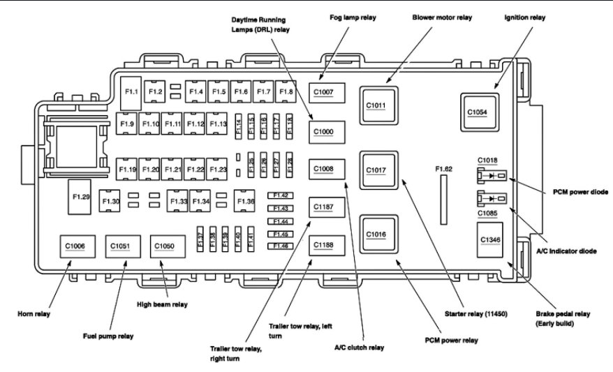

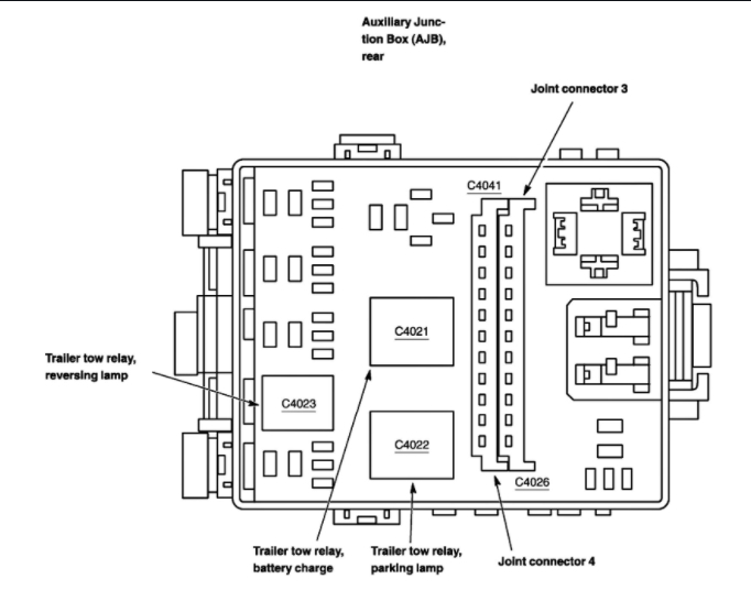

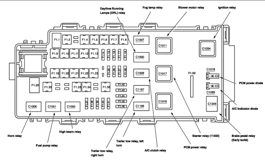

Where are the fuse located and how do I check them?
Thursday, December 3rd, 2009 AT 8:11 AM
DANNY L
MECHANIC
5,648 POSTS
Hello, I'm Danny.
Here is the information you requested. Here are a few tutorials for you to view on how to check and replace fuses:
I've attached pictures below showing the fuse and relay locations on your vehicle. Hope this helps and thanks for using 2CarPros.
