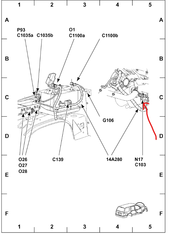

Low pressure oil, can you tell me where the oil pressure sensor is?

Syre the oil pressure sender is near the oil filter and lower radiator hose, is the sensor is okay I would remove the oil pan to see if any sludge is blocking the oil pump pick up. Also here is a guide to help us see hats going on with the location of the oil pressure sensor in the images below.
https://www.2carpros.com/articles/high-or-low-engine-oil-pressure
Check out the images (below). Let us know how it goes
