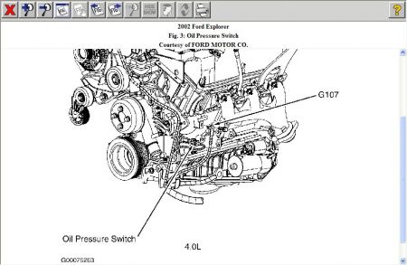

THE LOW OIL PRESSURE LIGHT IS ON, WHERE DO I FIND THIS UNDER HOOD? WHAT ELSE NEEDS TO BE CONSIDERED IF KEEPS DISPLAYING?

Check the oil pressure with a mechanical gauge if normal replace the oil pressure switch abnormal could be oil pump/engine bearings/oil galleries etc
