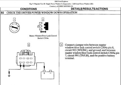

the window will not go up, all other windows work fine just the driver side. Not sure how to trouble shoot. Any help would be appreciated. Thanks

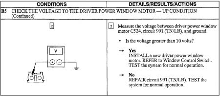

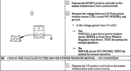

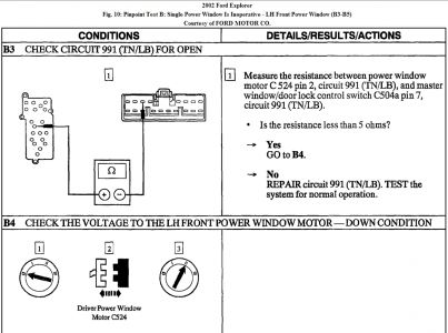

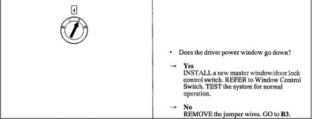

Here's the flow chart:
