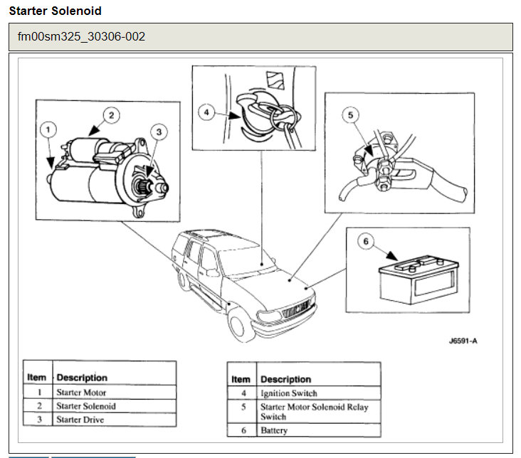

When I try to start my 2002 Ford Explorer, there is a repetitive 'tick'ing noise and nothing else happens. My battery is fully charged. Someone told me it may be the solenoid, but I don't know where it is even located. Do you think they are right? Where is the solenoid located? What is the best way to check the solenoid?
Thursday, September 23rd, 2010 AT 6:19 PM
21 Replies
  • 75,992 POSTS

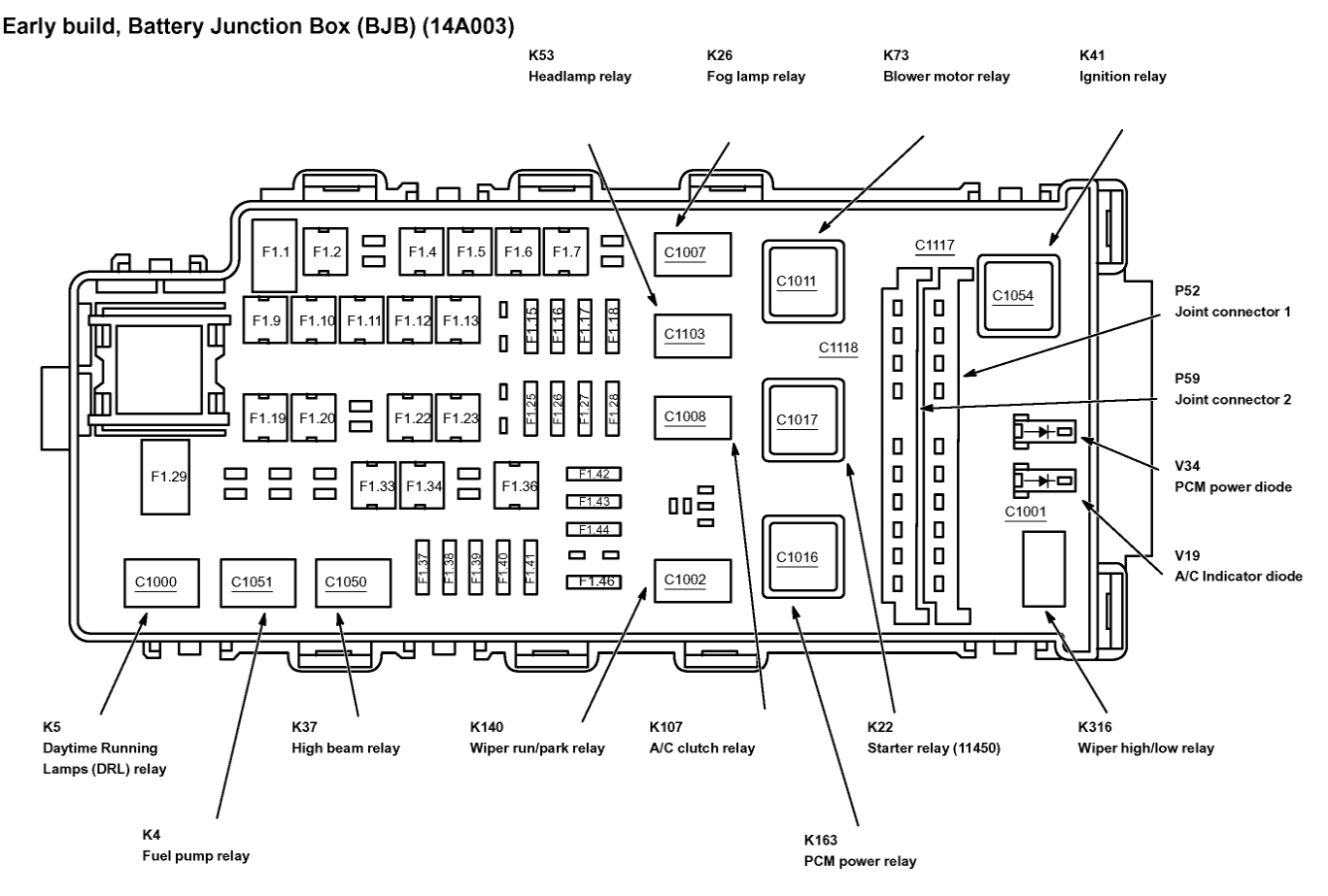

It sounds more like the positive battery cable is going bad the starter solenoid it located on the starter here is a guide to help you see what I am talking about.

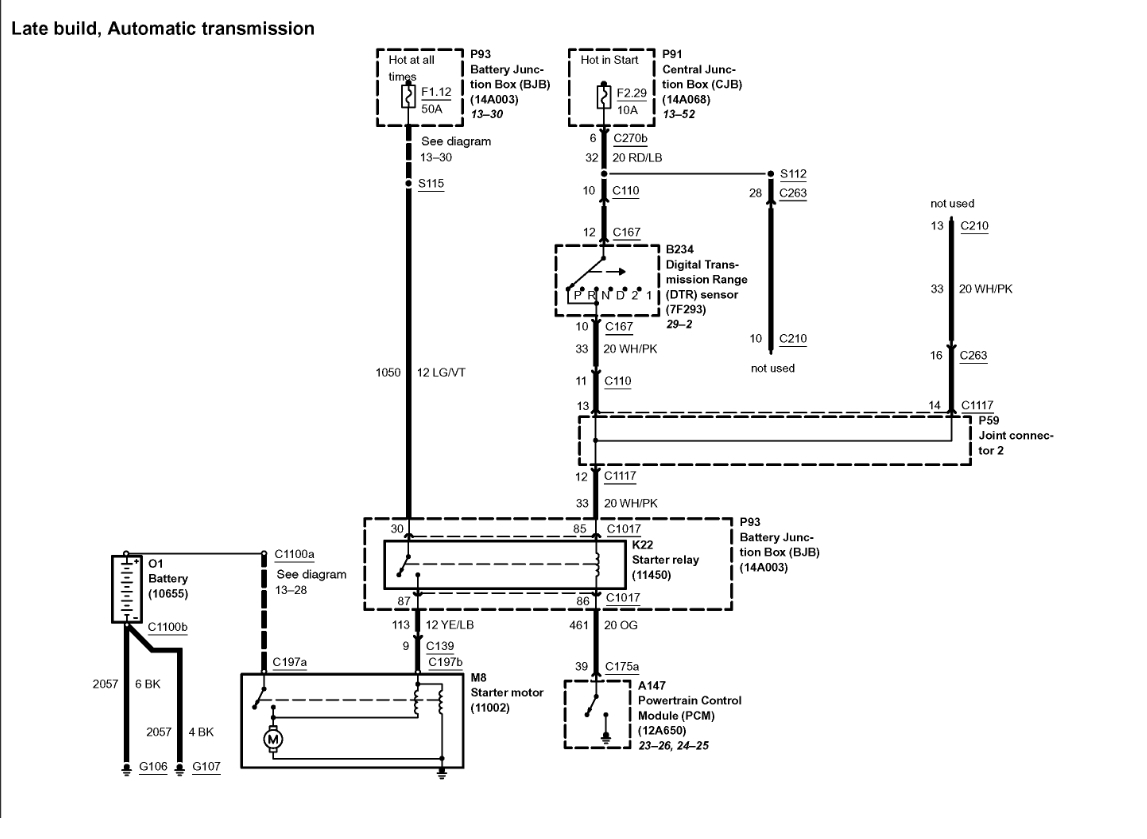

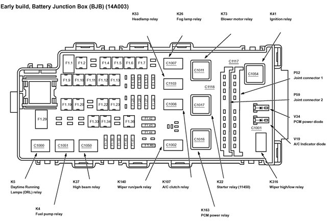

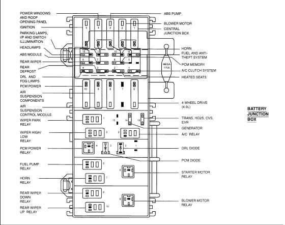

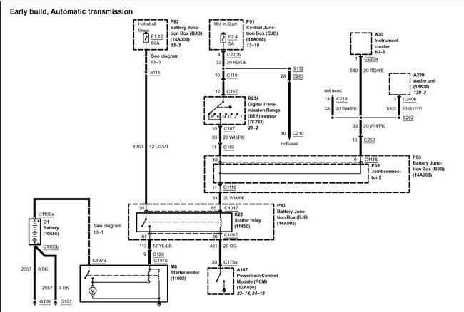

There is a starter relay though check out the diagrams below to see how the system is wired and where the relay is.

There are two starter solenoids for your car; one is down by the starter motor and the other is up by the battery on the drivers side. Here is a guide that shows the lower solenoid:
Check out the diagrams (below) for both locations.

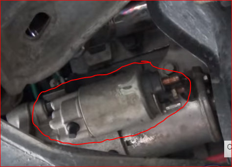

This is what the solenoid is like mounted on the starter motor. I have attached a picture and circled the solenoid in red. Hope this helps and thanks for using 2CarPros.
