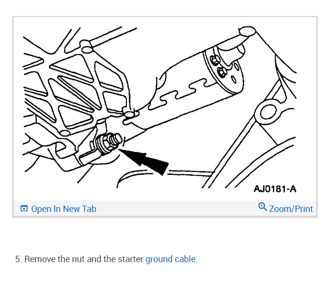

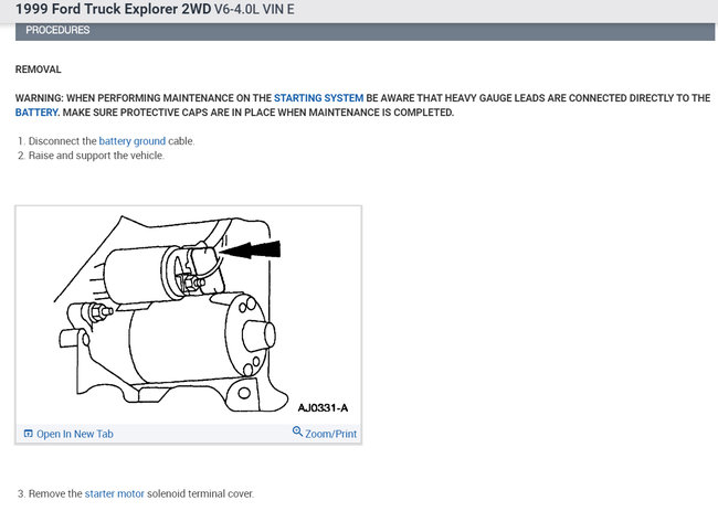

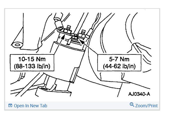

Is the starter replacement on a 1999 explorer sport 2 door, 2 wheel drive, an easy job, I mean is it the same as normal, no speccial conditions.
Friday, February 5th, 2010 AT 10:25 PM
14 Replies
OBXAUTOMEDIC
  • 3,711 POSTS
Hi Kirk,
Yes it is pretty straight forward, the only possible problem is getting to the wires on the Solenoid.
This guide should help walk you through the steps
Check out the diagrams (Below). Please let us know what you find.

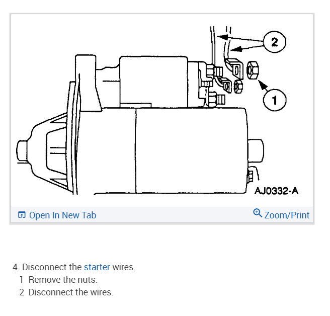

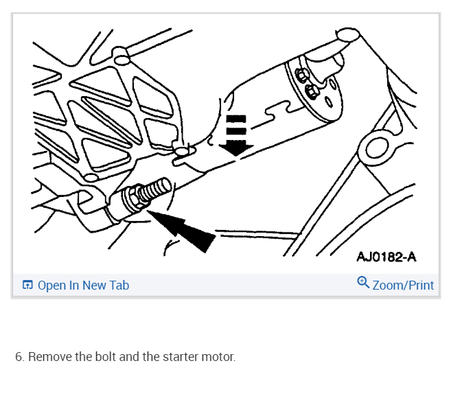

REMOVAL & INSTALLATION
Removal
Disconnect negative battery cable. Raise vehicle. Disconnect battery cable from starter. Disconnect starter solenoid wiring. Remove starter mounting bolts or nuts. Remove starter from vehicle.

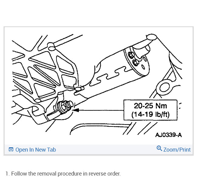

Installation
Position starter assembly onto flywheel housing. Start bolts. Hold starter against mounting surface, fully inserted into pilot hole. Tighten bolts or nuts to specification.
Connect battery cable and solenoid wiring to starter. Tighten to specification. Lower vehicle. Connect negative battery cable. Check starter operation.

Some of the bolts and nuts can be difficult to remove look for a place to use a universal and long extension works pretty good.
Here is a guide that can help
Saturday, May 23rd, 2020 AT 4:34 PM (Merged)

Remove the battery cable. Lift truck for access. Remove the battery wire and the small wire from ignition switch. Remove 2 attaching bolts and remove the starter motor.

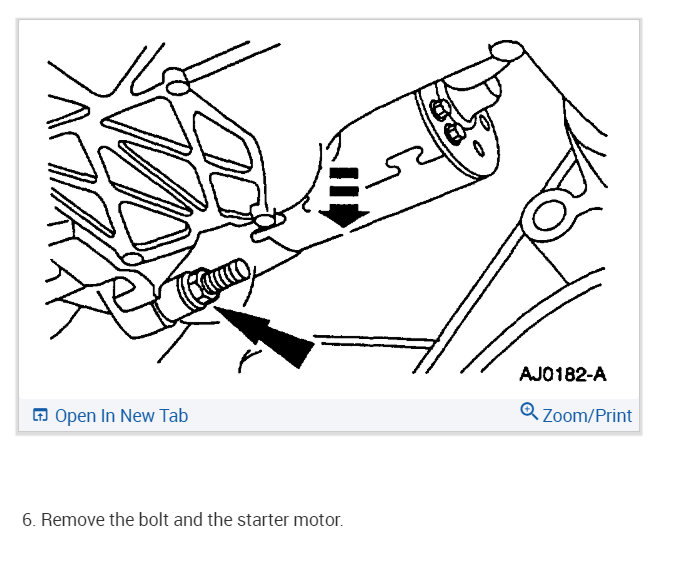

I have the bolts out of the starter, but can't seem to wiggle it out. Not enough room.
Do I have to remove something else to get the starter out? This is a 96 with a V6, 4-wheel drive.
Saturday, May 23rd, 2020 AT 4:35 PM (Merged)
TRUCKINSOB2221
Are you sure you got all of the bolts out sometimes they put them on the top were you can't see them. I've had too replace mine several times and it is a tight fit. If you take a screw driver and find an opening you can pry it out a little. And it should just pop right out.

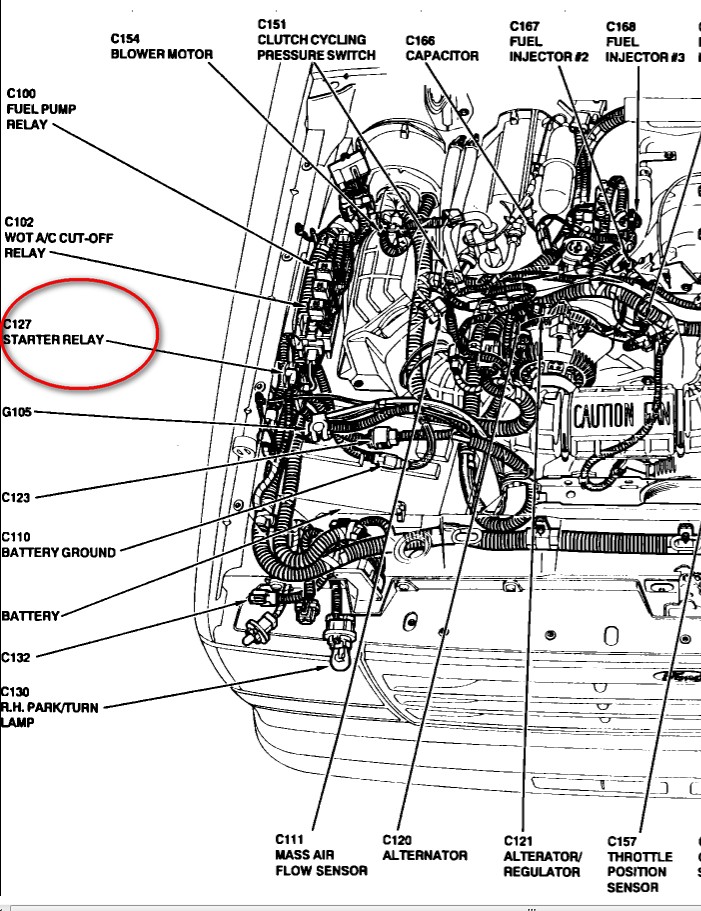

Inspect and test the starter relay, starter motor and ignition switch
WRENCHTECH
  • 20,761 POSTS
A relay and a solenoid do the same thing. You'll do a lot better listening to Ras and not the sales clerks at Autozone
