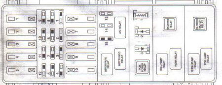

My windows and sunroof won't open

There is a very good chance you have a ** Mega Fuse 30 Amp. that needs to be replaced.

Power distribution box "NOT THE DASH PANEL FUSE BOX"
The power distribution box is "BLACK BOX"
located in the engine compartment on the drivers side fender up near the firewall next to the power brake booster.
The power distribution box contains "high-current fuses" that protect your vehicle's "main" electrical systems from overloads.
Always disconnect the battery before servicing high current fuses.
Always replace the cover to the Power Distribution Box before reconnecting the battery or refilling fluid reservoirs.

4 30A** Power Moon Roof, Accessory Relay Delay

Mega Fuse #4 30A** is the fuse in question of replacement.
>>>>>>>>[175 MEGAFUSE]<<<<<<<<
https://www.2carpros.com/forum/automotive_pictures/433905_explorer_power_dist_panel_fuse_2.jpg
The Power Distribution Box layout is pictured above. Remove the black cover. You want remove **Mega fuse #4. Location >>("Far Left" side of the Power Distribution Box looking down at the box). The second fuse "UP" marked #4 and check it to see if it is toasted (Blown) replace the **30 Amp. Mega Fuse in the #4 slot of the Power Distribution Box with a good one reconnect you battery and you should be good to go.
