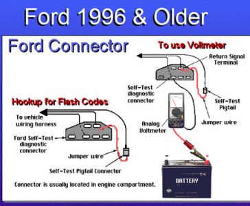

https://www.2carpros.com/forum/automotive_pictures/62217_Test_Connector_Pre96_8.jpg
do this and count the flashes...Count the flashes, a 22 will flash as 2 flashes then a short pause, then 2 flashes, if more than one code is stored, the pause will be longer. The codes will display three times and end with 11 or 111. Write them down and post here.
