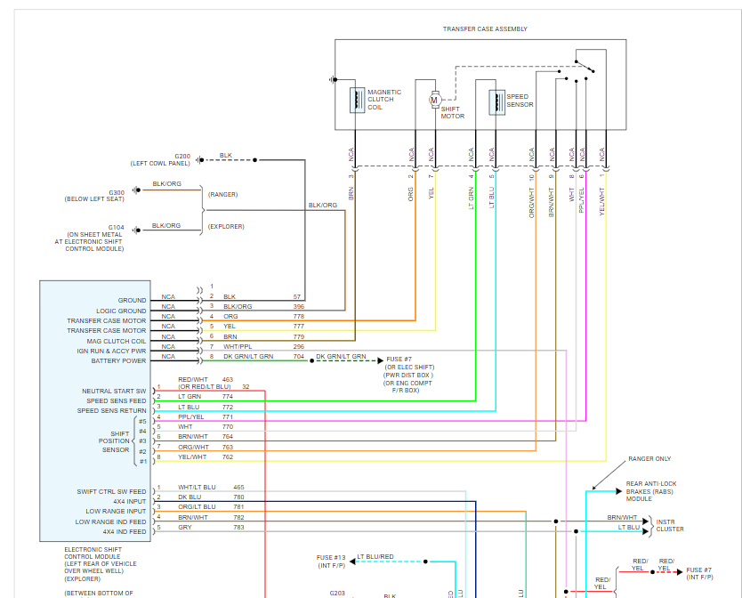

Have no 4 wheel drive?
93PICKUP
  • 1993 FORD EXPLORER
  • 6 CYL
  • 4WD
  • 133,000 MILES
Have voltage to dash switch and did self test on computer but have no 4 wheel drive

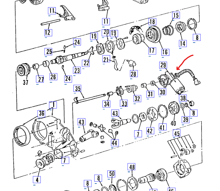

KNOBBY
  • 37 POSTS
Check the electric motor on the trans fer case they always go bad

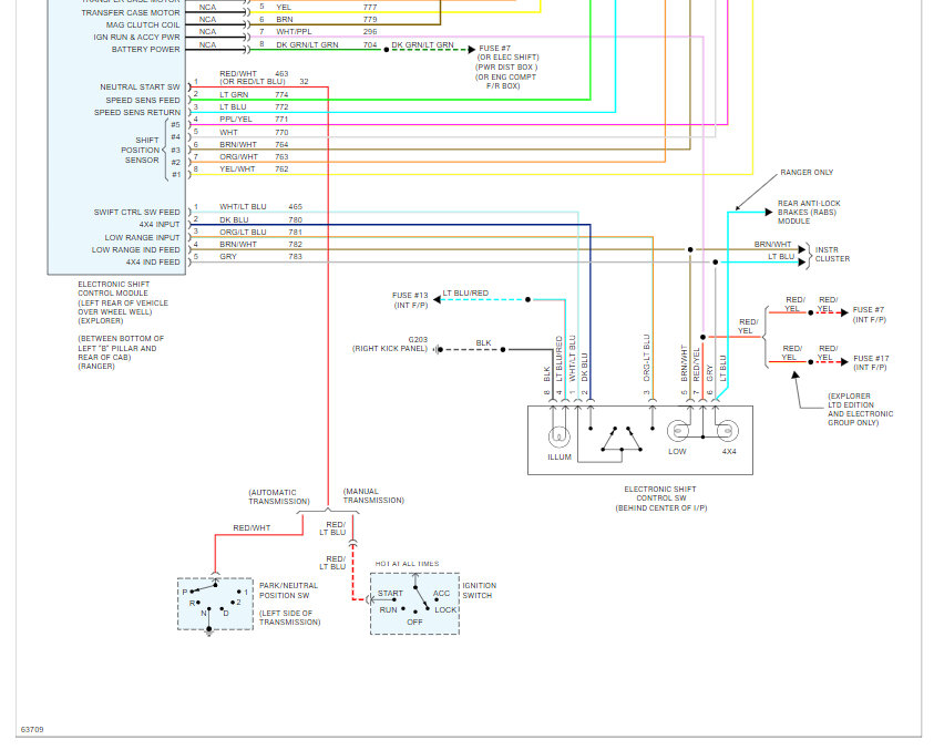

KEN L
  • MASTER CERTIFIED MECHANIC
  • 55,090 POSTS
Yep, check the 4x4 fuses and if all are good I would replace the transfer case shift actuator they go out all the time on these trucks. Here is the transfer case wiring diagrams as well so you can see how the system works. Check out the images (Below). Let us know what happens and please upload pictures or videos of the problem so we can see what's going on.
