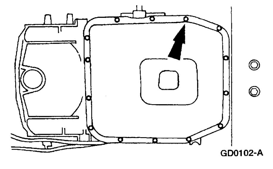

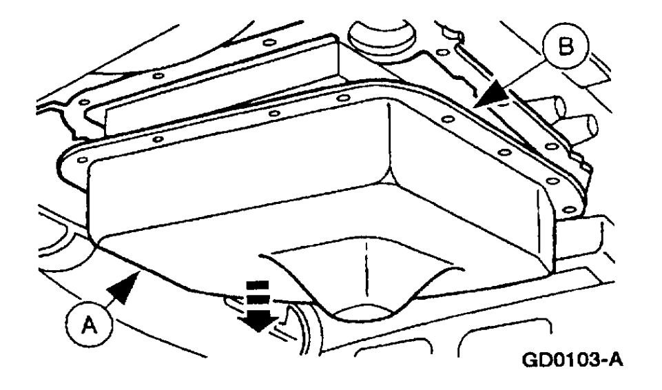

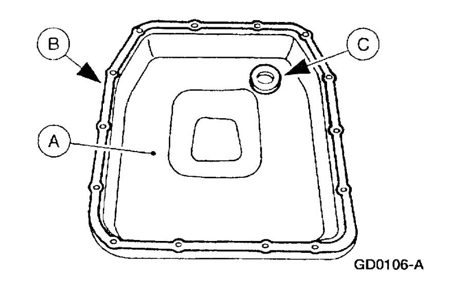

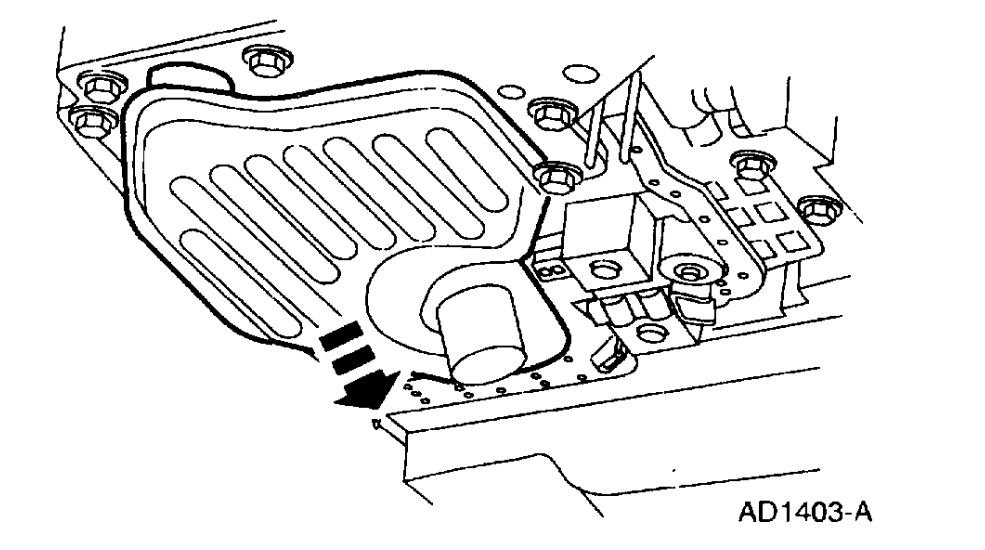

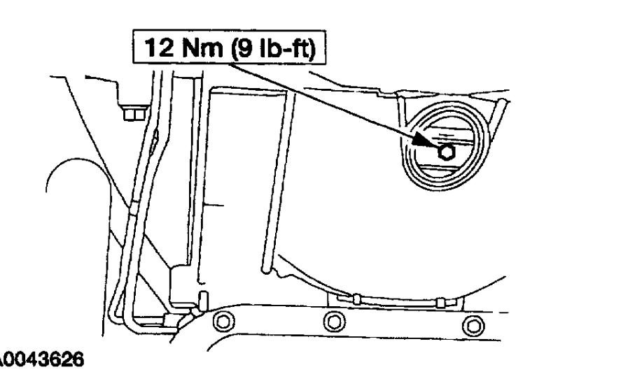

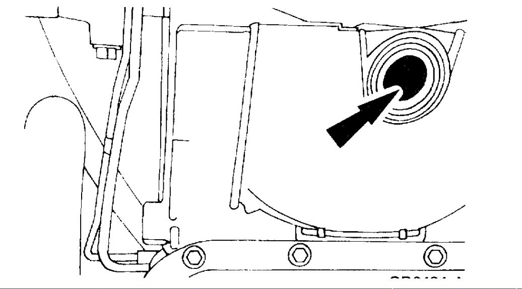

Good morning,
I would start by changing the fluid and filter in the transmission. If the filter is clogged it will cause this exact issue.
Fluid Pan, Gasket and Filter
1. Normal maintenance requires periodic automatic transmission fluid changes. If a major repair, such as a clutch, band, bearing, etc., is required, the automatic transmission will also have to be removed for repair. At this time, the torque converter, transmission cooler and tubes must be thoroughly flushed to remove any dirt. The transmission fluid needs to be changed if evidence of fluid contamination is found. When used under continuous or severe conditions, the transmission and torque converter should be drained and refilled with fluid as specified.
2. CAUTION: Use of a fluid other than specified could result in transmission failure.
Refer to the vehicle certification label affixed to the LH front door lock face panel or door pillar for the transmission code.
3. When filling a dry transmission and torque converter, refer to Specifications for capacity. Check the fluid level.
Removal
1. Disconnect the battery ground cable.
2. Raise and support the vehicle.
3. Place a drain pan under the transmission fluid pan.
4. Drain transmission fluid.
Loosen the transmission fluid pan bolts and allow fluid to drain. After fluid is drained remove the bolts.
5. Remove the (A) transmission fluid pan and (B) transmission fluid pan gasket.
6. Pull down evenly and remove the transmission fluid filter, seal and filter kit.
7. Remove torque converter housing plug.
8. Remove the torque converter drain plug and drain the torque converter.
Rotate the crankshaft to access the drain plug.
9. Clean and inspect the (A) transmission fluid pan, (B)transmission fluid pan gasket and (C) magnet.
