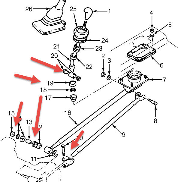

My 98 ford escort manual trans is stuck in third gear. The shifter moves freely and the shifter even goes into other gear positions and sounds like gears are engaging but it is still in third. It was sometimes hard to shift into first or reverse before getting stuck. What could the problem be?
+2
Saturday, June 8th, 2019 AT 11:38 AM (Merged)
HMAC300
  • 48,601 POSTS
It may be internal damage like a broken synchro or fork. Have an assistant try to move gears and check for broken pieces where arrows are or rods not moving.
