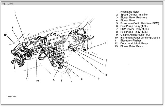

JERZ3455
Hi.
Just recently (two days ago) I experienced the same issue. Started my vehicle. Made it out the driveway and it cut off. Same scenario as Richardgriffin01.
Replaced pump. Old pump was still functional, turns out no power to fuel pump.
Checked IFS. Reset it and reset it again. All fuses are intact. Looked aimlessly for the location of the actual fuel pump relay. On this specific model, it's 'supposed' to be located in the center console underneath the ashtray, but I honestly don't see it.
Can anyone possibly direct me there? Where is it exactly?
Thanks
Saturday, November 23rd, 2019 AT 11:48 AM (Merged)
KEN L
  • MASTER CERTIFIED MECHANIC
  • 42,973 POSTS
Hey Guys,
I found thi diagram showing where the fuel pump relay is located.
Please let us know happens so it will help others.
Best, Ken
+1
