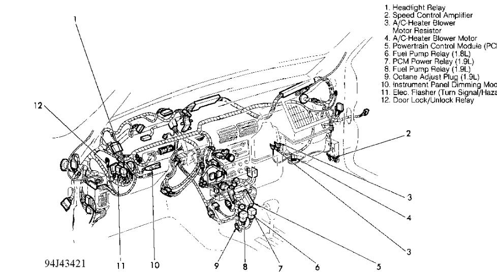

Location of the fuel pump sensor also how do you reset the fuel pump emergency cut of switch
+1
Monday, April 1st, 2019 AT 5:57 PM (Merged)
HMAC300
  • 48,601 POSTS
There is no sensor for fuel pump unless you mean the oil pressure switch. The relay is item 6 or 8 in pic depending on engine.1.9L is 8 the inertia switch shold have a button on top to reset

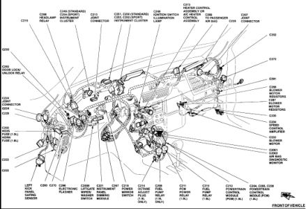

I replaced the fuel pump today, the car is running now but shuts off spontaneously and acts like it is out of fuel still. What else could be the problem? Possibly a filter?
IMPALASS
  • 3,112 POSTS
Hello
Have you checked to see what your fuel pressure is? If you are not getting any then something may be turning your pump off.
You have a fuel pump relay that you can check. . ...I have attached that check for you. Remember that relays are not that much, if there is any doubt after the check, replace it.

I would definitely change the filter.
You also have an inertia fuel shutoff switch. I can provide that data to check also but need to know if you have a hatchback, sedan or wagon.
Next, when it is doing this pull a plug wire and insert something into the end of it and have someone try to start the car and have the metal object really close to a piece of metal on the engine and see if you are getting a good strong popping blue spark. Don't have your hands on any part of the metal!!! If there is no spark, then it is electrical. If you are getting good spark then we need to continue to look towards a fuel problem.
Last, please go to Auto Zone or O'Reilly's and for free they can pull the codes to the car. Most important. Once they check your codes, if they find something and you don't get it fixed and need to get back with us, please make sure you tell us exactly what the code was, number and all. Example, if the code was E0568 O2 Sensor bad. Then make sure you give us all of that. While there for free also they can bring their tester out and check your battery, alternator and starter.
Let me know if you want more based on the above.
