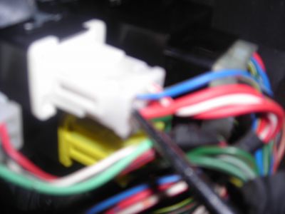

i have power at both of the relays and there is 4 things that go into the relay. I have power on one of the 4. I have no check enginge light when it is on on. and i do not have any power on the octane booster. should i still check the igniton switch? or not?

i did not replace the relays yet but me and my friend pushed around the relays and the check engine light turned on and we tryed to get the relays to click again and we did get them by moving the relays around and we started the car and took it for a drive. My friend than took off the duck tape and we couldnt start it after that. ill change the relays and than if that does not work i will check the wires cause it seems to be a loose wire.

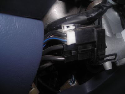

i got the steering colum off but i just do not know what wire it is? ill send you a picture of what i got off and the wires just to tell my which wire i need to test.

if there is a fat blue wire in there check that for 12v when the key is in run position. im at work right now and is hard to get to computer, check all the wires at the switch(good picture) tell me what color wire has power all the time and which wires have power when the key is on. ill be back soon.

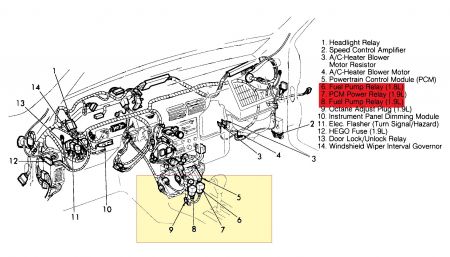

https://images.2carpros.com/forum/automotive_pictures/99387_93_esc_1.jpg

bmr what feed that 15a ignition fuse, he said no power ther with key on, all i found was a blue wire from ignition switch feeding the fuse power but i dont see a blue wire in his picture from the ignition switch

do you know where the wires of the 2 relays go? and do you know where the ground is for those 2 relays?
Mar 10, 2008 at 6:23 PM
BMRFIXIT
  • CAR REPAIR CONTRIBUTOR
  • 19,053 POSTS
i still think that the relays should be changed

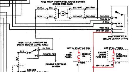

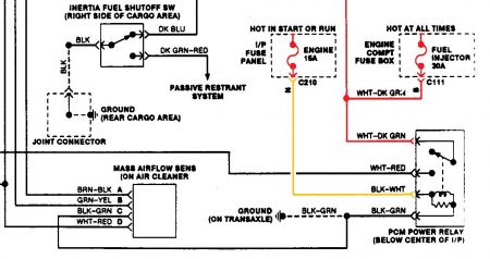

https://images.2carpros.com/forum/automotive_pictures/99387_93es_1.jpg
Mar 10, 2008 at 6:47 PM
BMRFIXIT
  • 19,053 POSTS
At the PCM relay we have
WHT-DK GRN ------------------> hot at all time
WHT -RED ------------------------> ground PCM
BLK-WHT ---------------------------> hot with key on or and start
BLK-GRN -------------------------> GROUND

check these wires bmr has illustrated. what are you missing? tell me. tell me. tell me.
