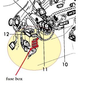

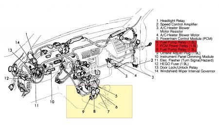

Check them relays and
I think your problem may be electric
I m including the picture and location of the relays you may want to check that
https://www.2carpros.com/forum/automotive_pictures/99387_93_escort_1.jpg
+2
Thursday, March 6th, 2008 AT 5:30 PM

BMRFIXIT
  • 19,053 POSTS
As you see it !
You need to check if you have battery power at the relay or at least they are clicking when key 1st on

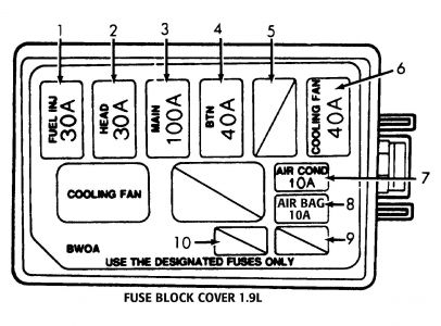

Should start with fuses check them all
https://www.2carpros.com/forum/automotive_pictures/99387_fuse93esc_1.jpg
https://www.2carpros.com/forum/automotive_pictures/99387_93esc_1.jpg

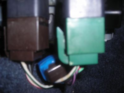

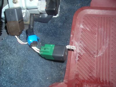

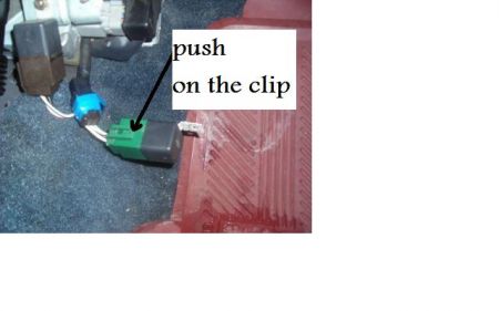

I got to the relays i saw the 2 relays and there was a thing in the middle. i do not know what it is called but it was duck taped and i fooled around with it and i started the car. we took off the duck tape because it was botheing me to see a bad job done on the car and it is not starting now. i will send you a picture of the thing i am talking about.
https://www.2carpros.com/forum/automotive_pictures/164730_DSCN0725_1.jpg
https://www.2carpros.com/forum/automotive_pictures/164730_DSCN0729_2.jpg
-1
Friday, March 7th, 2008 AT 4:52 PM
SEVE12345
  • 30 POSTS
It is the thing with the blue duck tape around it it seems to be loose or something

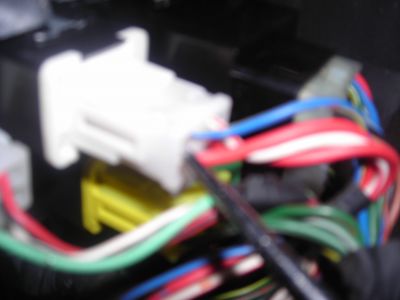

BMRFIXIT
  • 19,053 POSTS
Almost there
check around the general area for a loose and or corroded wire
pull out the relay and check the pins and connector plugs
do the twist and try test
twist the wiring and listen for the relays to click and car to start

Is it supposed to have duck tape around it? And can it be the thing with the blue duck tape around it or is it the wires? How do I pull out the relay to see the pins?
Friday, March 7th, 2008 AT 6:12 PM
BMRFIXIT
  • 19,053 POSTS
At this point I will look for a wiring prob
if the duck tape was on it
some one try to fix something before
try new relay
