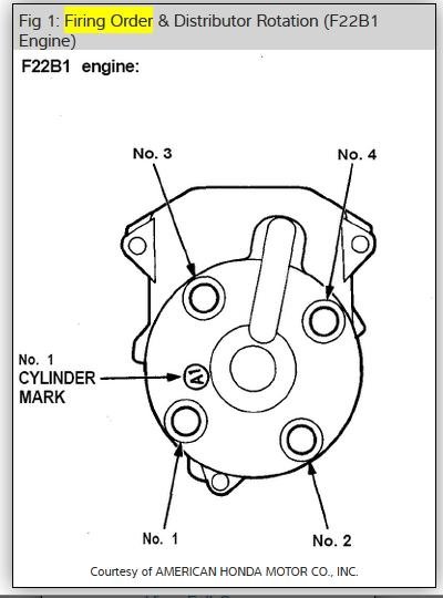

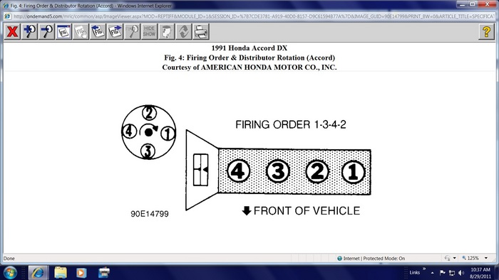

Firing order is 1 3 4 2. See picture for details.

What is the cylinder order for the motor and the distributer firing order for thne spark plug wires

Hi billyhibbs64,
Firing order is 1 - 3 - 4 - 2, from driver side.

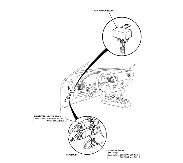

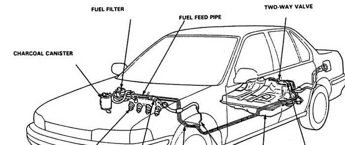

My 1991 honda accord stalled out, got it going again. It stalled again and now it turns over but wont start!Acts like theres no fire or no fuel!
Thursday, December 17th, 2020 AT 8:18 AM (Merged)
JDL
  • 16,098 POSTS
Have a helper crank it while you check for spark at the plugs. If you have spark everywhere, use a gage and check fuel pressure. Any applicable trouble codes? How long since a tune-up?

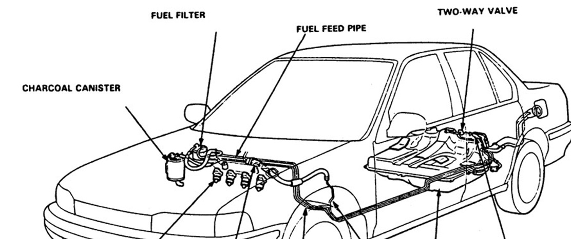

My info shows this for the location of fuel filter. Below.
Relieve fuel pressure first.

Sorry, you asked for relay and I gave you fuel filter.
JDL
  • 16,098 POSTS
The main relay is under driver-side of dash, top relay in picture.
