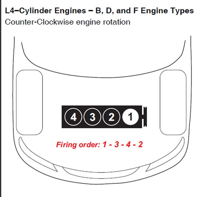

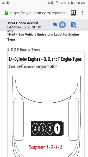

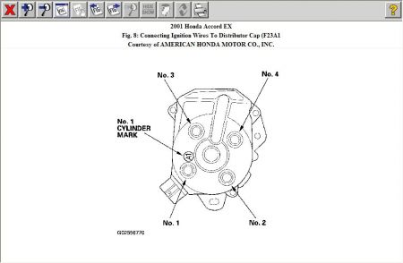

Can I get the firing order [1-3-4-2) with the engine rotation along with a diagram of the spark plug wires on the distributor cap please?
Thanks,
Alex
Apr 23, 2020 at 11:03 AM
  • CAR REPAIR CONTRIBUTOR
I attached the info you requested. Your cap should marked for number 1 and then the others are counterclockwise around the cap.
Take a look at the documents and let me know if you have questions. Thanks

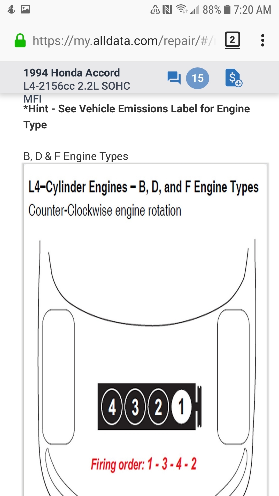

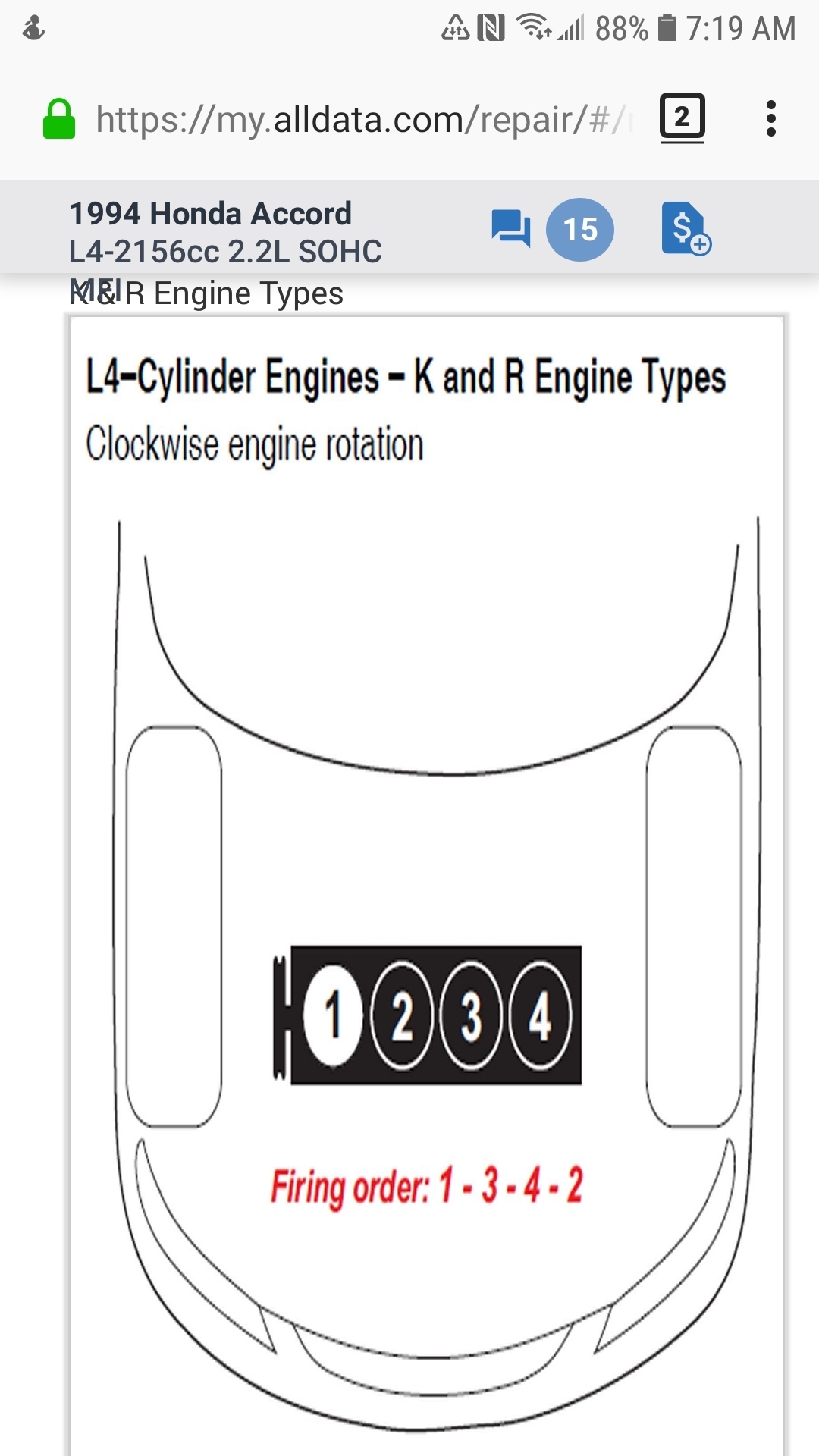

DAN D DIVER
Can I get the engine firing order please?
Dec 17, 2020 at 8:16 AM (Merged)

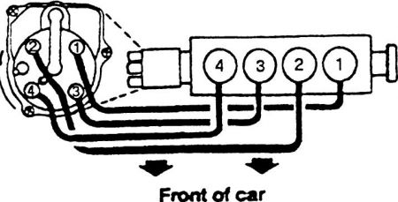

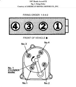

JA_PONTIGO
Engine Performance problem
1997 Honda Accord 4 cyl Front Wheel Drive 140000 miles
I drove the car from FL to VA, when we arrived in VA it was snowing and the next day the car would not start. After a couple of days when the weather got warmer the car turned on. in summer time when it rains it doesn't turn on either until the weather gets dry and the sun comes out. i have changed: Spark plugs, spark plugs wires, distributor, checked if gas was coming in engine and it is, charged battery at advance auto part and battery is fine, changed starter not to long ago but the problem persist. I would like to know what else do you advise me to check because i runned out of ideas of what is wrong with my car.
I also took out the spark plugs cables and did not pay attention of the position of the cables in the distributor cap. could you tell me how to put them back where they belong.
KHLOW2008
  • 41,814 POSTS
Hi ja_pontigo, Here are the diagrams for the firing order.
https://images.2carpros.com/forum/automotive_pictures/192750_FiringOrder97Accord4cylFig01_1.jpg
Check the PGM-FI main relay for the difficult starting.

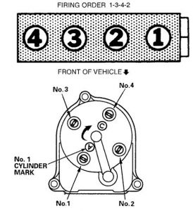

PELLETIERS R US
Four cylinder front wheel drive automatic 17,600 miles. would you please send me a diagram of the firing order from the distributor to the engine? i got mad at my husband and took the wires out and now it is not running properly. so to redeem myself he said i have to find out the firing order.
thank you, Kim P.
Dec 17, 2020 at 8:17 AM (Merged)
  • 75,992 POSTS
Here is the firing order for you engine (below):
https://images.2carpros.com/forum/automotive_pictures/12900_fo_86.jpg

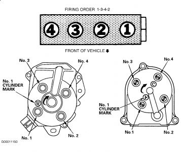

RACEFAN966
  • 5,029 POSTS
It is 1,3,4,2. Here is a picture so you can see the distributor and its rotation as well as the firing order. Let me know if you need any thing else.
https://images.2carpros.com/forum/automotive_pictures/249564_Graphic_129.jpg

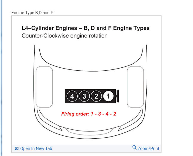

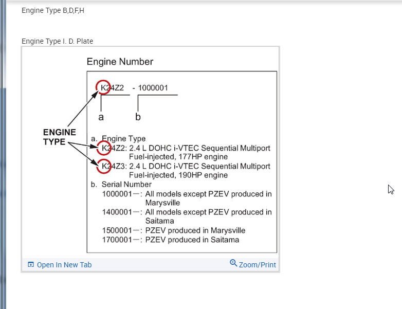

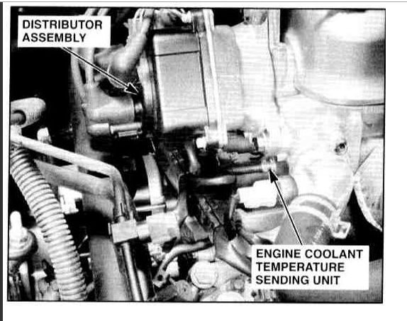

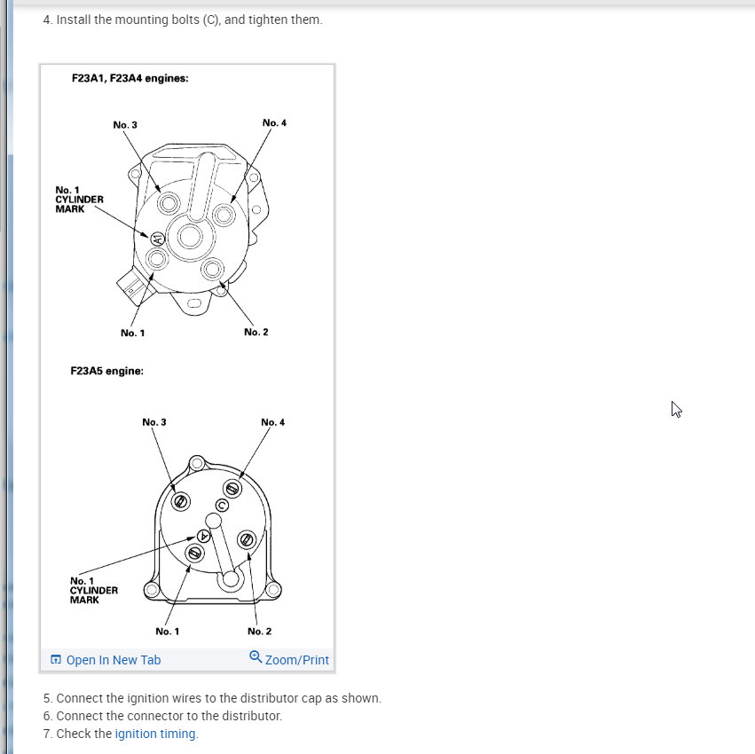

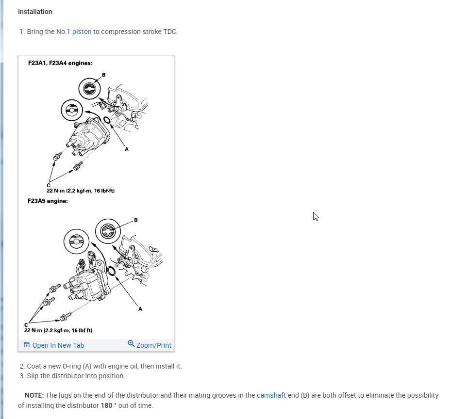

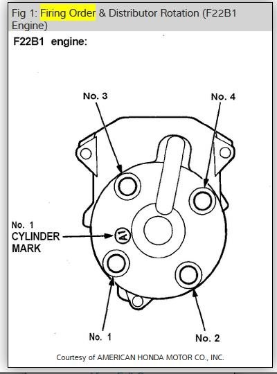

JJONES21
I replaced my distributor and I forgot to diagram the firing order. is there a diagram of the firing order?
HARRY P
  • 2,292 POSTS
Hello and thanks for using 2CarPros. The are two different 2.2L four cylinder engines. VTEC and non-VTECH. I'm attaching the images for both. Check your vehicle emissions label to know which diagram to go by. It should be under the hood somewhere. If not, post the VIN number in this thread and I should be able to look it up for you.
Thanks again for using 2CarPros. Good luck!

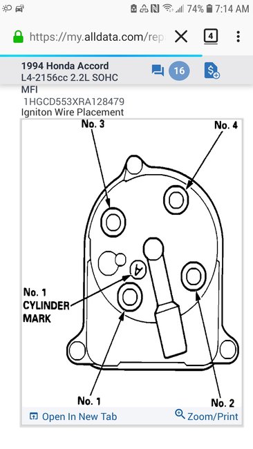

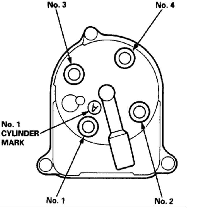

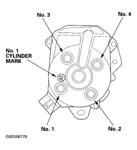

JJONES21
Vin#1HGCD553XRA128479
And do you have the diagram for the distributor?
HARRY P
  • 2,292 POSTS
Here you go. This applies to both the regular 2.2 engine and the VTEC engine. Honda is less than forthcoming about telling me which engine your car has. Anyways, let me know if there's anything else that I can do.

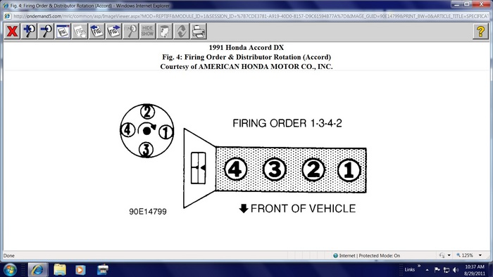

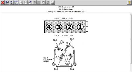

JESSE OWENS
I forgot the firing order for my car it is the LX model and now i hear a misfire. The reason why is due to me replacing my distributor i had carelessly unhooked the ignition wires. Now i go on the web and i cannot even find it.
Dec 17, 2020 at 8:18 AM (Merged)
MHPAUTOS
  • 31,937 POSTS
firing order is 1 3 4 2. See picture for details.
BILLYHIBBS64
what is the cylinder order for the motor and the distributer firing order for thne spark plug wires
KHLOW2008
  • 41,814 POSTS
Hi billyhibbs64,
Firing order is 1 - 3 - 4 - 2 , from driver side.

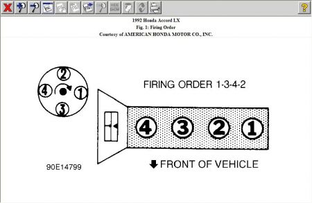

JEANNIE1963
1992 Honda Accord Automatic
Could you please tell me the firing order of an Accord LX, and also, when it idles it seems to speed up and then slow down.
  • 75,992 POSTS
Test your electric air control valve and also see below for the firing order.
https://images.2carpros.com/forum/automotive_pictures/12900_honda_firing_order_1.jpg

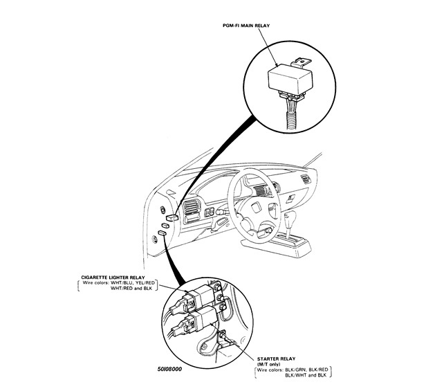

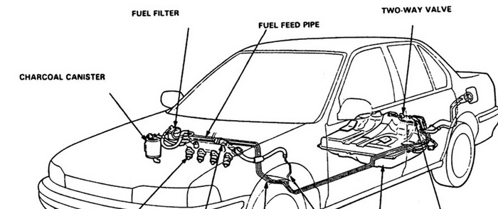

LADYTRUCKER033
my 1991 honda accord stalled out, got it going again. It stalled again and now it turns over but wont start!Acts like theres no fire or no fuel!
JDL
  • 16,098 POSTS
Have a helper crank it while you check for spark at the plugs. If you have spark everywhere, use a gage and check fuel pressure. Any applicable trouble codes? How long since a tune-up?
JDL
  • 16,098 POSTS
My info shows this for the location of fuel filter. below.
Relieve fuel pressure first.
JDL
  • 16,098 POSTS
Sorry, you asked for relay and I gave you fuel filter.
JDL
  • 16,098 POSTS
The main relay is under driver-side of dash, top relay in picture.
