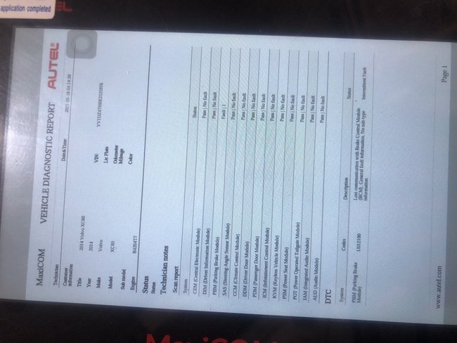

With this mail, here his attachment of the last diagnosis report done by local technicians.
Thanks,
Muhimu
Sunday, August 1st, 2021 AT 9:05 PM
  • 110,194 POSTS

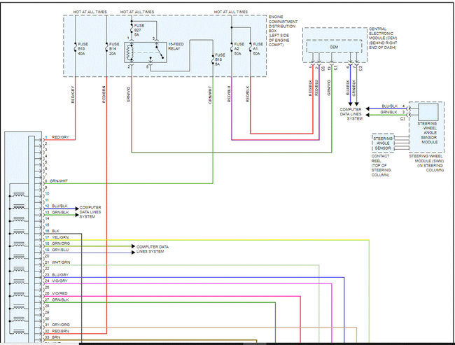

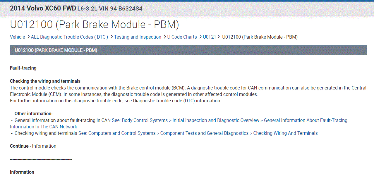

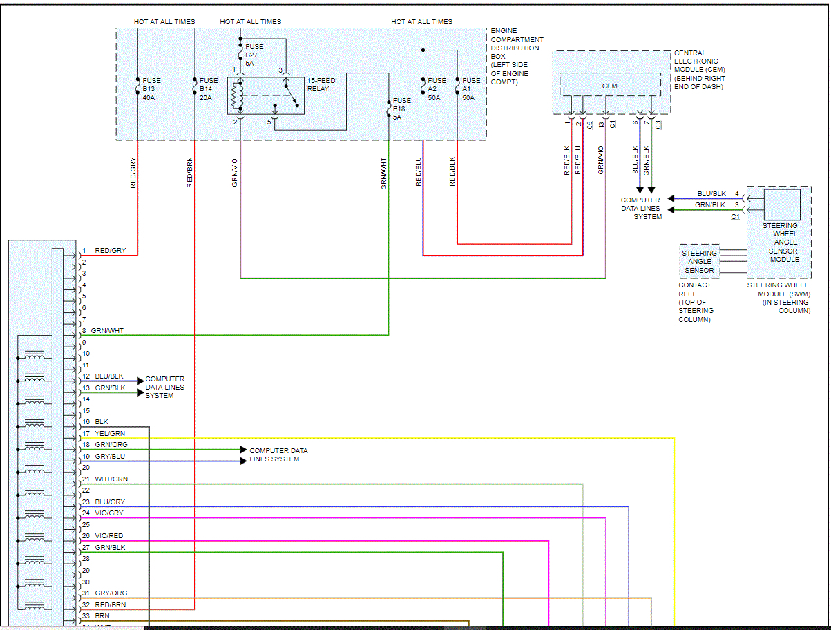

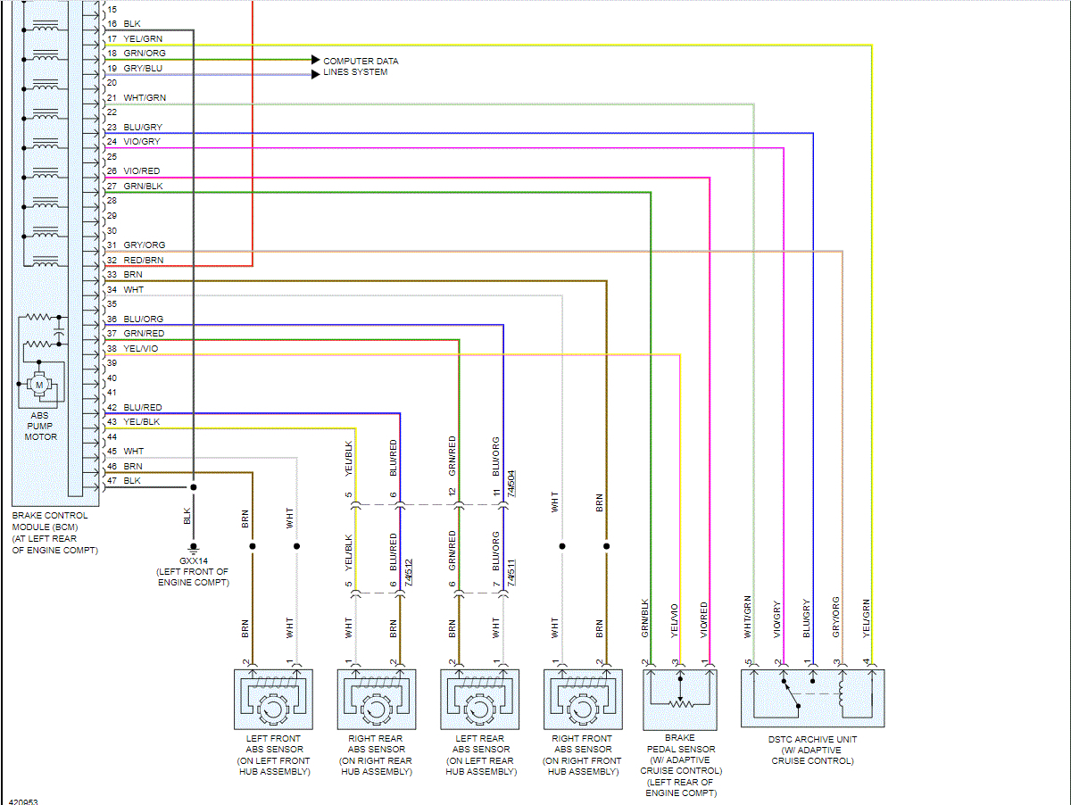

The only fault indicated is the parking brake module. Are you having any issues with it?
As far as the wiring harness, I attached it below. I had to cut the pic in half to make it readable for you. However, I did overlap them so you can follow from one to the next.
Here is a link you may find helpful when testing:

I followed the instructions over video clip and harness wiring as it’s shows below!
1) The speed sensor reading is around 4.560 ohms which is same as left side sensor.
2) We checked the harness cable from sensor holder to BCM by continuity is okay.
3) I even swapped the sensor from left side to right side and the result is the same that the reading on right side But still the sensor doesn’t send any magnetic voltage to BCM.

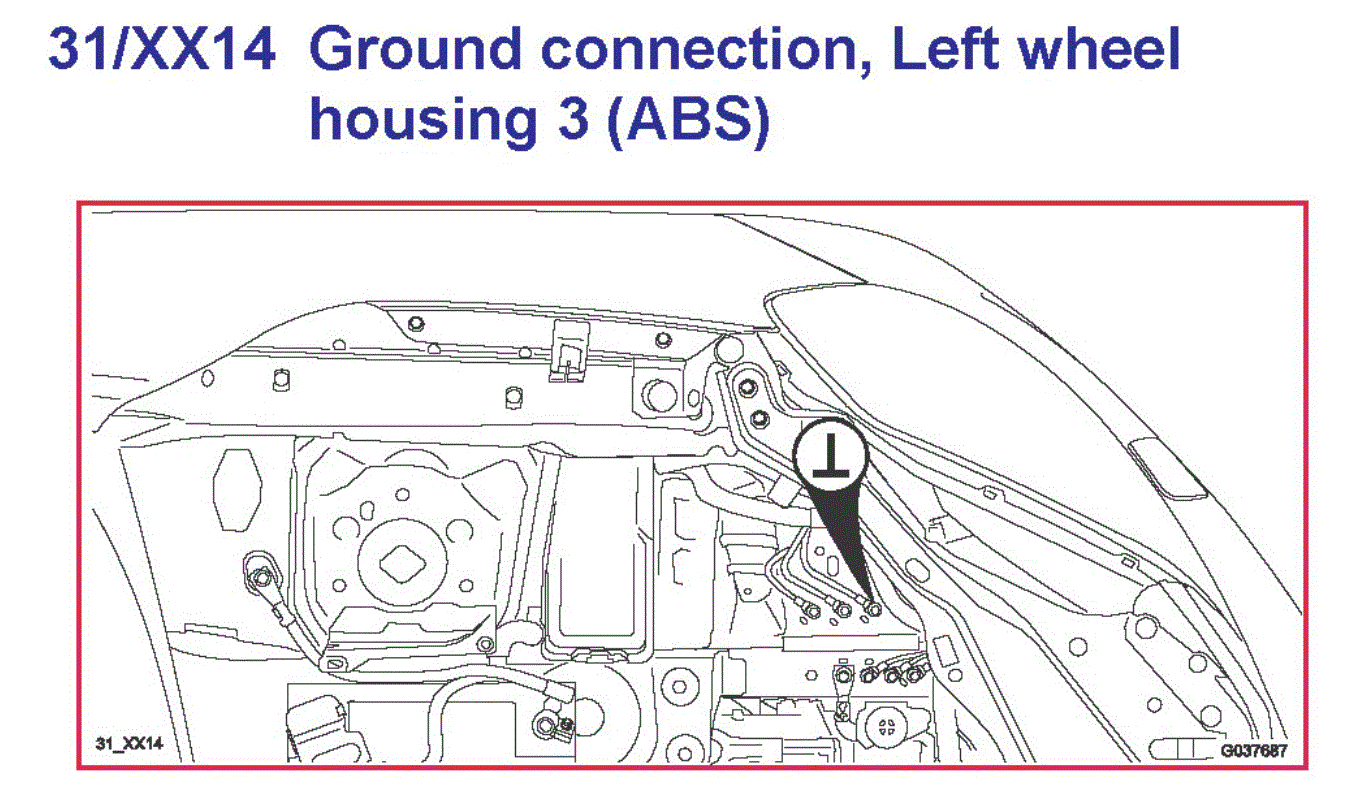

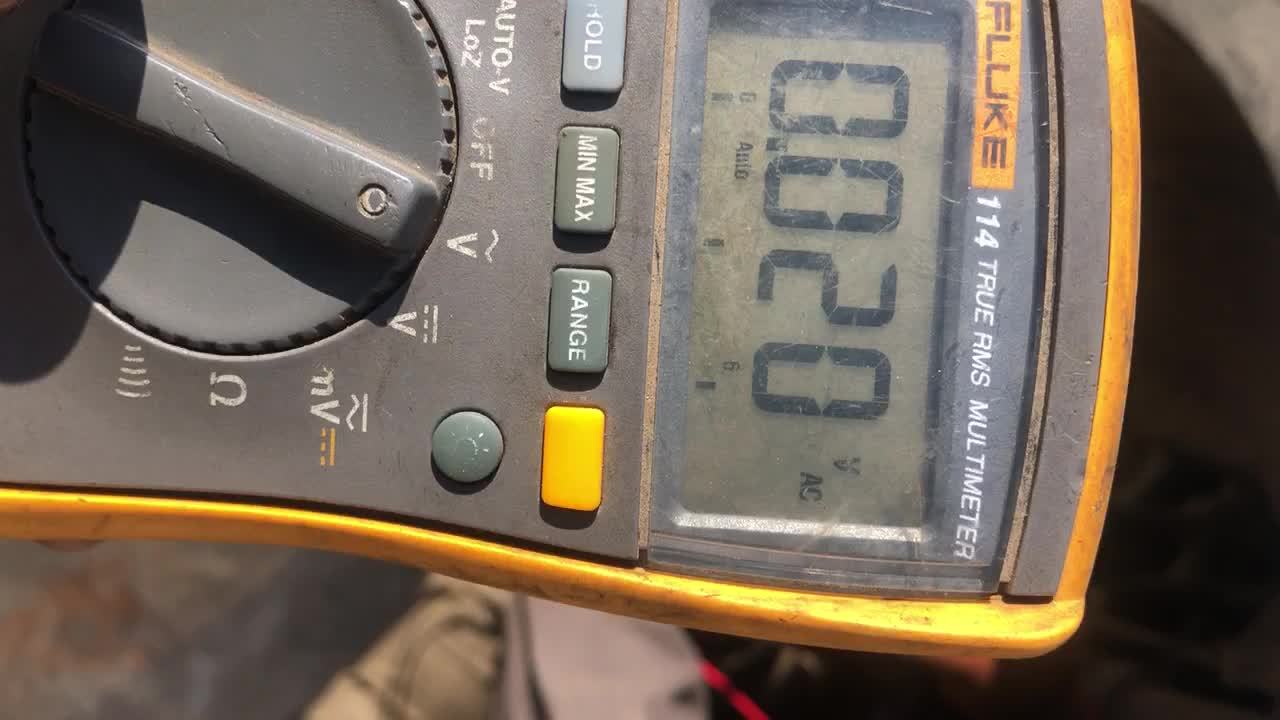

  • 110,194 POSTS
When you checked the sensors at the wheels, did you spin them to see if there is a signal from the sensor?

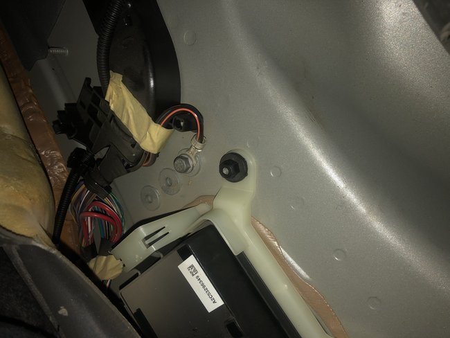

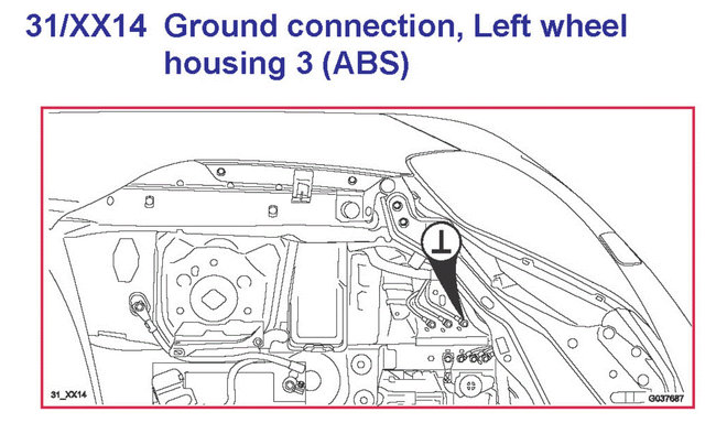

Also, I attached a pic below of the ABS ground. It is located in the left rear wheel housing. It would be a good idea to check that as well.
Let me know if the sensor at the affected wheel is producing voltage when you spin the wheel. The sensor could be good and there could be a problem with the toner ring.

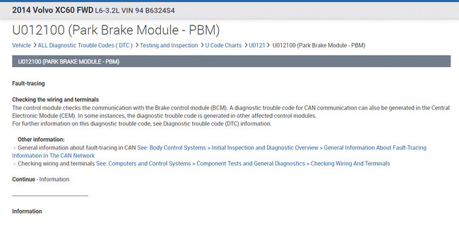

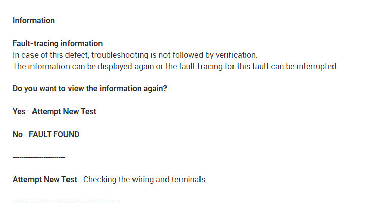

Also, is the U012100 the only code that is still present? I attached the diagnostics below for that code which is related to the parking brake module.

1) Yes I am still getting the same faults code No U012100.

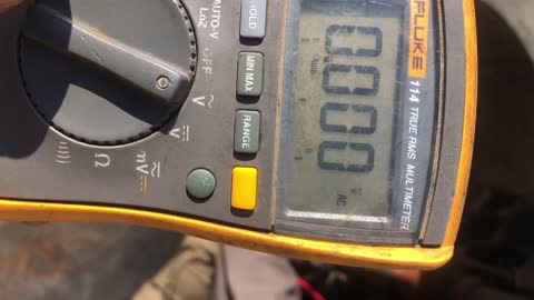

2) I measured the voltage from the right side sensor and no any voltage coming our. Surprisingly the same sensor is giving the voltage when we swapped to the left side 3, 65 mil volts(see the attached picture No 1).
3) I checked the surface of connection of sensor is nice and well clean(see the attached picture No 2).
4) I checked the ground as your instructed but it intact (see the attached picture No3).
So I still suspecting the wheel bearing it might be worn out. Please give your view.

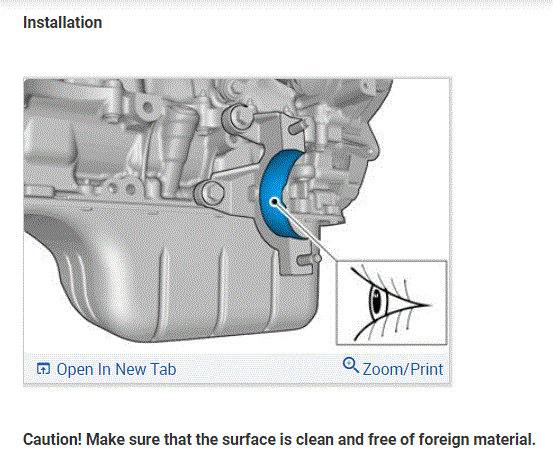

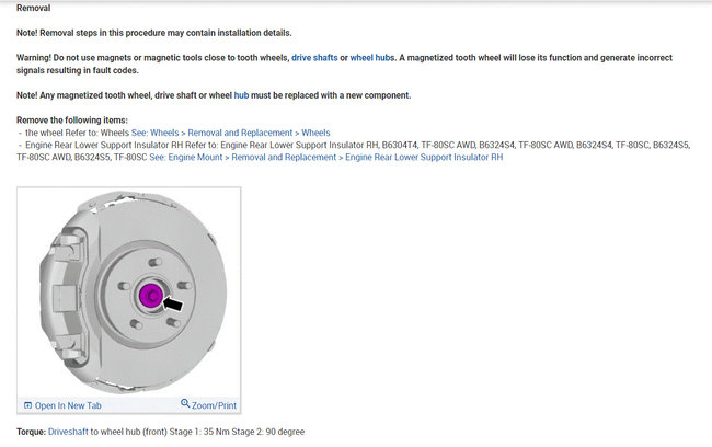

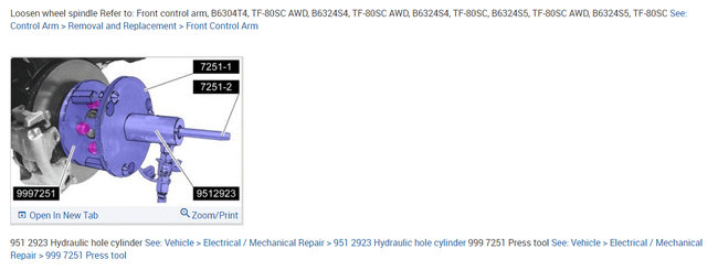

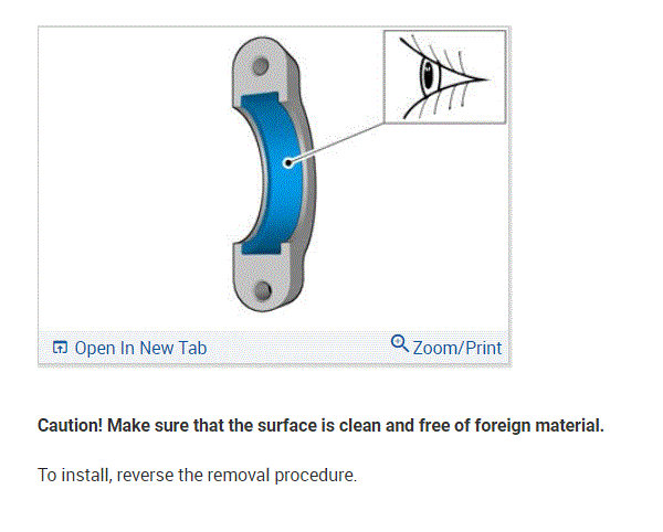

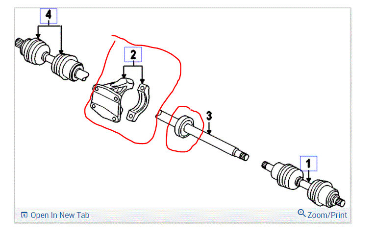

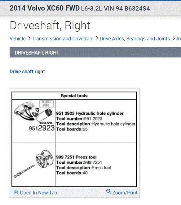

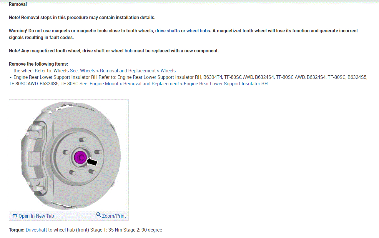

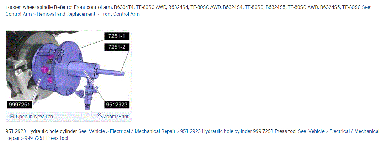

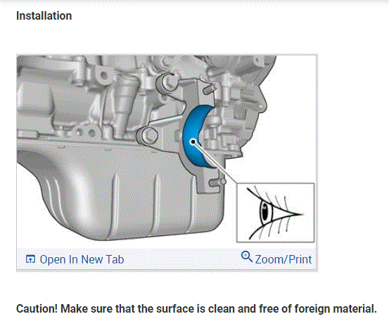

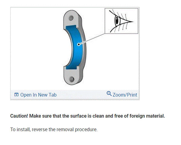

  • 110,194 POSTS

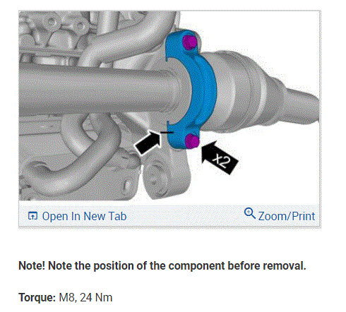

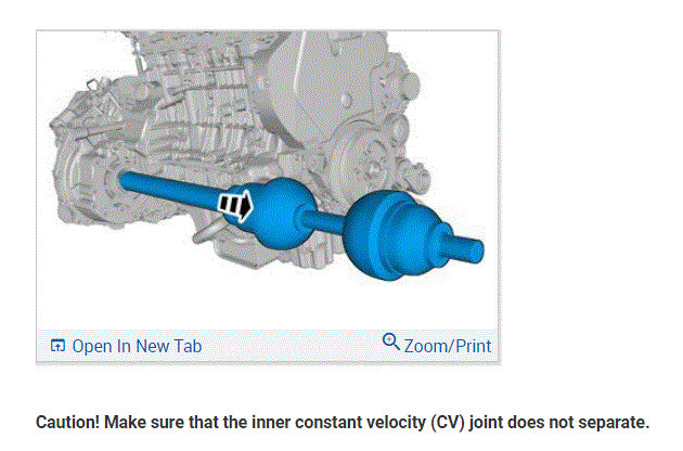

I attached the directions specific to this vehicle. Note that the right axle has a carrier, so make sure to check that as well. See pic 1.
The remaining pics are the directions from the manual. I hope this helps.
Take care and let me know how things turn out for you.

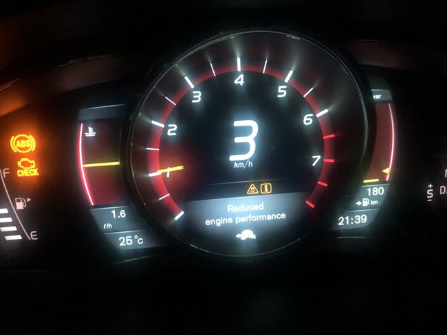

It’s seams the noise comes from drive shaft and I decided to order the new drive shaft both side as well a carrier bearing too. The items could take few weeks due to COVID situation. While I am waiting the price quote, can you also suggest the reliable source of part suppliers?
Also I have one msg coming up says(Reduced engine performance)see attached picture. This just comes whenever you start the car and driver for few distances from 1 to 2 kms. Is this can be related with speed sensor or it’s something else?

  • 110,194 POSTS
The reduced power could be a number of things. In this case, you really need to scan the computer in the manner I mentioned above. Otherwise, it will become a guessing game which usually results in a lot of wasted money.
Now, I'm not sure I understand the other question. Did you already order the parts or waiting to find a supplier? Also, I'm not sure of your location, so I'm not sure what is available for you.

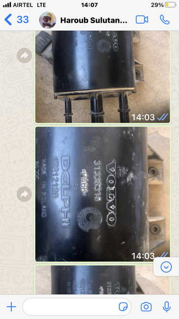

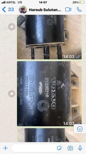

Another thing which come to my mind is the changing the fuel filter, it’s looks my car doesn’t have ordinary filter as seams comes with something calls canister filter (see attached picture). Is this replaceable?
Is the factional as fuel filter? Please help.
Concerning my location, I am in Tanzania (East African) and the nearest parts source is South Africa or online ordering.

  • 110,194 POSTS
A canister filter is replaceable. Take a look through this link. It explains how it's done.
https://www.2carpros.com/articles/how-to-change-a-fuel-filter
