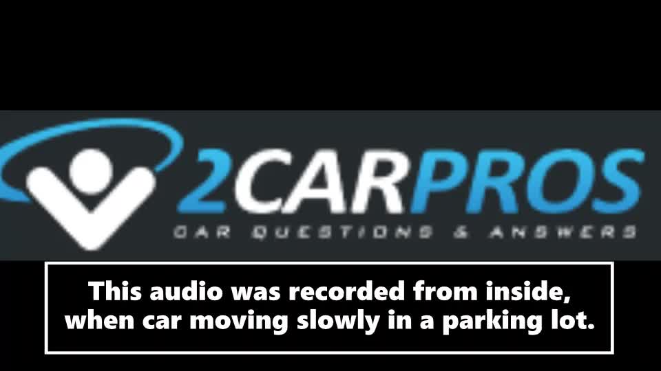

Used an online tool and created a video from the audio file and a photo that this website will allow uploading. Here is the audio:

I got it. I hear a bearing noise which is most likely the pump. My belief is the pump is causing the belt issue. Other than the bad bearing noise that I'm hearing, I can't hear anything from the belt itself, but suspect it the pump is causing the problem.

That squeaking noise that sounds like rubber or plastic rubbing that starts from the tenth second of the video is the new noise I am talking about. It does not seem like bearing noise to me. Can you please listen to it again and let me know?

Below is another audio. I am concerned about the squeaking and banging noise that starts after seven seconds on the video and lasts until the end of the video. This is a new noise that recently started besides the constant rattle of the power steering pulley. The noise starts when the engine is restarted and the car starts moving. The noise kind of goes away (but not all the way) after a few minutes. The car drives okay even with this new rubber ducky squeaking noise. What is causing this new squeak and thud noise?

I hear it for sure. Without being there, I can't say with 100% certainty. However, it does sound like one of the belt driven accessories. You should remove the belt and check all of the belt driven accessories. If the pump is bad, it should be replaced. It may be making all the noises you hear. Honestly, it wouldn't surprise me. You may be hearing the belt moving on the pulley causing a squeak. As the pump gets worse, sound will most likely change again.

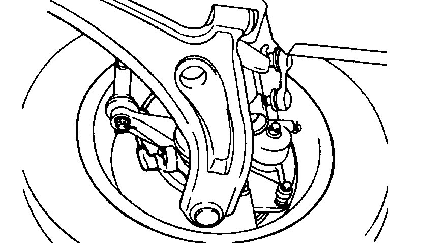

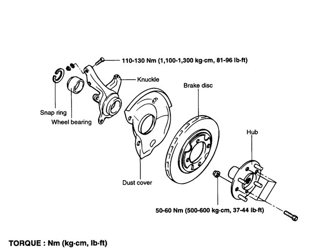

I reached out to you earlier regarding this but never had a chance to fix the issue. My old Hyundai is making loud grinding noise when moving. For the last couple of years there a rumbling noise when moving and the wheel bearing and ball-joint were replaced last year. But the rumbling noise never went away. It is a rumbling, crumbling and very loud grinding noise now. Tested wheel today, no sideways or up and down play at 3 and 9 O'clock and 6 and 12 O'clock. Dust shield is not scraping. The ball-joints and rubber boots look okay. Brake pads are one year old. The slight rattling and ticking noise when the car starts is a power steering pump noise which is very different than the rumbling grinding noise that I am trying to diagnose. Over the winter months there a squeaky rubber-ducky type noise which is gone now. The car has been making this grinding noise for six months now and it runs fine otherwise. Is it the strut bearing or the joints, worn out rubber or something else making the grinding noise? Advanced thanks for your help. I uploaded a video on YouTube regarding this issue. Here is the link:

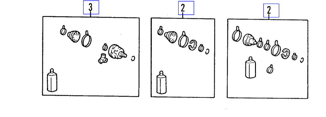

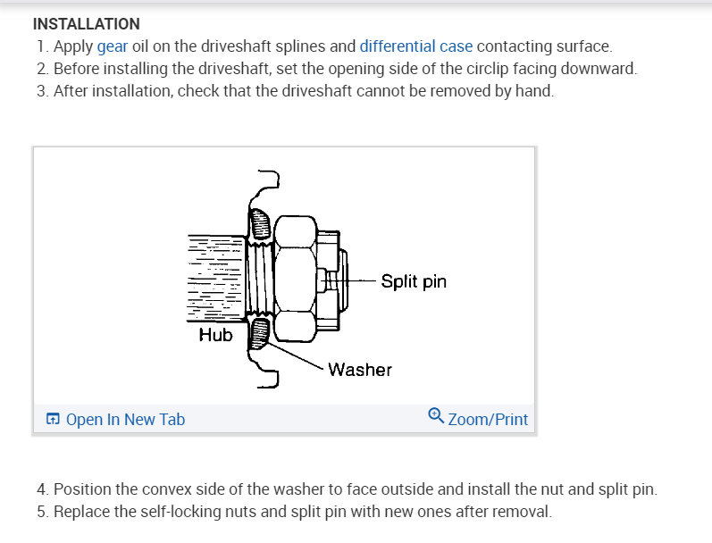

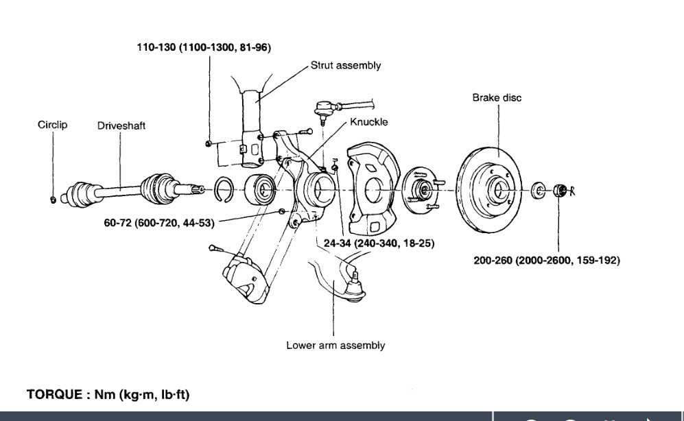

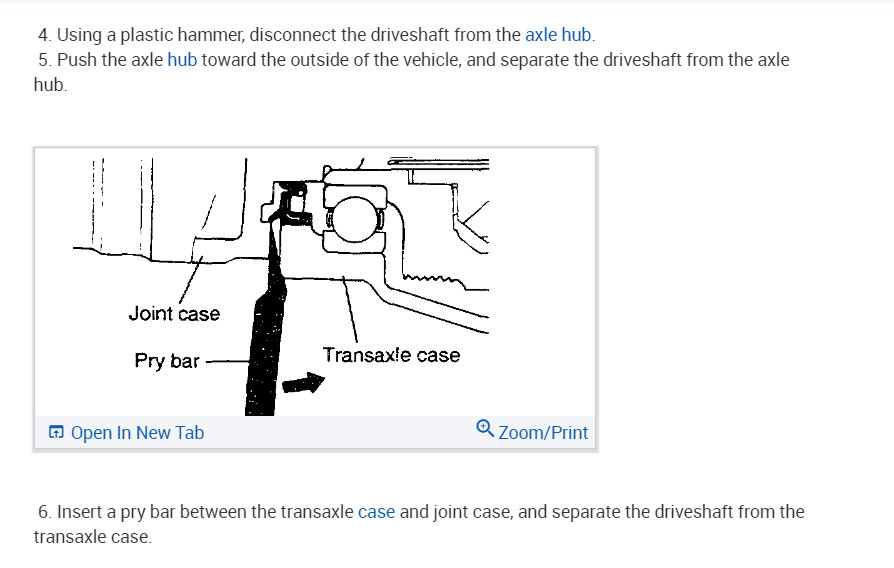

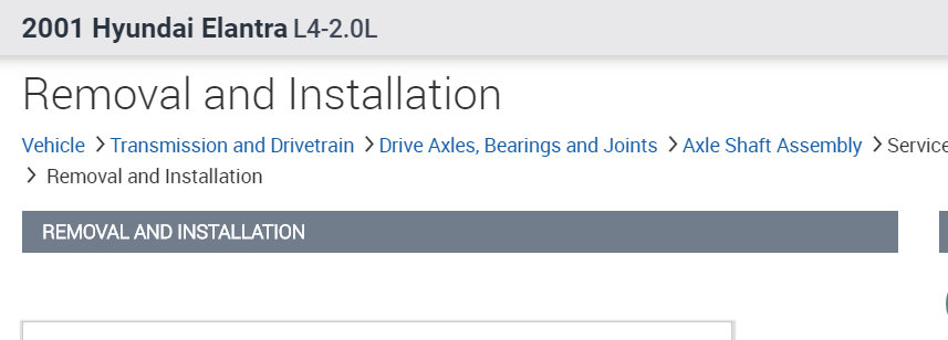

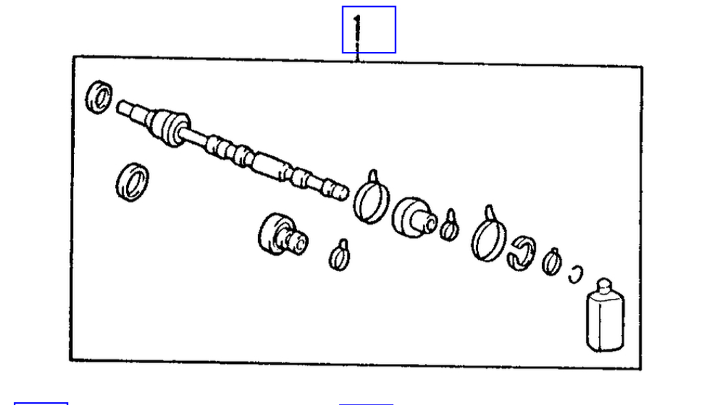

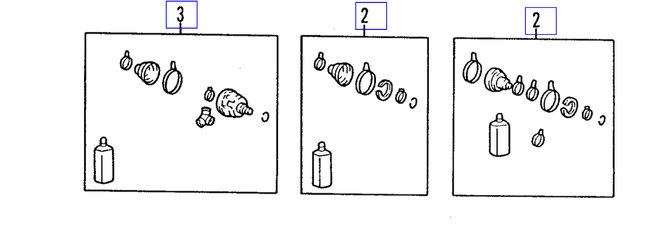

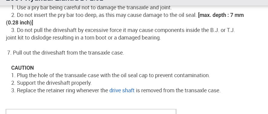

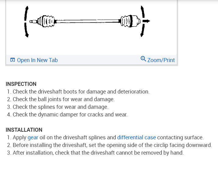

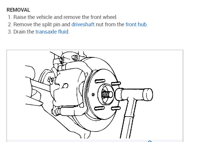

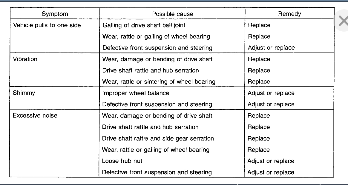

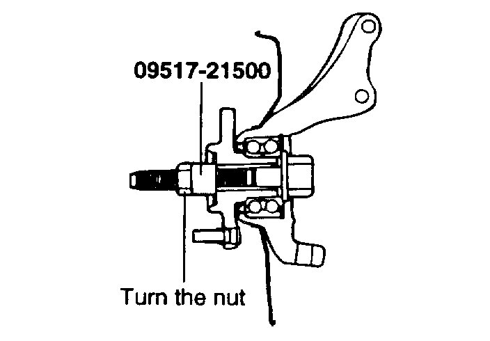

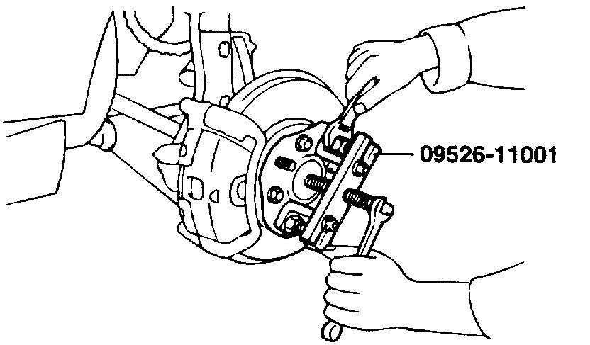

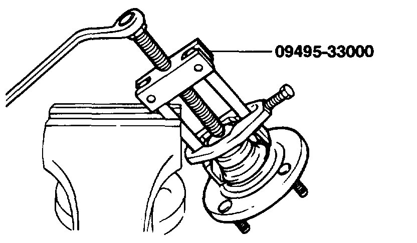

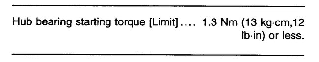

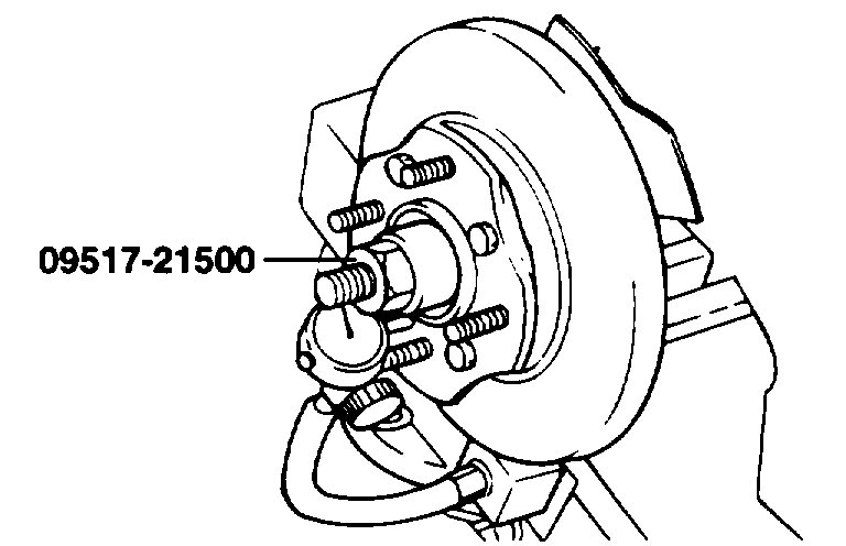

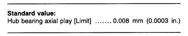

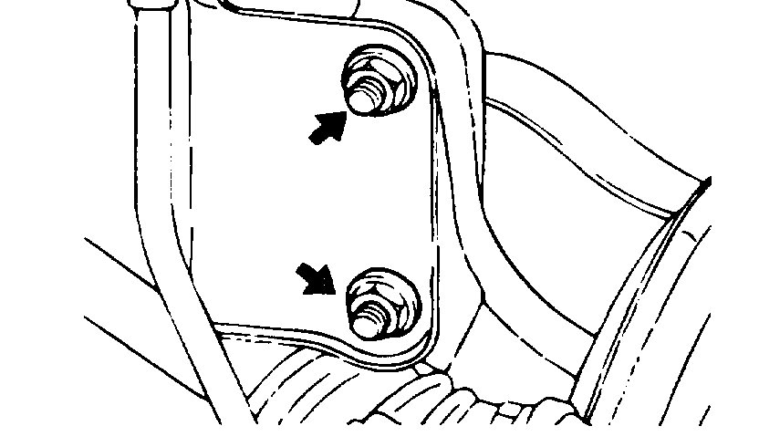

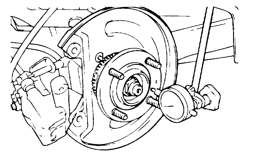

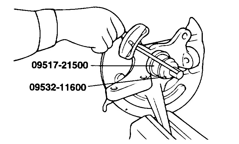

Just a quick question. Did someone driving this vehicle run over a curb or go to fast over a high speed bump or something like that? Okay, now on to the problem. This sounds to me like you have a Constant Velocity Joint(s)(CV Joint)(s) that are going out on this vehicle. From what I can on the video the rubber ducky noise sounds like a popping noise when you are going around corners. This is what a CV joint that is going out will sound like. Anyway, in the diagrams down below I have included a trans axle diagnostic chart for what the problem is when this noise is present, and an exploded view of the trans axle assembly, as well as removal and installation instructions for the CV joint. Please go through the guides and get back to us with what you are able to find out.
Thanks,
Alex
