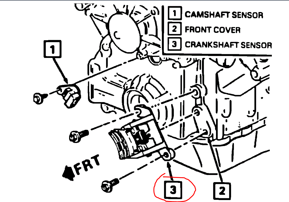

Car will turn over but will not start or get spark
MONSTERMARX36
  • 1988 OLDSMOBILE DELTA 88
  • V6
  • 18,000 MILES
Ran fine before I turned it off. It shows the amp and temperature on the gauges.
Thursday, March 26th, 2020 AT 8:34 AM
  • 110,192 POSTS
It could be a few things. If the crankshaft position sensor failed, it will cause a no spark condition. Take a look at pic 1. It shows the sensor I mentioned. However, before we jump the gun and start replacing parts, we need to do a couple things.

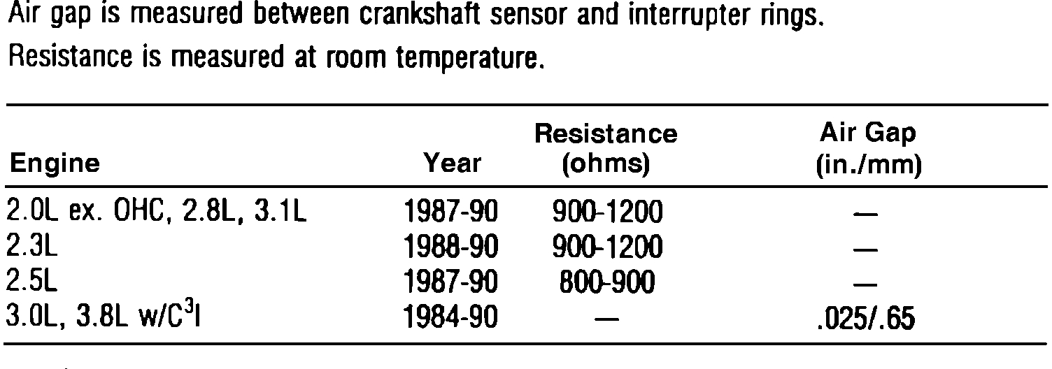

If a code shows it could be the sensor, pic two shows the resistance you should find when checking it.
