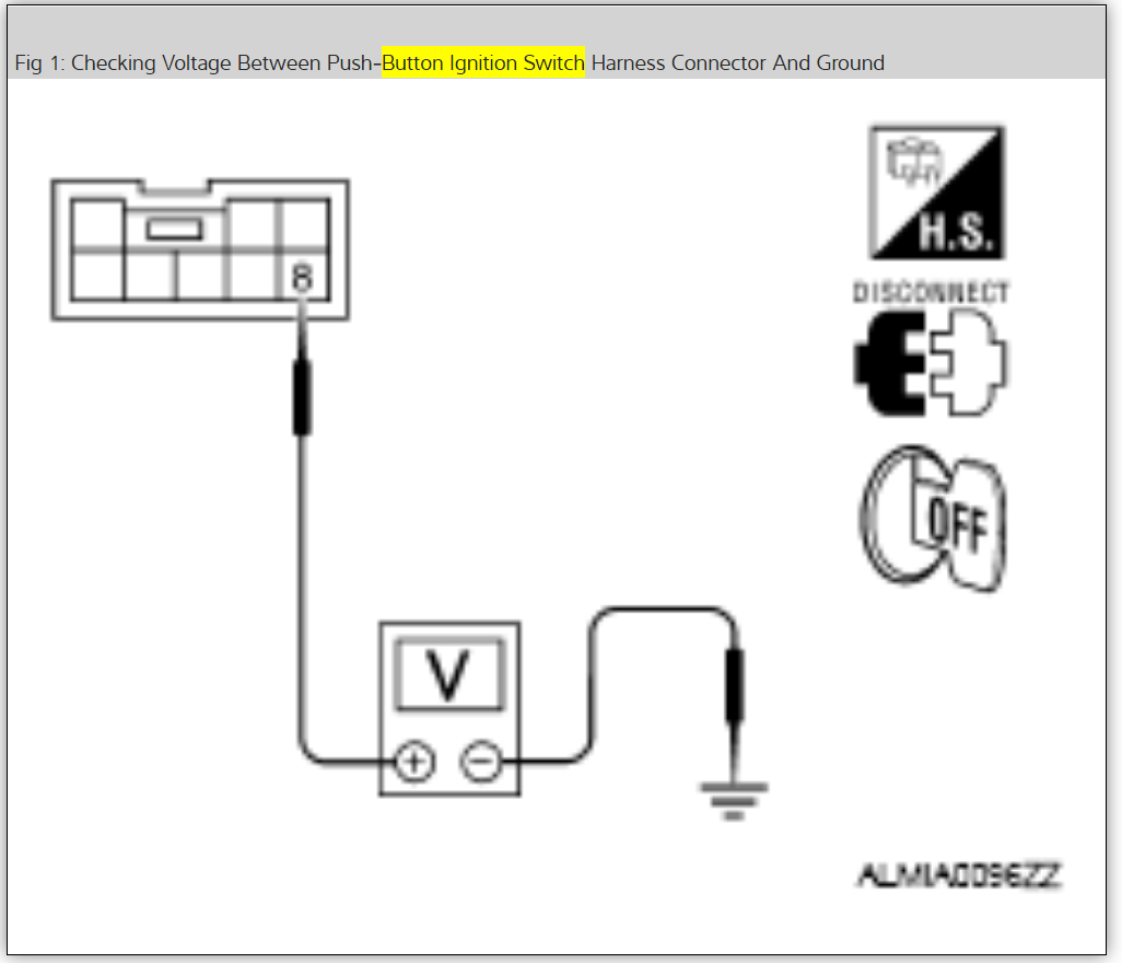

Would not start at all it just clicked
DONSTAFFORD
  • 2008 NISSAN ALTIMA
  • 2.5L
  • 4 CYL
  • 2WD
  • 174,894 MILES

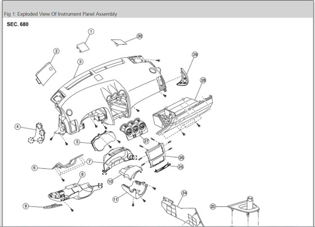

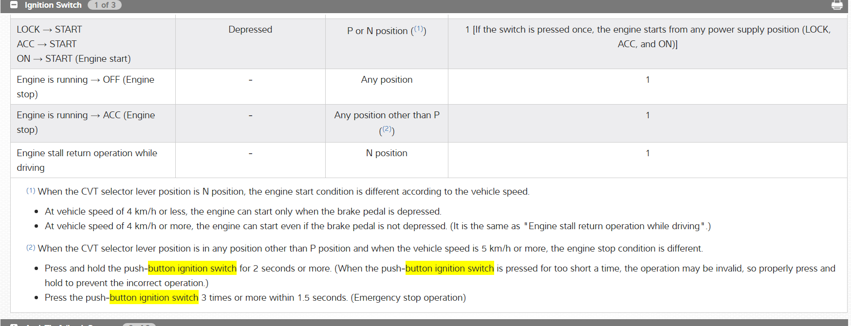

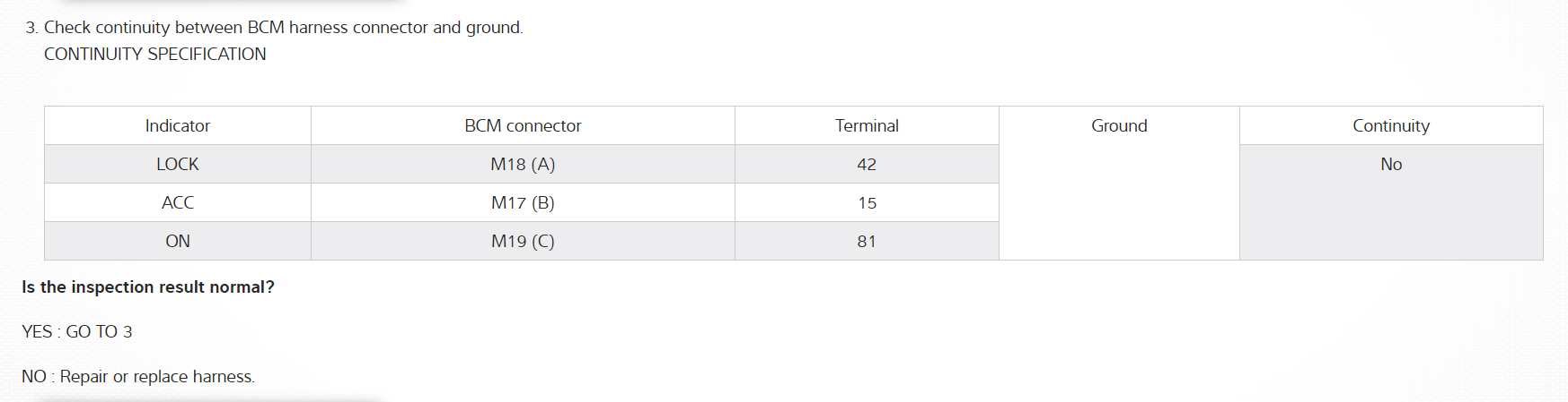

Everything has been fine with my car until about a two weeks ago when it failed to start on my way home with groceries and just kept hitting the button until it did start (weakly too). The next day it would not start at all it just clicked. So I thought the starter locked up but I I removed that had it tested and got a new battery and neither fixed it. I then noticed a little key/locked car logo on the left side of the instrument cluster inside the rpm gauge. Changed key fobs and batteries in them also done nothing. The steering wheel will not lock either. Every time I try to start it just does nothing acc power and everything kicks on but no start.
Friday, March 1st, 2019 AT 6:00 PM
SCGRANTURISMO
  • 4,897 POSTS

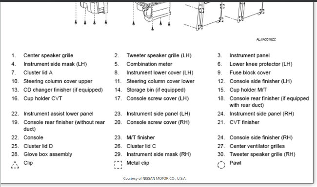

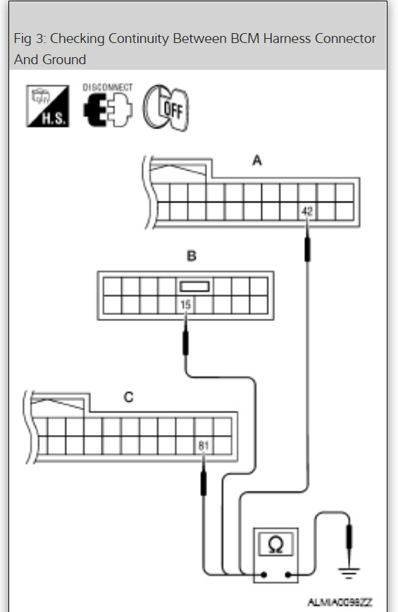

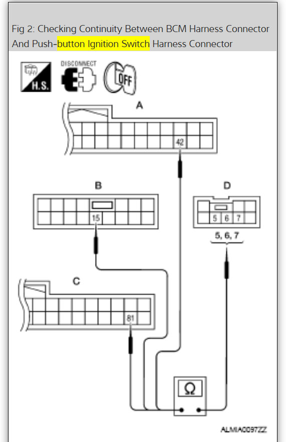

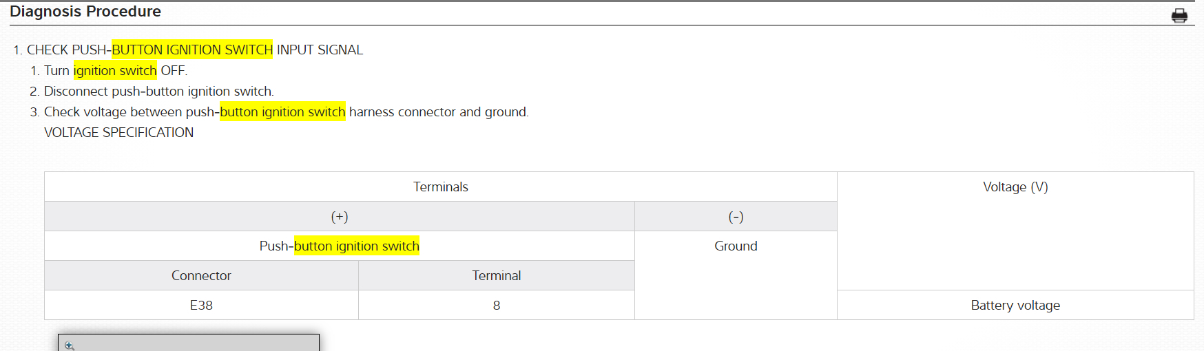

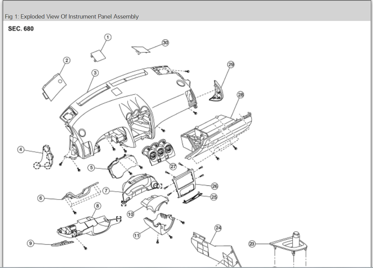

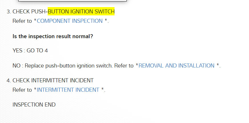

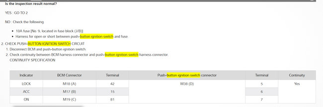

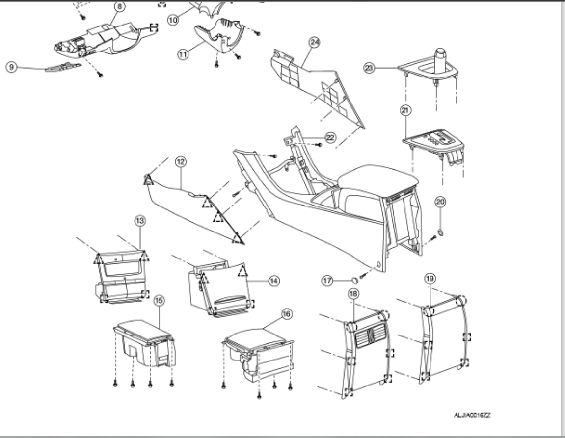

This could be a loose or corroded connection to the bush button switch. I have included for you in the diagrams below a step by step troubleshooting flowchart for you to go through. Please get back to us with what you find out.
