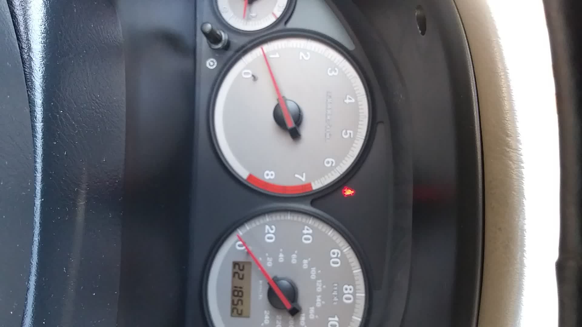

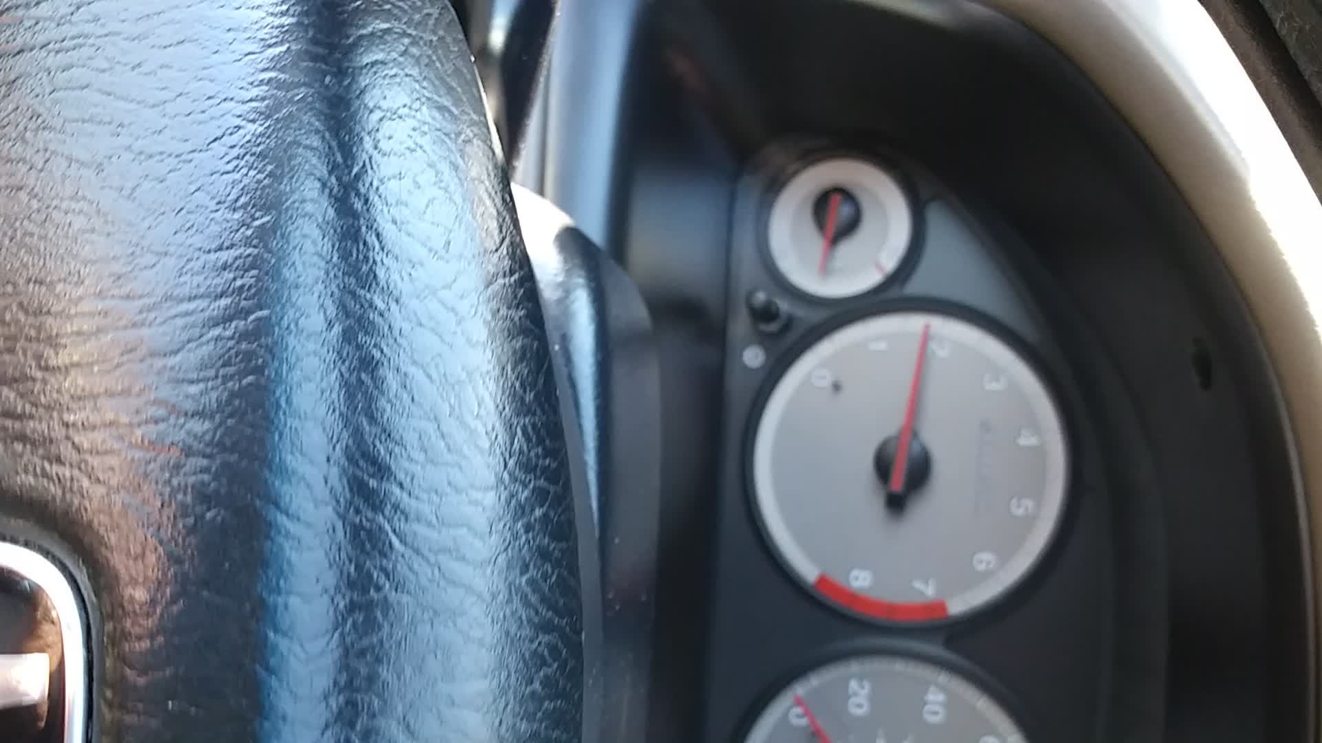

I worked on my car and a week after I got done I got this code p1505 said PCV valve air leakage. I know there is no vacuum leak anywhere. So I bled the cooling system and while doing that the light went off. A week after that the light came on again with the same code and bled it again but this time it is still on and it made my idling abnormal. My IACV is new and throttle body is clean also. So I don't know what's the problem.

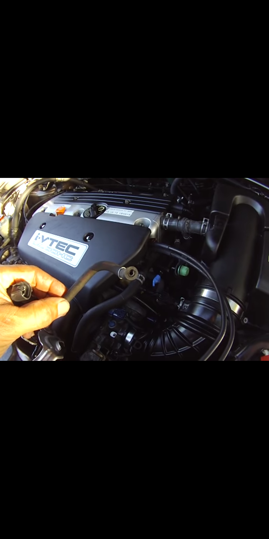

Okay, so today I squeezed the brake booster hose with a pliers and it didn't make any difference, I move the air cleaner box from over the throttle body and cover the throttle body with my hand and it stalled out the car also, I pinch the PCV valve with the pliers too and the car stalled as well. I let the car idle until the van comes on twice, I raised the front of the car and removed the radiator cap and installed a spill free funnel and add coolant to it to bleed the system, there were air still trapped in it, but I think I got it out or most of it I should say. I even pull the ECU fuse before I leave work so while the car was idling before I add the coolant, it should doing the relearning process.

If you look closely you can see that green cap beside the intake hose, it has something to do with the evap system. It came off while working on the car and I couldn't find it no matter how and where I look. I drove the car a day I think without that cap so I don't know if it would induce air in the system and causing rpm issue, let me know what you think.

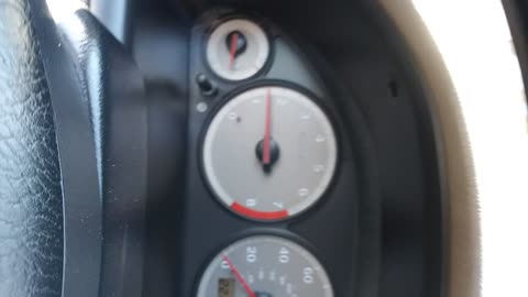

So I just did a test. First I pinch the purge valve and it didn't make any difference, I pinch the PCV hose again and it drop the RPM's. Now I test all three together; the PCV hose, the brake booster hose and I unplugged the IACV while squeezing the PCV and purge valve hose and the engine RPM's drop lower than it was idling but not to stall it though. I unplugged the IACV and the RPM's raised higher.

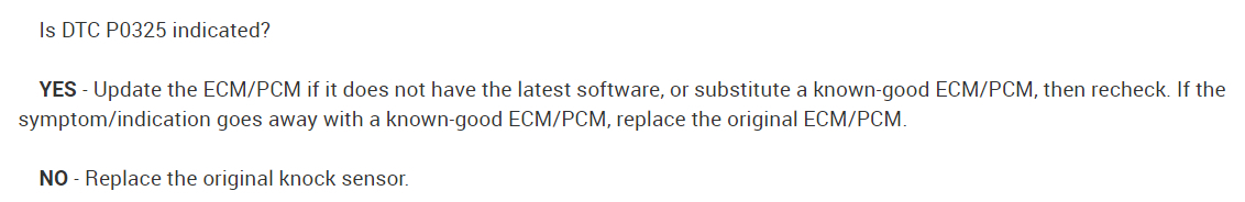

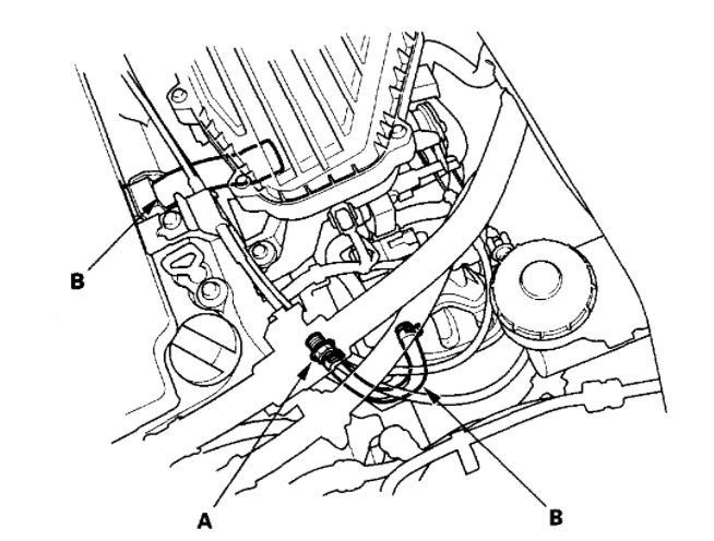

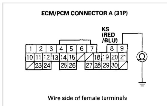

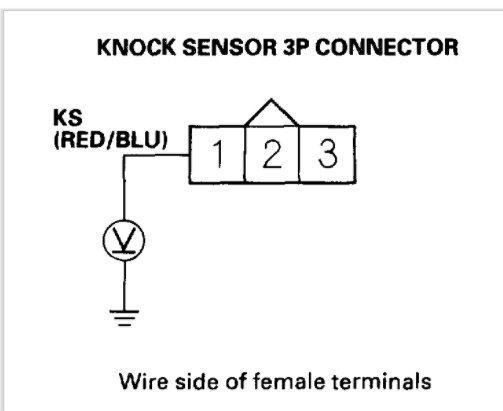

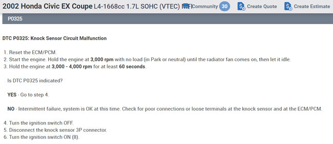

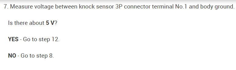

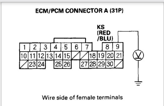

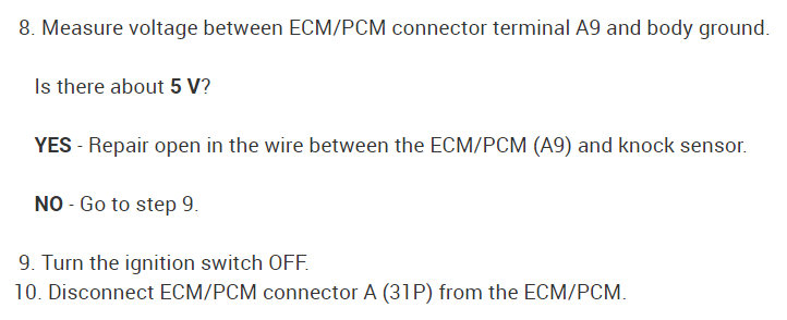

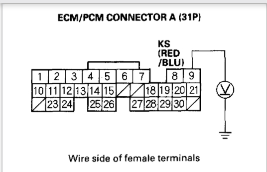

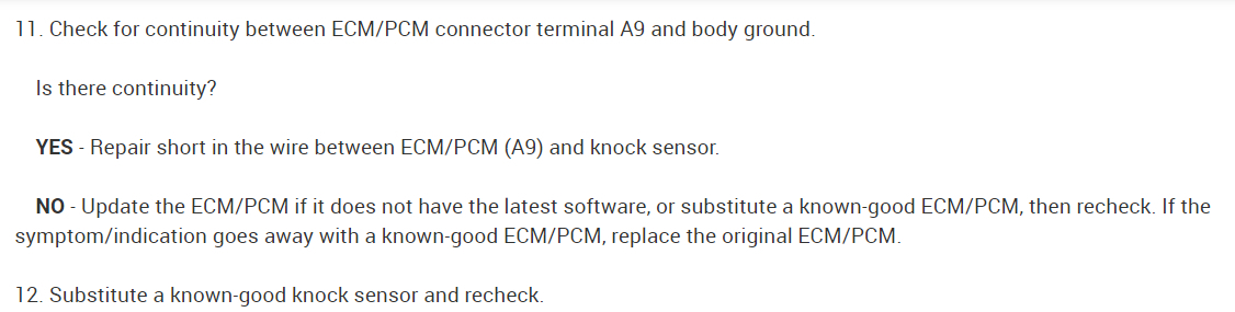

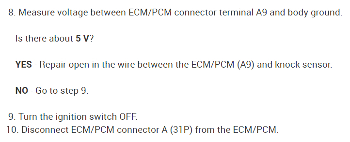

The green cap is the service port for the evaporative system. It will not introduce any air into the system. I'm more concerned with the code P0325 knock sensor issue. That would also cause your car to run terribly and shake. Here is a tutorial showing how to test electrical wiring:
I've attached picture steps below on how to diagnose code P0325. Let us know what you find and we'll go from there. Hope this helps and thanks again for using 2CarPros.
Wednesday, January 6th, 2021 AT 9:16 PM

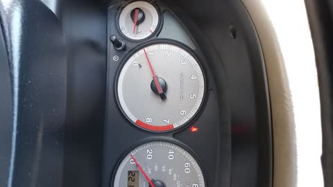

Thank you. I haven't seen any more of the p0325 or p1505 code but I'm still having the idle issues even after I did another relearn process and bled the cooling system again this morning which I was still getting air bubbles. I don't have any of the professional tool that is use to check for vacuum leaks but I use brake part cleaning and didn't see any changes. I replaced the throttle body with one from the junkyard with all stock IACV and TPS sensor on it and still did a relearn but problem remains the same. I have one of my exhaust (manifold/heat shield bold) that threaded out, the top left one to be exact, so the bolt not tighten up that top left side that well. Could that cause the car to idle like that?

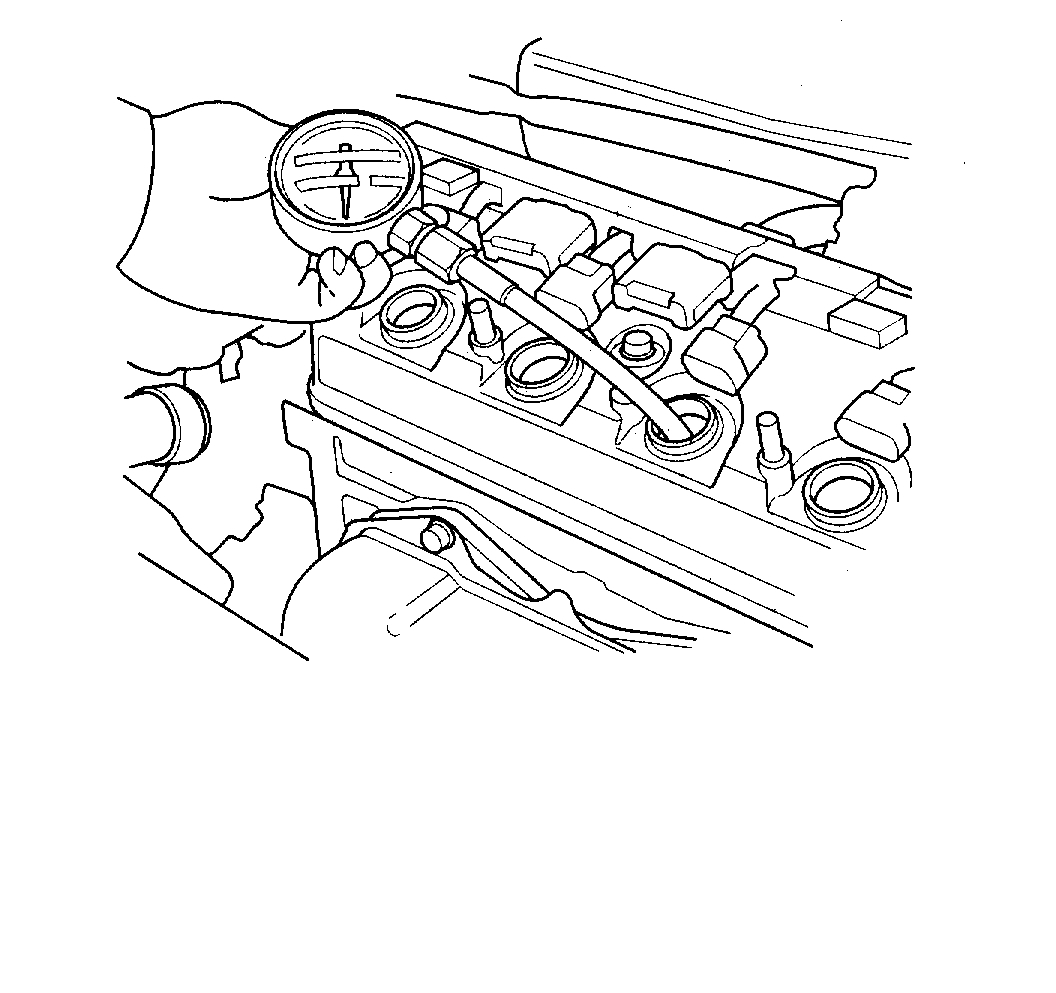

If the PCV is good and all the mentioned things we discusses, the lights are off, and no leaks have been found, Based on the mileage, you may have low compression on all or one cylinder.
First, take a look through this link:
https://www.2carpros.com/articles/symptoms-of-low-compression
Here is a link that shows in general how compression is tested.
Here are the directions specific to your vehicle:
_____________________________________________
2002 Honda Civic DX Sedan L4-1668cc 1.7L SOHC MFI
Component Tests and General Diagnostics
Vehicle Powertrain Management Tune-up and Engine Performance Checks Compression Check Testing and Inspection Component Tests and General Diagnostics
COMPONENT TESTS AND GENERAL DIAGNOSTICS
Engine Compression Inspection
1. Warm up the engine to normal operating temperature (cooling fan comes on).
2. Turn the ignition switch OFF.
3. Remove the air cleaner housing.
4. Disconnect all four injector connectors.
5. Remove the four ignition coils.
6. Remove the four spark plugs.
pic 1
7. Attach the compression gauge to the spark plug hole.
8. Connect a tachometer.
9. Open the throttle fully, then crank the engine with the starter motor and measure the compression.
Compression Pressure:
Above 930 kPa (9.5 kgf/cm2, 135 psi)
10. Measure the compression on the remaining cylinders.
Maximum variation:
Within 200 kPa (2.0 kgf/cm2, 28 psi)
11. If the compression is not within specifications, check the following items, then re-measure the compression.
Damaged or worn valves and seats
Damaged cylinder head gasket
Damaged or worn piston rings
Damaged or worn piston and cylinder bore
Check this and let us know what you find.
