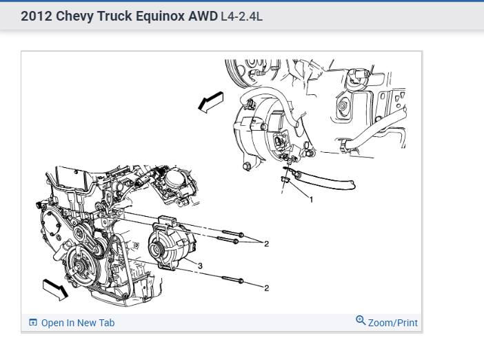

If the voltage continues to drop while the engine is running, the alternator isn't charging the battery. We need to remove the alternator. Once that is done, take it to a parts store and ask them to bench-test it. If it fails, replace it.

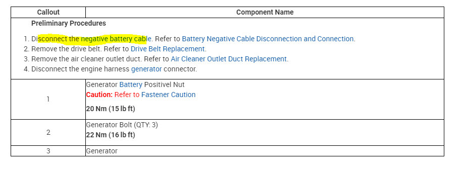

I attached directions below specific to your vehicle. Take a look through them and let me know if you are comfortable doing it. Note: Make sure you have the battery disconnected before you start working on the alternator.

I had already taken the alternator to the parts store and it checked out good. I think the problem is my battery charging system, how can we fix that?

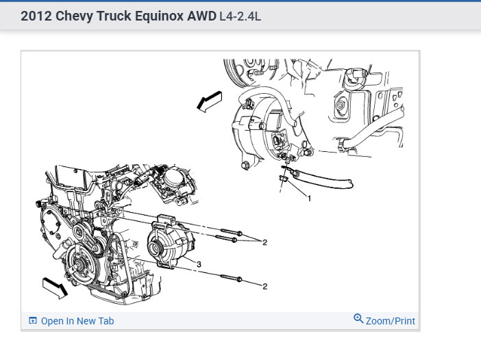

Okay, after looking again there is a wire running into the alternator that I did not check because I couldn't get to it with the tester. It looks like that same wire is running from the inline fuse to the starter that I already tested were good. Do I need to take the alternator out to check that wire?
Monday, August 7th, 2023 AT 4:58 AM
  • 110,192 POSTS
You shouldn't need to remove the alternator to check it. Could you take a pic of its location and upload it for me to see? Maybe I'll be able to give you some ideas.
Note: Remember that the wire I am talking about should always have battery voltage (if the fusible link is good). Be careful not to short it on anything metal.
Let me know. I have a feeling that is the issue.
