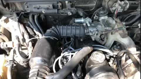

RICHARD BLAKELY
Hello again. We removed the front O2 Sensor from the exhaust, reattached the manifold and for the sake of trying swapped the PCM and the AC control relays (they are the same relay according to the part number) around to see if this had any effect. I also verified 11.48 volts to ground at the IAC valve.
(Is the normal operating state of the IAC to be open with voltage and is it supposed to be open with just the key switch on?)
I have attached a short video so you can hear the motor, my son is having to pump the gas and before was holding the throttle completely open to keep it running. Also after about ten minutes there are still no codes present on the reader. I was only getting 942 RPM according to the PIDs and the MAF was reading 1 to 1.5 lbs flow.

KEN L
  • MASTER CERTIFIED MECHANIC
  • 55,281 POSTS
Thanks for the video. It looks like the the coil pack is bad but lets do a compression test to see if you have a head gasket blown between two cylinders. Here are two guides to help us:

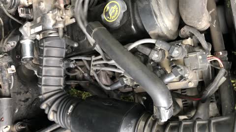

RICHARD BLAKELY
Hi Guys,
Okay, the compression test came back at 152 on the lowest and 160 on the highest with one spark plug out of each cylinder. We went ahead and replaced all the plugs and plug wires due to excessive carbon buildup on cylinders two and three and some heat discoloration on the cables. We did not change out the coil packs because both of them seem to work correctly with the truck acting the same with either disconnected. The attached video is taken right after we reassembled everything today. I checked all vacuum ports for clogs and that came up negative. I have no vacuum leaks using the carburetor cleaner test, but when sprayed into the valve cover hose the engine idles up correctly and and will stay running until the cleaner is burned out. I am going to run a fuel pressure test on the three year old pump and filter and see how that goes.
Oh, still no codes. If you have any other suggestion after the video please let me know.

KEN L
  • 55,281 POSTS
Good work on the video. Yes, that looks like no fuel is getting to the engine. Can you hear the pump working in the back? Here is a fuel pressure test guide to help:
