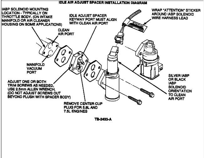

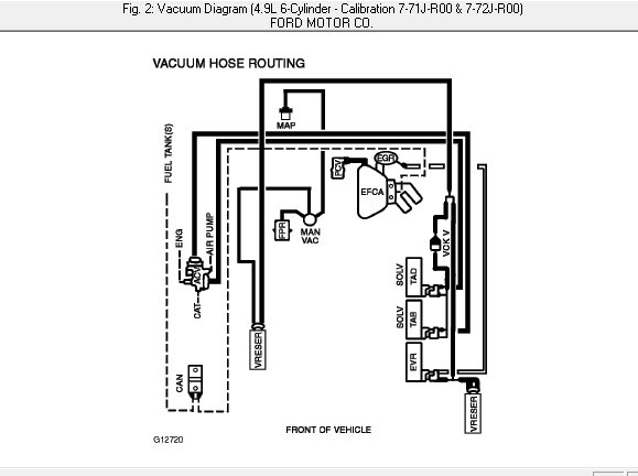

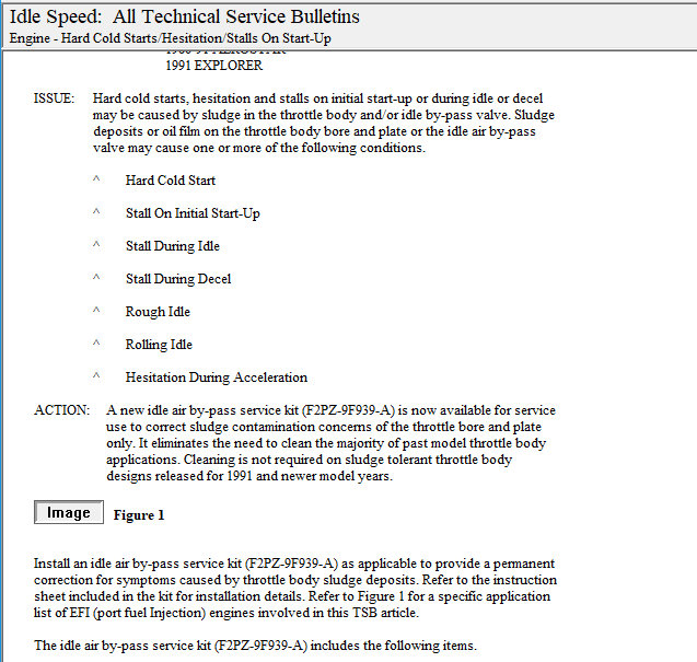

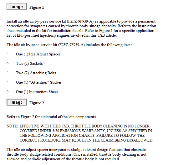

Hi, emailed you a couple of weeks ago, thank you. My problem is my vehicle listed above ll model, when I first start it, it shuts off off, then I start it again and just rev the gas pedal for a bit maybe two minutes, then it starts to idle and run fine. It is just the initial first start up. I was thinking we may need to change the vacuum lines but can't seem to get a good diagram online. My manual says to check the vacuum hose near the intake manifold. Is there any way you could guide me on this and help me get a good diagram, on the vacuum hoses for my vehicle? Thank you
Sunday, April 7th, 2019 AT 11:22 AM (Merged)
SEVAG P
  • 406 POSTS
Hello thanks for using 2CarPros.
Hello it seems your idle control is not working properly. check attached files for complete trouble shooting.(fig 1,2,3) and fig 4 for vacuum diagram.
Check our guide for engine stalling:
https://www.2carpros.com/articles/how-to-replace-an-idle-speed-control-motor-iac
Let us know what happens with you.
