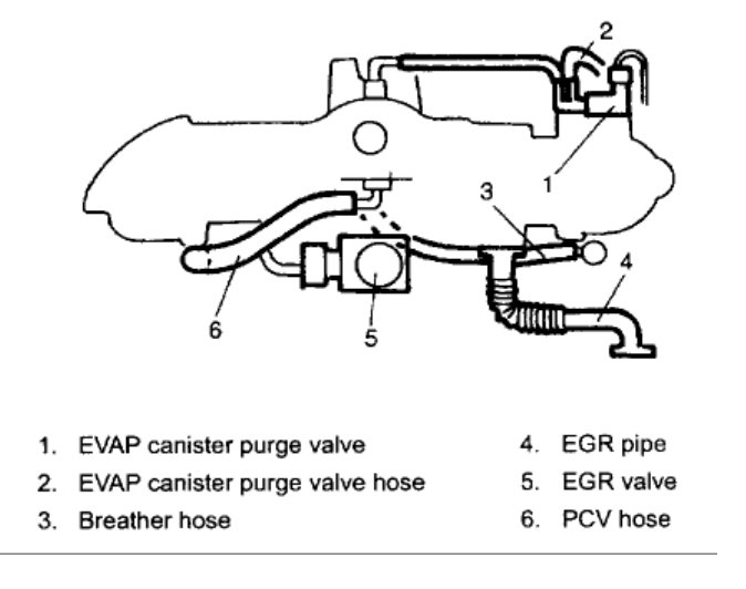

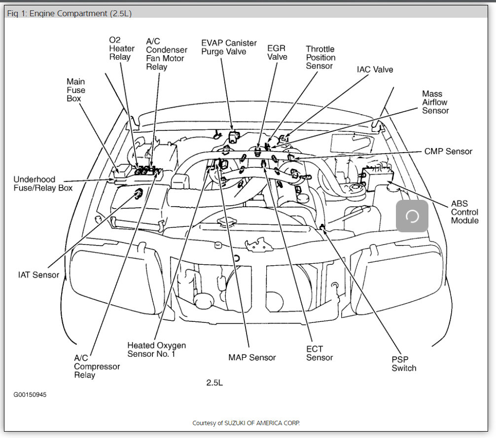

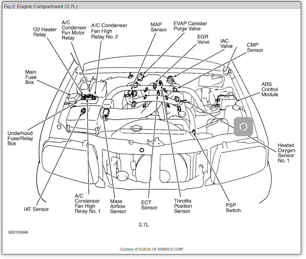

P0505 is a code for the IAC valve (idle air control ). have the iac checked and clear the codes the other codes are related the purge control and the EGR system. i would sort out the IAC first and then see if the other codes re set before looking into them.
Sep 30, 2017 at 11:57 PM
  • CAR REPAIR CONTRIBUTOR
  • 54,436 POSTS
Yep there are two things that come to mind which is a vacuum leak or the EGR valve is sticking open.

This would effect the EVAP system as well

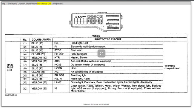

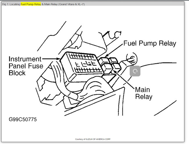

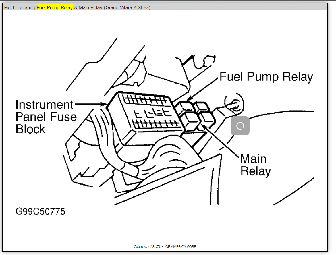

update, took it to a dealer and had it checked on their diagnostic machine, the tech thinks it's a faulty fuel pump relay, so far though I can't find the relay, any ideas?
Oct 20, 2017 at 7:43 PM
  • 54,436 POSTS

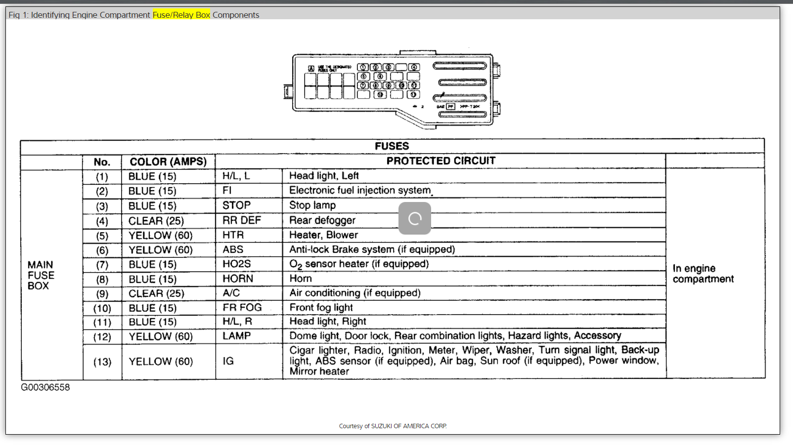

It looks like the relay is in the under dash fuse panel/relay box. Here is a guide and some diagrams (below) so you can do some testing.

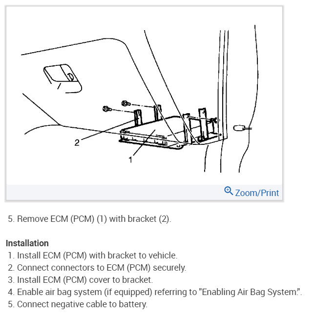

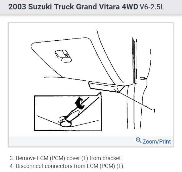

  • 54,436 POSTS
I asked if the coolant was low to see if it was leaking inside the combustion chamber creating the white smoke. The engine computer is the same thing as the PCM. I was thinking PCM but wanted to make sure one of the injectors or coils was not causing the issue.
You can try a used PCM and plug it in to see what happens here is the location.
