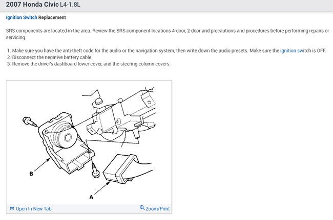

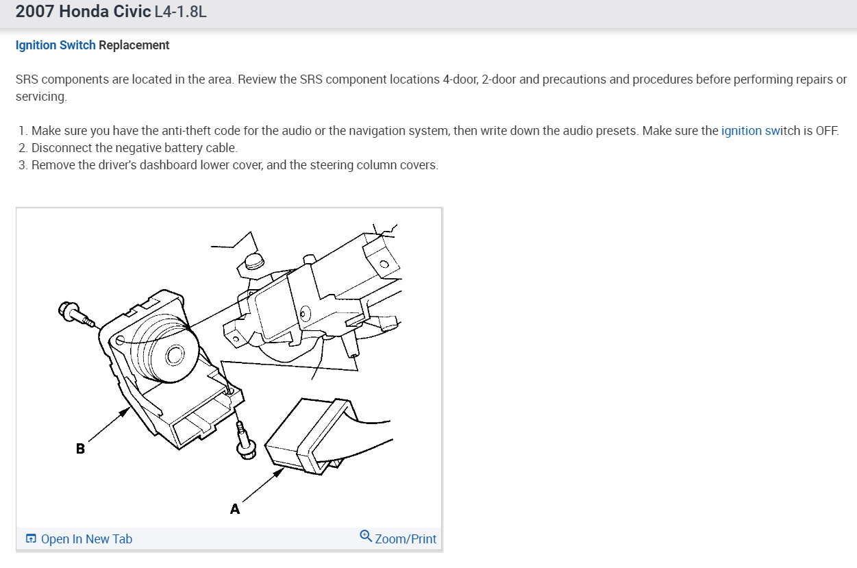

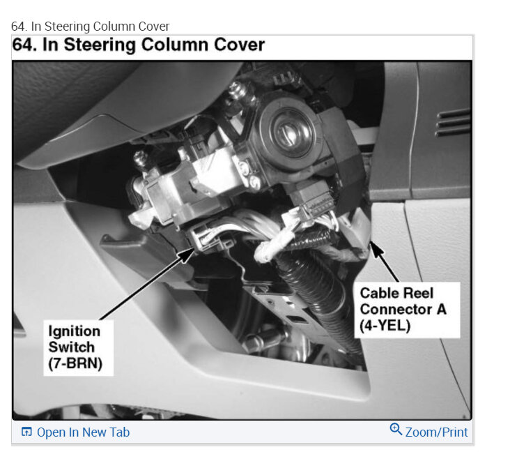

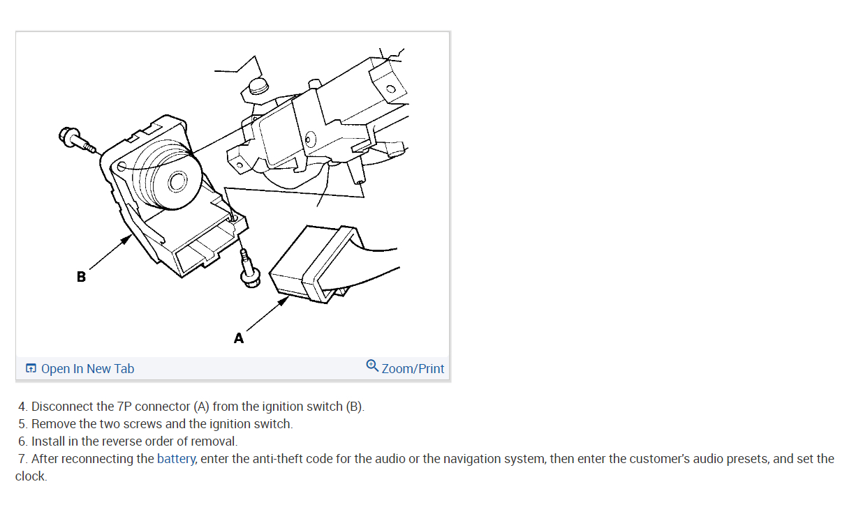

The fact that the battery indicator was just not lighting up is telling us the ignition switch can be bad, but we should do a CAN scan first to see what comes up. You can get a CAN scanner (Controller Area Network) from Amazon from about $32.00.
https://youtu.be/u-4syLc-ifQ
and
Amazon CAN scanner link:
https://amzn.to/3sX8MCX
This guide can help as well:
https://www.2carpros.com/articles/engine-stalls

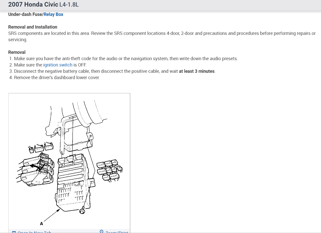

Here is how to change the ignition switch in case you need it. Check out the images (below). Please let us know what you find. We are interested to see what it is.

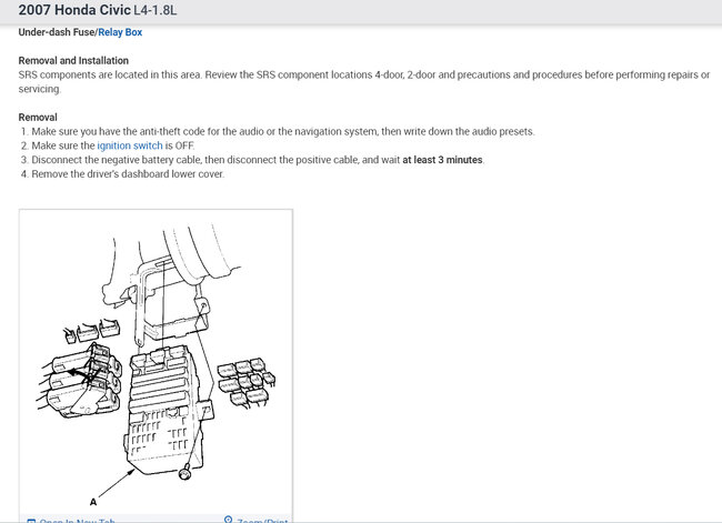

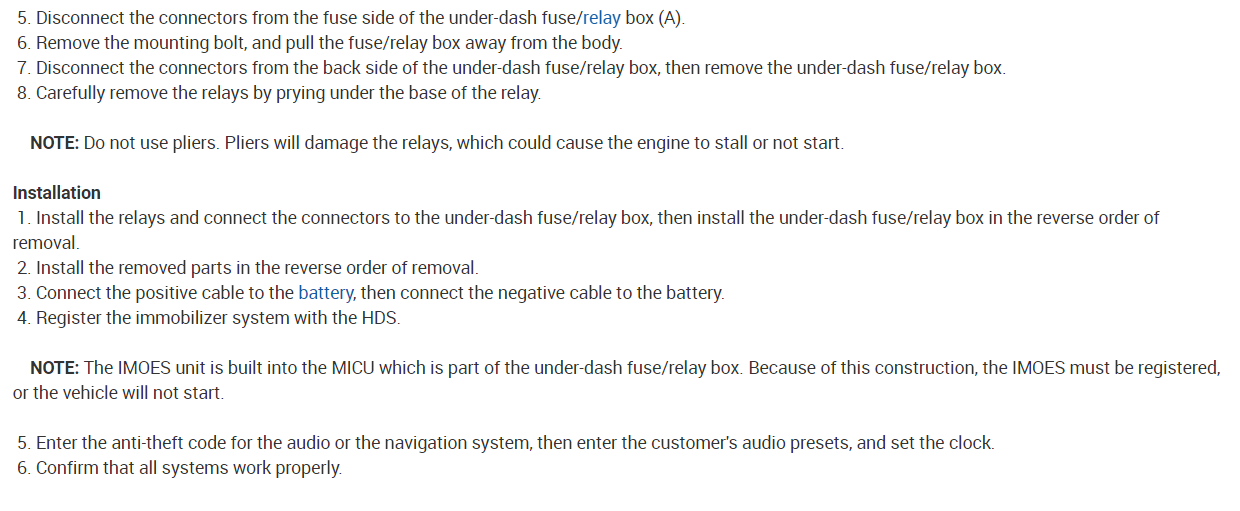

This could be the MICU inside the fuse panel has gone out which I have seen before, they will give off a burnt smell when the they fail. The fuse panel may need to be replaced. Here is how the job is done in case you want to see what will fix the problem. Check out the images (below). Please let us know what happens.

When replacing the fuse box, does the replacement have to have the exact part number as the one removed from my car?
Tuesday, January 3rd, 2023 AT 6:51 AM
KEN L
  • MASTER CERTIFIED MECHANIC
  • 55,499 POSTS
Only if there is a part update from the dealer can you have a different part number, if not the part numbers must match.

Just an update to what happened to my car, changed the MICU or interior fuse box, car still wasn't fixed. Now I don't know where else to look.

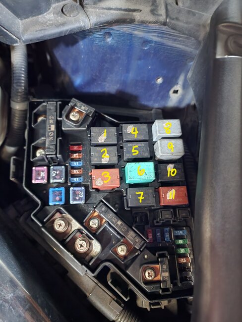

Just an update, there were no codes when they scanned my car when it stalled and not starting. Then they checked and replaced the relay, main relay (#3 on the pic), and the car started. But the problem is, when the car was with me and it stalled and did not want to start, I changed the main relay and ignition coil relay, and it did nothing. Is this still a relay problem or is it the connection? They've checked the wiring and fuse box both inside the car and under the dash and everything's working fine.
