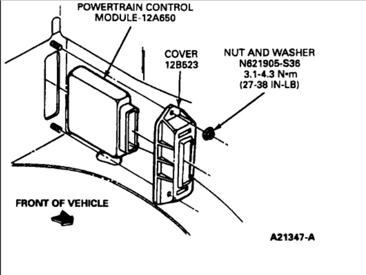

Engine runs great sometimes, suddenly begins to run on only two cylinders. Replaced plug wires, both ignition coils, crank sensor, mass air flow sensor and all four fuel injectors. Never better result, runs perfect for short periods of operation then suddenly no power, feels like two cylinders operating.

It sounds like you have an injector driver that is going out in the ECM. I would get a used one and plug it in to see what happens.
Check out the diagrams (Below). Please run this test and get back to us.
