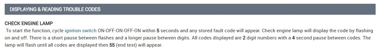

Okay, last night i pulled the front 3 plugs before i tried starting it. They were dry. then i tried testing the MAP sensor. i got 5 volts unplugged with the key on. Then with it plugged in i got about 5 volts. i am wary of doing a spark jump test as in my auto manual it says that it can harm the computer. i tested the coil. Is that not good enough? It came within specs stated in the manual. when i sprayed starting fluid in the intake it seemed to spit or backfire it out. So, would a bad sensor not throw timing off and cause that? thanks
No testing the resistance of the coil primary internal circuit is not good enough.
If you had a backfire into the intake manifold, and the spark plugs came out dry, then there probably isnt any fuel getting into the cylinders, the starter fluid wasnt enough to even start the engine or you didnt spray enough in, either way, a backfire into the intake is most commonly a lean mixture. Meaning not enough fuel, or any fuel at all. The MAP sensors signal is going to be near or close to 4.5v-5v without the engine running, if it was running and there was actually vacuum in the intake manifold the MAP would be reading 1-2volts, at higher voltage its just reading atmospheric pressure. Meaning no vacuum,

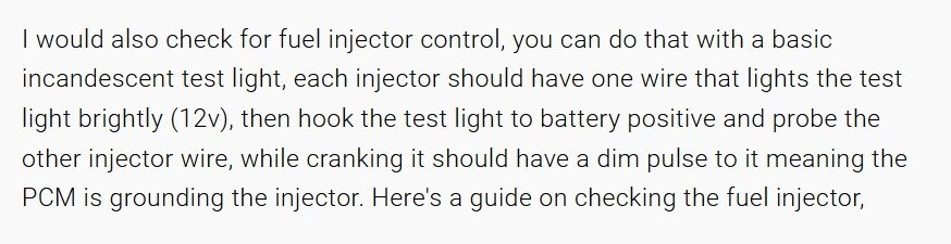

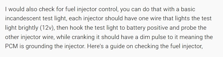

It sounds like you have spark if you had a backfire, are you sure you checked for an injector pulse correctly?

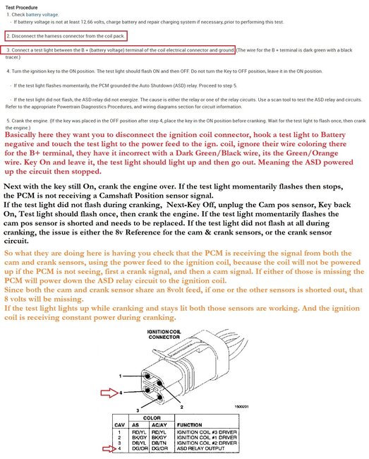

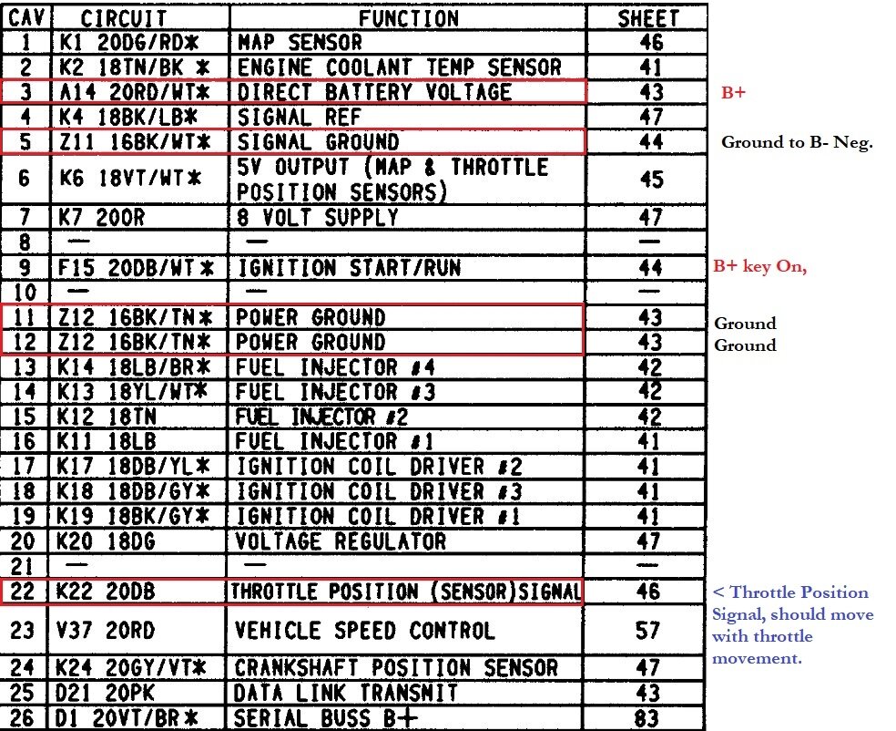

Heres the testing of the cam and crankshaft position sensors using a test light and the ignition coil power feed, if you dont want to check for spark, theyre having you check for power remaining on the coil power wire while cranking, if theres no crank or cam signal the power will shut off from the coil, because the PCM will power down the ASD relay if it doesnt see both cam and crank signals, or just watch the video below and check for spark,
Watch this video, go right to 9min 35seconds in the video, he does a spark check using a test light to check that the coil has good output.
https://www.youtube.com/watch?v=yw48gKmsy-0
https://www.2carpros.com/articles/engine-backfires-while-running

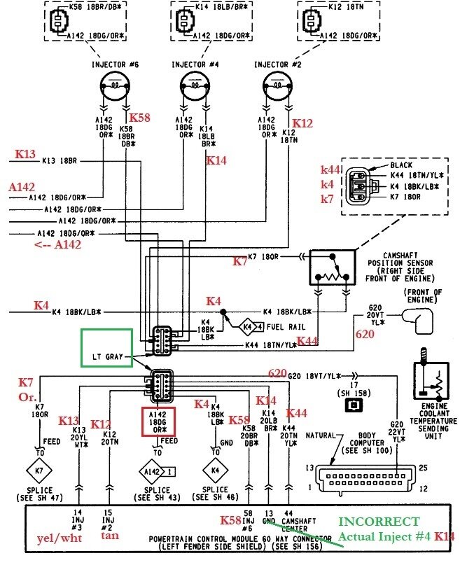

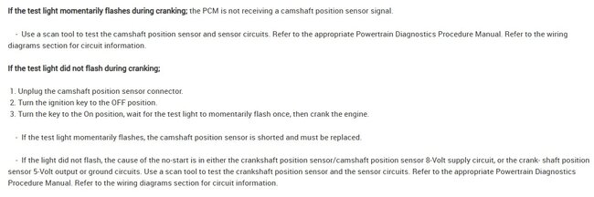

Okay, so, i did this test. the test light flashed once when the key was turned on. when cranking it over it was flashing. then i disconnected the camshaft sensor i checked it for voltage. It had 8 volts. then tried cranking it over again. the test light didn't do anything i tried to check it for codes again and my scanner didn't show any fault codes.
Jul 19, 2024 at 7:56 AM

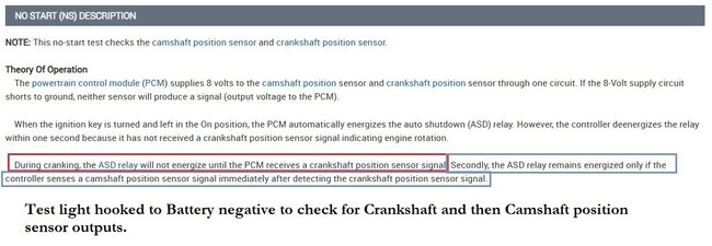

So, since your test results are kind of reverse of what they are stating here, they are saying you will only get the one second power on for the ASD circuit if there are no cam/crank signals. And then it should only be a momentary flash. Then the PCM de-energizes the ASD circuit due to no cam/crank signals,
If we were to follow the flow chart here, with the cam sensor unplugged and not flashing of the ASD power feed, their diagnosis is a bad cam or crank position sensor. Or the signal for those sensors is not making it all the way to the PCM, at this point, you can try replacing those sensors.

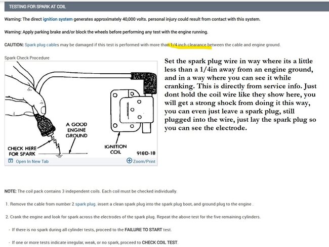

But you really should check for spark here, you're not going to hurt the PCM, we check spark all the time, whether you use a spark check tool or a test light it doesn't matter, we need to know if the coil is outputting any spark.
I've added the spark check from service info as well, since the spark plugs are coming out wet with fuel, it sounds like the injectors are firing, check the oil too, see if it smells like there's gas it in, it's probably completely contaminated with fuel by now.
You can see in the video I posted of him checking for spark with a test light, he is a teacher at a college, teaching automotive diagnostic testing and one of the best. He wouldn't be checking spark like that if it wasn't safe for the PCM. I do the same testing as well. Since the crank and cam shaft position sensor signals are only a 5-volt output, you won't be able to see it with a test light. You need an oscilloscope to see those signals.

Okay, A, l i checked for spark and i was getting spark. did i see somewhere its supposed to be blue ? is that for every make and model ?and i checked for compression on the front 3 cylinders. it was 150-160lbs it would of been higher if i could tighten the fitting more but i couldnt get a wrench in there to tighten it. so i dont have a wiring diagram for the cam and crank circuit. so how can i figure out if the voltage goes to the crank sensor first before going to the cam sensor. the instructions didnt say i should disconnect the crank sensor at all and check it. so?

Did you have spark on the front 3 spark plug wires and did it jump at least 1/4in?

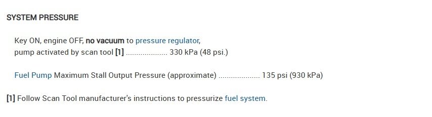

You have spark, you said you had an injector pulse, your fuel pressure is low (should be at least 48psi), you mentioned it might have bad gas, you have plenty of compression, so either something was missed or the exhaust is restricted.
If you have spark then I think the crank sensor is fine,
And if you are absolutely sure you did the injector pulse test correctly and the injectors are pulsing on the Ground side of the 2 wire connector, then we are down to only a few possibilities. But you have to be positive there is an injector pulse.
Im not sure how much starting fluid you used, but I would try that one more time, have someone else crank the engine while you spray either starting fluid or even brake clean works better into an open port on the intake manifold.
But you may not have used enough since this engine has been cranked over so many times, the cylinders are completely washed out by now if theres any fuel spraying from the injectors.
you need to be sure of the results of your other tests so far, and I am not.
That being said, it leaves either weak fuel pressure, where the spark plugs would come out wet and carboned up due to lack of combustion, or possibly a restricted exhaust. Meaning the Catalytic Converter has failed.

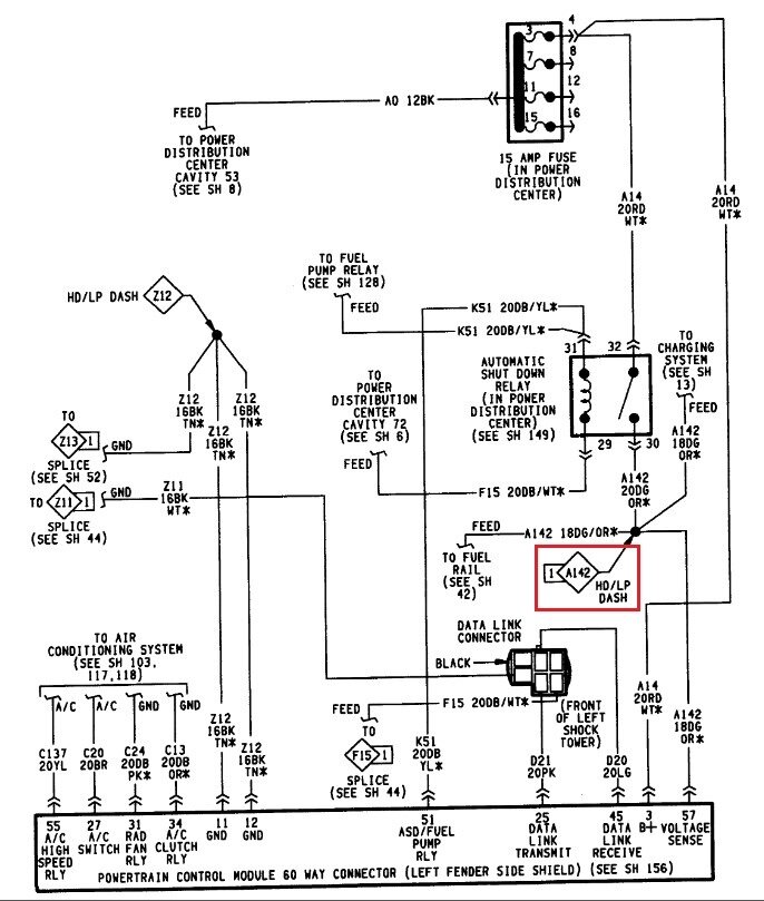

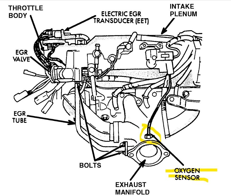

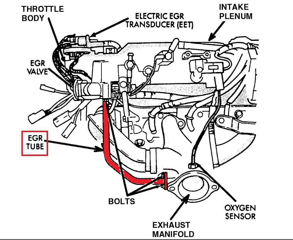

If you need an example of checking back pressure for a restricted exhaust here is a video showing how to do it, I use my vacuum gauge which also goes up to 10psi of positive pressure, and when checking for back pressure at the Oxygen sensor port, there should be no more than 1-2psi at max, even 2psi is too high.
In the diagram it shows where the front Oxygen sensor is located on the back of the engine. Hopefully it comes out easy, but dont force it or you'll stripe the threads out.
You could even check back pressure at the EGR tube coming off the exhaust pipe if its before the Cat, that might be easier, just do not leave the gauge on there long, I have seen people melt the hose and gauge from leaving it on the exhaust too long, but this is a no start condition so you should be ok. I marked the EGR tube in red on the 2nd diagram, if you cant remove the Oxygen sensor, or unbolt the exhaust at the manifold here, the EGR tube would be much easier to get to.
This car still starts but has a bad Cat.
https://www.youtube.com/watch?v=IPEq53z2iE4

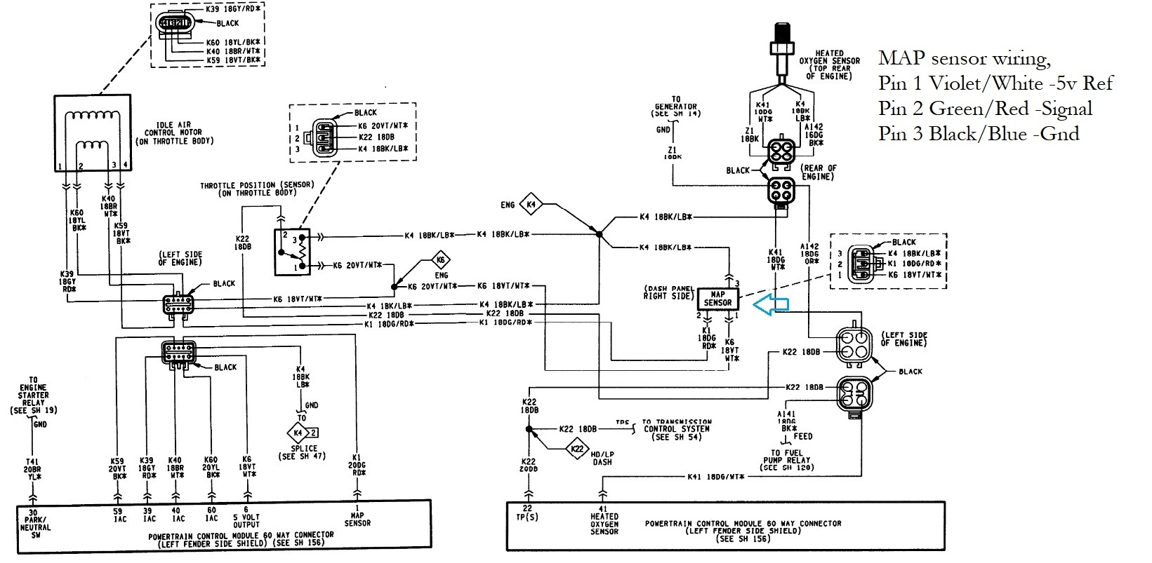

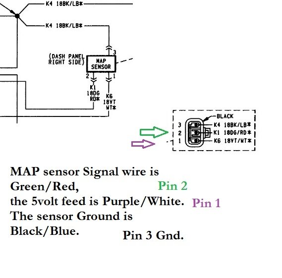

You also mentioned the MAP sensor was not properly installed at one point, I assume you got that put in correctly, I would be curious to see what the MAP sensor signal does during cranking. The engine should produce some vacuum during cranking so the MAP sensor voltage signal should drop somewhat during cranking, Lets check that as well since we are checking everything else.
The Signal wire is Green/Red pin 2(middle pin), the 5volt feed is Purple/White Pin1,
and sensor Ground is Black/Blue pin 3.
Signal should be near 4.5volts key On, and drop a little while cranking.

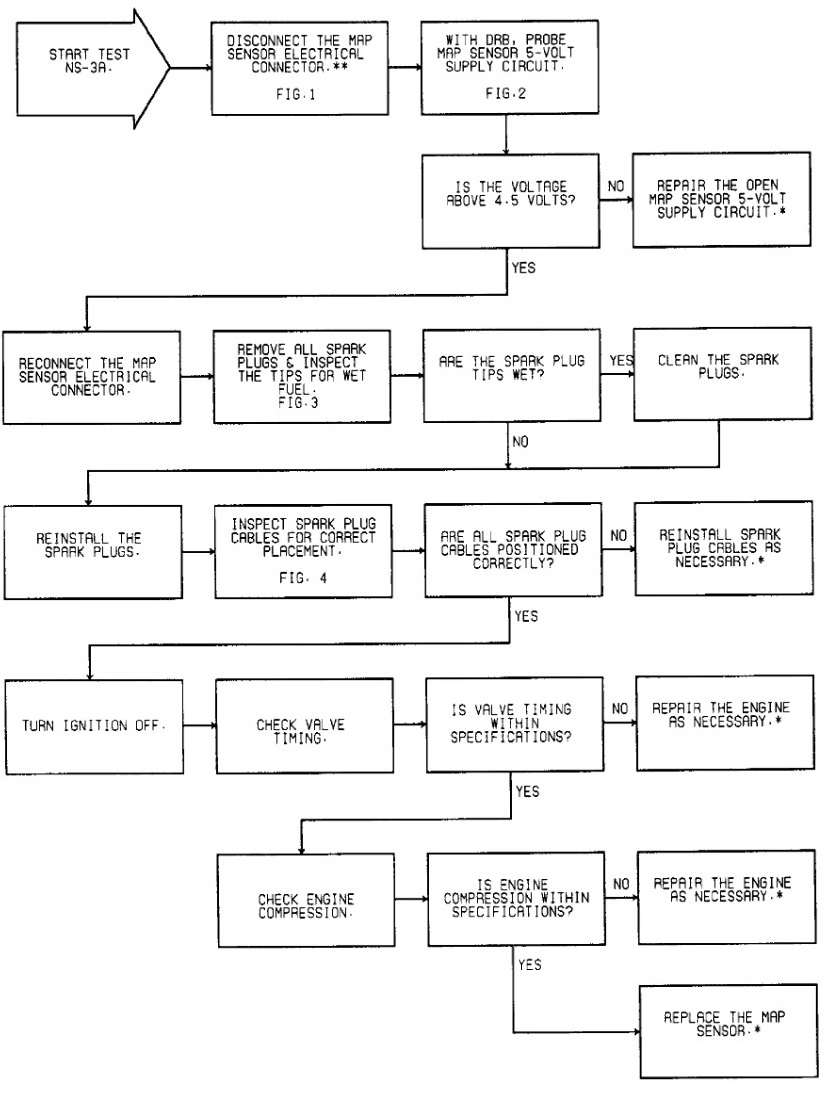

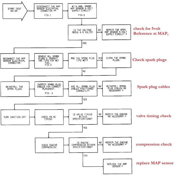

This is the MAP sensor flow chart if you have good spark, good fuel pressure, good compression and timing, and a 5volt feed to the MAP sensor, they have just replace it.
Which Im not against at this point, starting to change some parts is not the correct way, but we have been at this too long,
You can do this before or after checking the Catalytic Converter,

yes, the spark jumped the 1/4 inch but it looked orange. i asked about the blue spark? is it supposed to be blue? and when i pulled the spark plugs they were dry because i pulled the fuel pump relay when doing the spark testing. they were a little blacked but nothing heavy and crusted. and when i did the light test of the coil voltage when i disconnected the cam sensor and cranked the engine, there was no test light i told you this and was waiting to hear back from you ? so i put in new cam sensor new crank sensor tried to start it. and it somewhat started i had to keep pumping the shit out of the gas pedal but it wouldn't stay running. this was all beyond my experience! i checked the voltage on the map sensor already i told you that too. but not while cranking. so i will do that now. I'm at a loss here. DOH ! thanks

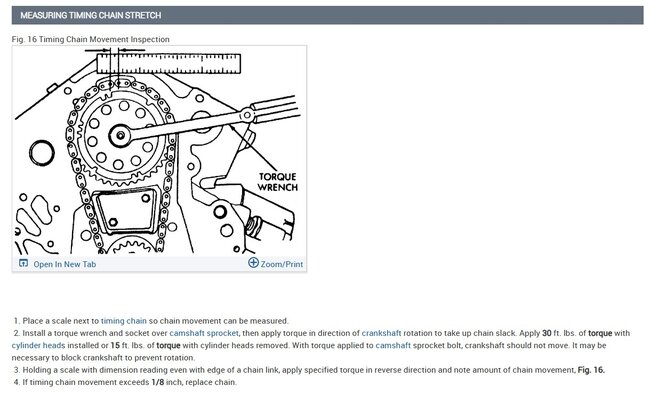

oh i forgot the flow chart says check timing ? how am i supposed to do that ? 3.3

okay, when i checked the spark it did jump the 1/4 inch it looked yellow. and the plugs were not wet because i disconnected the fuel pump relay when doing all the cranking tests. and the plugs were a little blackened but nothing heavy. and i checked the map voltage before it was about 5 volts. but not while cranking.. so i will do that. in the flow chart it says check the timing ? how am i supposed to do that ? 3.3 ?. DOH ! and as far as checking the back pressure on the cat ? i dont think thats a factor here because i have a bad donut at the manifold. i dont know. so after i did the voltage check of the coil when i disconnected the cam sensor and cranked the engine there was no light i waited to hear from you on this ? so i replaced the cam and crank sensor with no success. it started kinda but i had to pump the shit out of the gas pedal but it wouldnt stay running. so im at a loss here ? i dont know. ? let me know thanks

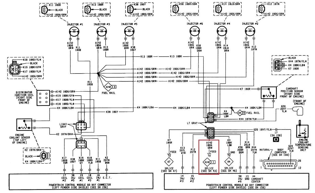

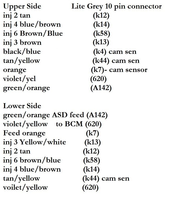

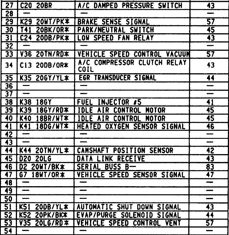

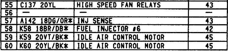

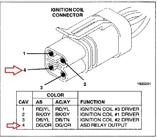

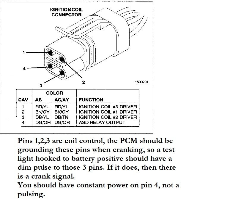

Okay, the reason you didn't see any power to the coil with the cam sensor unplugged is because the PCM will de-energize the ASD relay if it does not see a cam signal directly after the crank signal, so that means that those signals are okay, and all the more so since you have replaced the sensors already. Having to pump the gas pedal to keep it running or try to run, it sounds like you are running out of fuel.
And I understand this diag has been a huge pain, with no codes setting, its all the more difficult. I don't think you have a timing issue here, with the compression readings you have, this is not an overhead cam engine, like many modern vehicles are, this is a one cam engine with pushrods. Newer vehicles have dual over head cams that cause all kinds of problems with valve timing.
The timing chain could be stretched, but to check it you need to pull everything apart and get all the way down to the timing chain itself. You would have to pull the timing cover; this is what they want you to do to measure the timing chain stretch (diagram 1 below). You might as well just replace the engine if you're going to go this far, because the engine is old and has high mileage.
If you want to keep going and check this pump, you can block the return line going back to the fuel tank and dead head the pump, meaning it will put out its max pressure, you will only do this long enough to get a reading, but this pump has a stall out pressure of 135psi,
Without enough fuel pressure the injectors will have a difficult time firing as well, they need fuel pressure behind them to over come the pintle inside the injector.

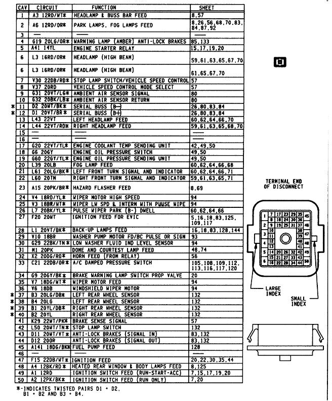

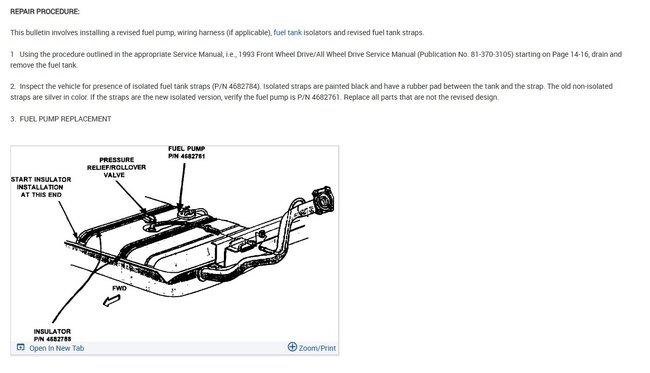

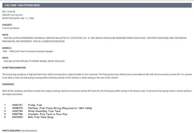

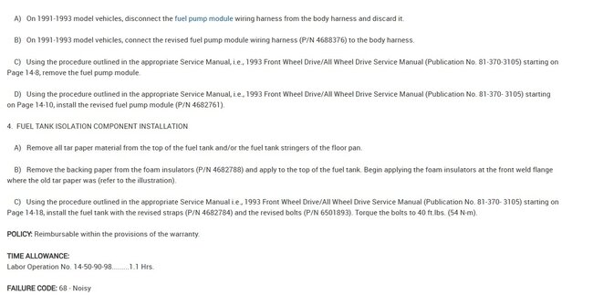

Looking through all the technical service bulletins, there is an old one for a revised fuel pump along with fuel tank straps. Looks like a high pitch noise can be heard from the pump in some cases.

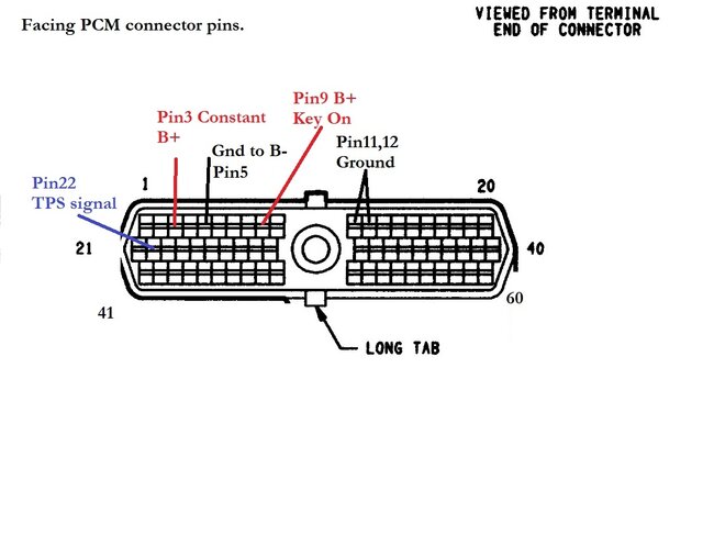

Do a couple other checks with your multimeter set on DC volts, with the key On, check the voltage level from Battery Negative to the engine block, and then Battery Negative to the Body/Frame, it should read close to zero volts, this test really should be done running, but with the key On, if there's excessive voltage drop to the battery you should see something above 1 volt.

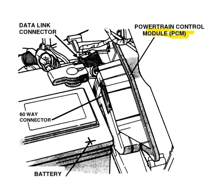

I see the PCM is right next to the Battery here. If you want to check the PCM connector for any corrosion or pin issues, here's the pinout for that if necessary. Just things to check,

Okay, i checked the map sensor again 5 volts before then cranking no change in voltage it stayed constant. and no i didnt get gas any where different. you didnt comment on the blue spark ? though on back pressure in exhaust even with the bad donut ring. thanks

i checked fuel pressure again. i don't get it this time, it was about 20lbs with key on and when cranking it went to about 50lbs. and i did a ground check from battery ground to engine block it didn't show any drain.

If the spark is jumping 1/4in that should be fine, are you checking the MAP sensor signal wire, not the 5volt feed. You should see a lower number than 5 volts on the signal wire, even at key On, it should be lower than 5volts, 4.5v range. And the fuel pressure is an issue, if there are sections of the windings on the fuel pump that are bad, then the pump is not putting out what it should be, or you have a wiring issue to it. It should go right to at least 48 PSI with the 2 second key on prime, not 20 PSI.
The MAP signal wire is the center wire on the connector, green/red wire. Pin 1 should be the 5volt feed, Violet/White (purple/white). The last wire should be the sensor ground, black/blue wire. If the signal wire is not changing at all when cranking, that's also an issue.
That means there is no pressure changing in the intake manifold during cranking, you should be able to put a vacuum gauge on the intake and see a change during cranking, but a clogged cat will affect that reading too. If nothing is going out the exhaust no air can come into the engine. So, you either have multiple issues going on or a bad wiring problem. You should see around 5in Hg of vacuum during cranking with a vacuum gauge on the intake.

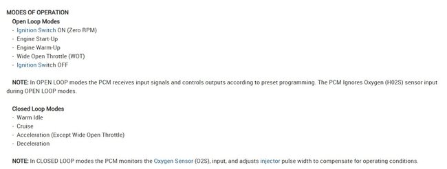

Technically it should, but during a cold start the PCM is mostly looking at coolant temperature for the main input until the fuel system goes into a closed loop operation. During Open Loop and engine warm up the PCM is ignoring the oxygen sensor as an input, until the vehicle gets up to the correct operating temperature. But if a shorted map sensor is affecting the 5-volt reference, which is in turn effecting another sensor such as the TPS, then the injector pulse is going to be affected, another reason for asking about the plugs being wet. But with a lack of fuel pressure the injectors will have trouble opening as well, and it takes a lot more fuel to get an engine running than it does once its finally running. A cold engine takes much more fuel. There's no way it will start on 20 PSI, there's something going on there. But to get to the pump you need to drop the tank on these which makes diagnosing the circuit more difficult if it's a power or ground issue at the pump itself.
