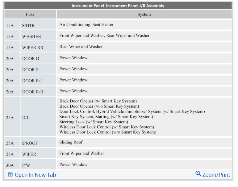

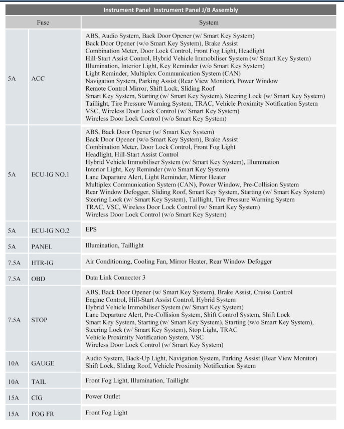

The car was flooded. change hybrid control unit and airbag control unit. when the start/stop button is pressed all lights on dashboard go off. Yet it cannot start..

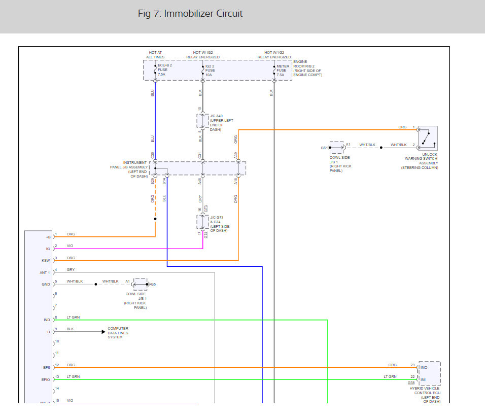

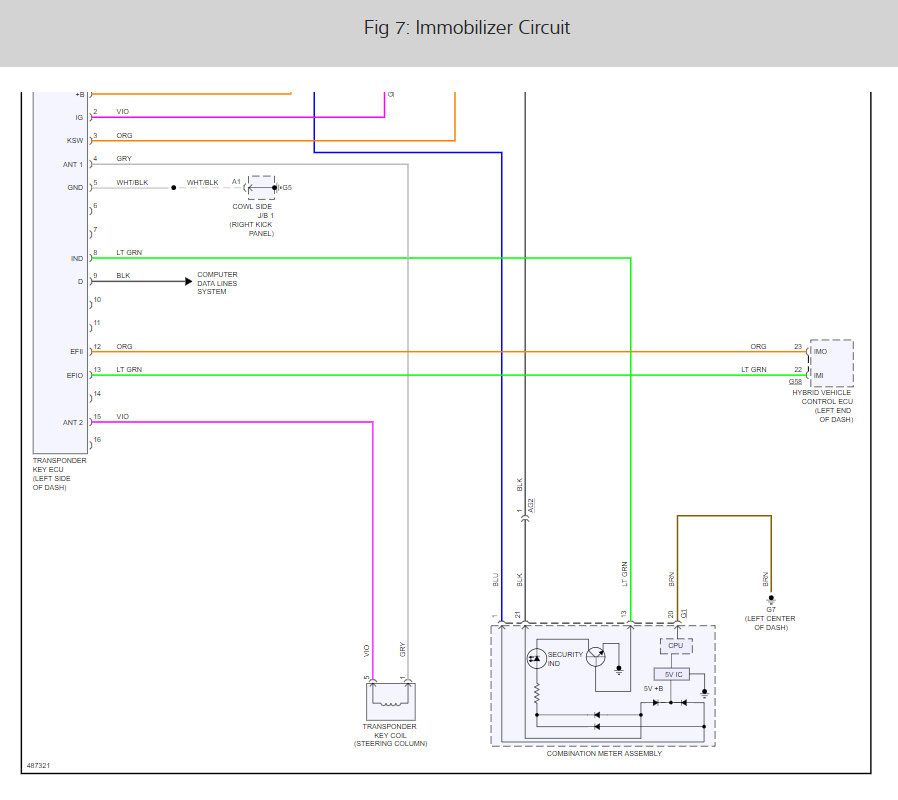

We did a scan after the hybrid vehicle control unit was changed. Also changed the hybrid battery and the electrical batteries.The error the diagnosis is giving ''Immobilizer malfunction'' so how to bypass this issue?

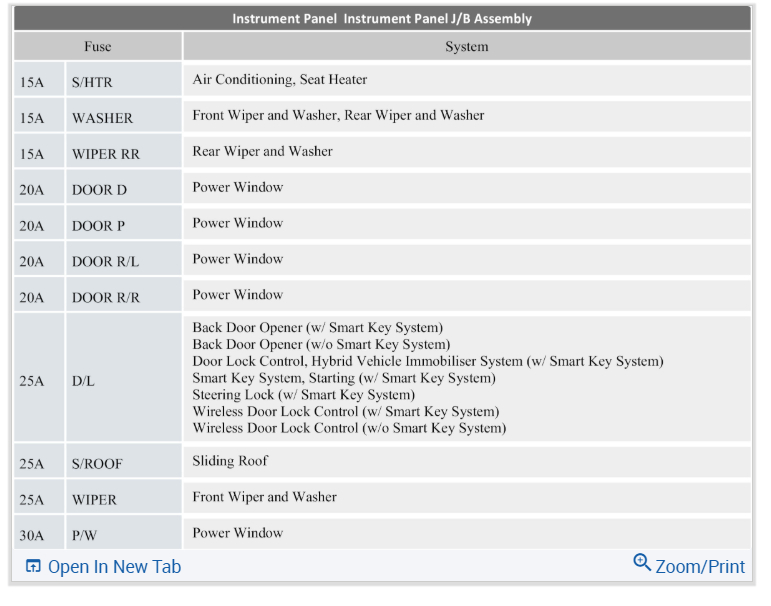

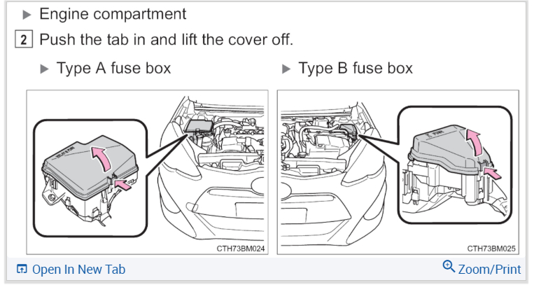

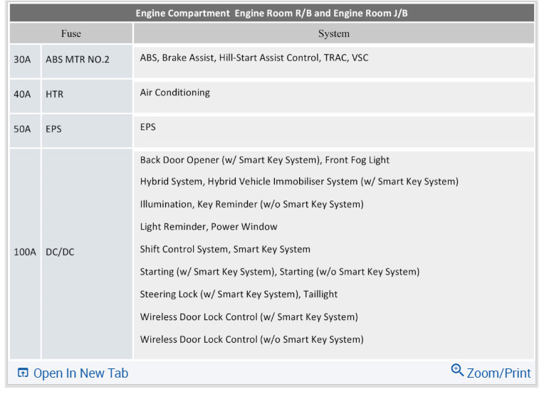

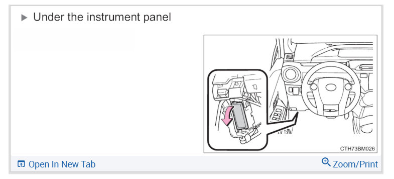

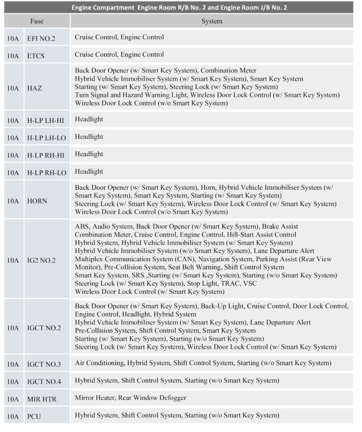

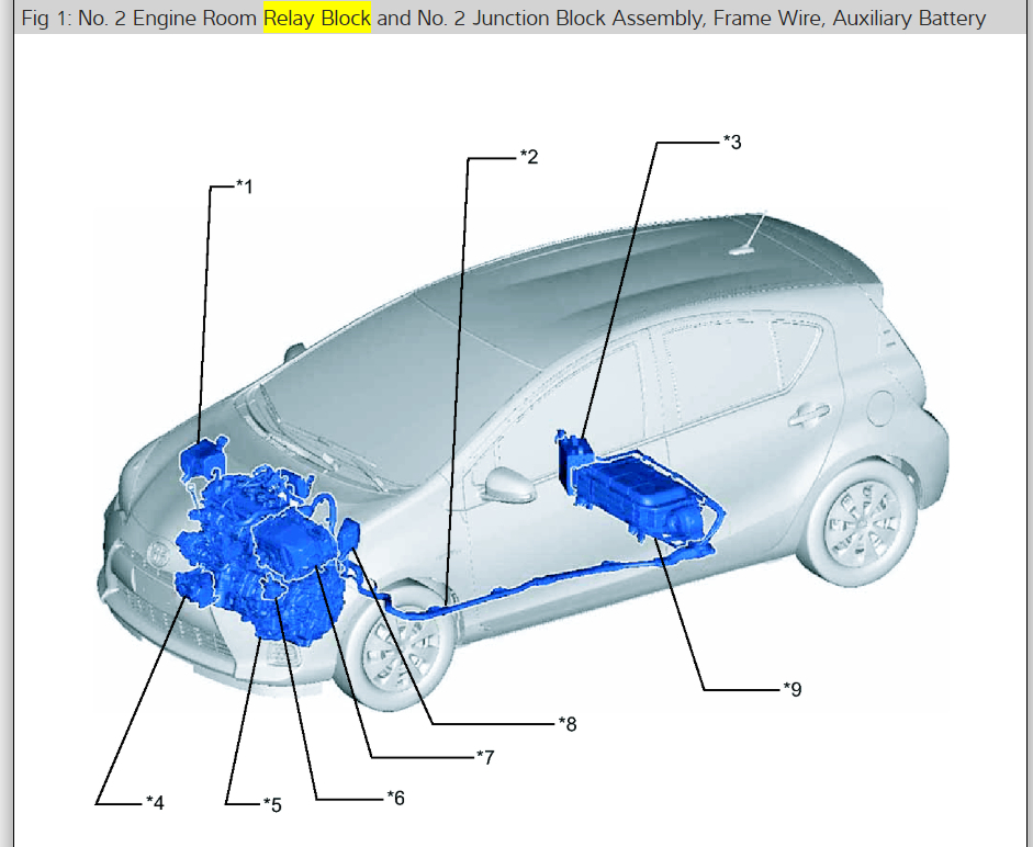

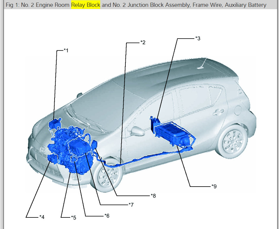

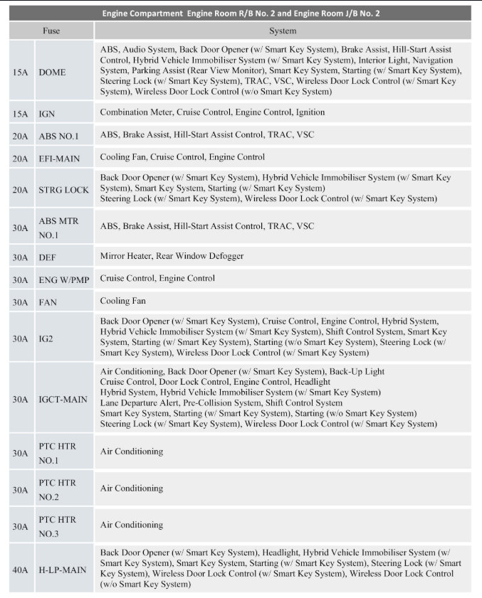

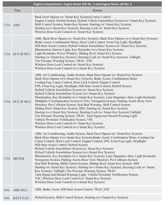

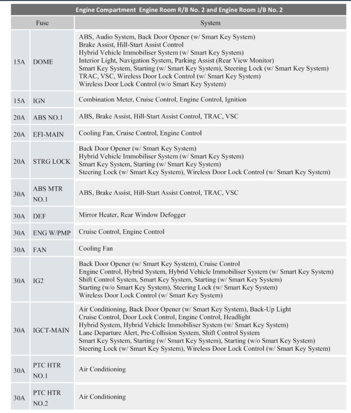

You cannot bypass the immobilizer, it sounds like you have a ID issue that must be reprogrammed the CAN scan will tell us for sure. We should check the fuses (ECU B2, IG2 2 and meter) for power that run the system. here the wiring diagrams so you can see the way the system works and the fuse locations as well, this guide will help check for power:
and
Check out the diagrams (below). Please let us know what you find.
