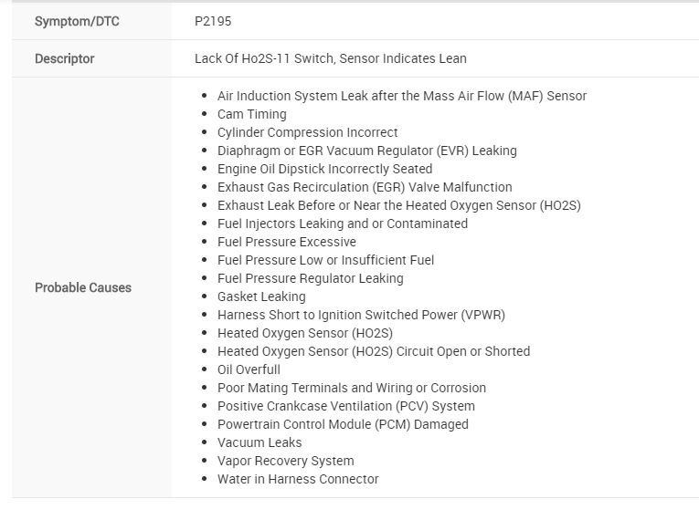

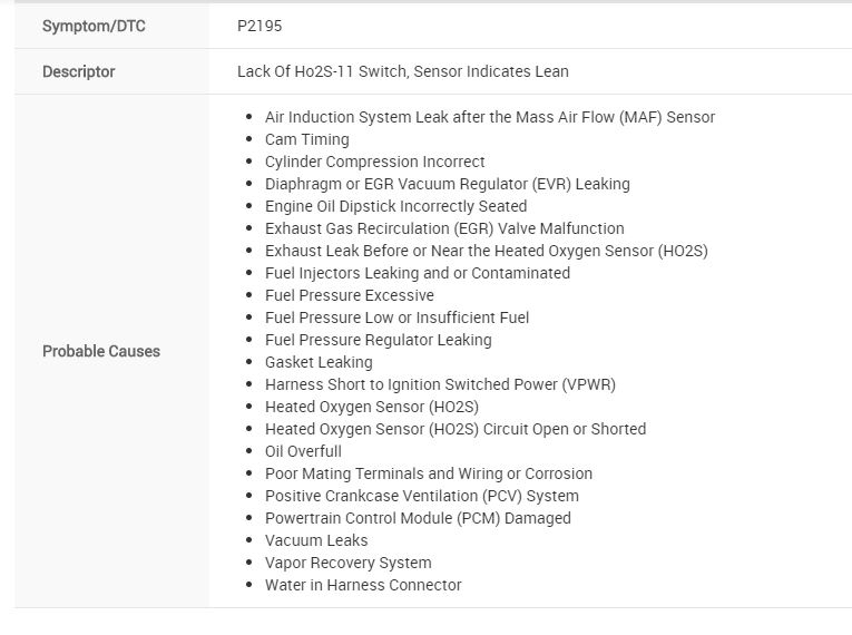

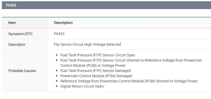

It blinks. But the theft light on the dash isn't on. And yes codes p2195 and p0453.
Monday, November 25th, 2019 AT 4:38 PM
  • 52,797 POSTS
Okay, the 2195 and 453 possibilities are attached. Do you have a scan tool to monitor the fuel system? Both codes are fuel related.

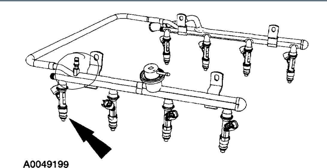

I put a new fuel pump and a new fuel filter in already. How would I check the pressure?
Tuesday, November 26th, 2019 AT 1:19 AM
  • 52,797 POSTS

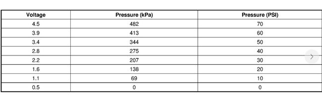

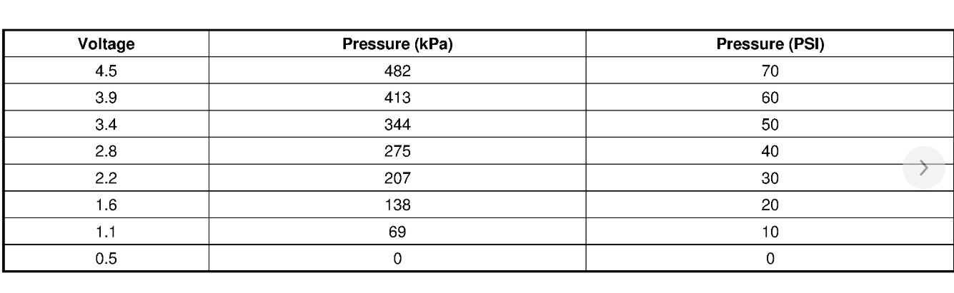

I attached a guide for you for this. You have a valve on the fuel rail for testing the pressure
.https://www.2carpros.com/articles/how-to-check-fuel-system-pressure-and-regulator
I attached a picture of the rail and circled the valve you attach the tester. If you do not have the valve, then you have to read the voltage of the pressure sensor located at the same location. I attached a chart that tells you the pressure with the voltage.
