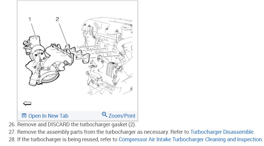

After replacing the intake manifold, valve cover and exhaust manifold/turbo, the engine started right up sounds good, but I can only get 3,000 RPMs when gas is to the floor, let off the gas runs good. Almost like the turbo is kicking in. Also install a new air filter and oil and oil filter. After trying to figure this out by checking wires and hoses.

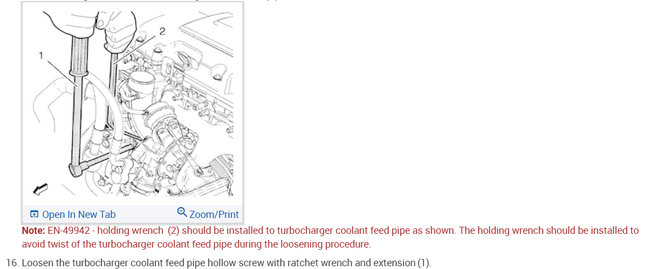

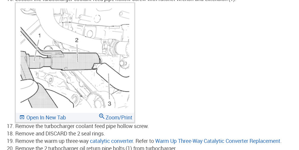

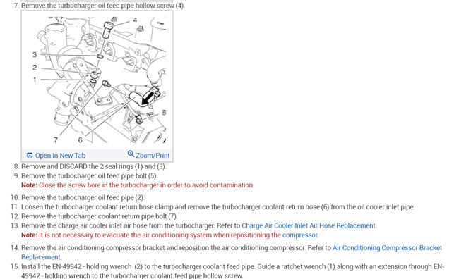

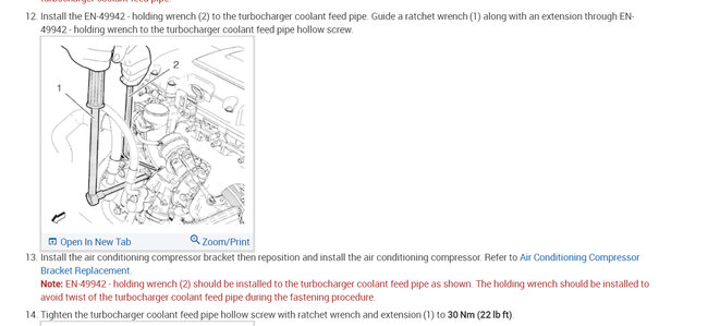

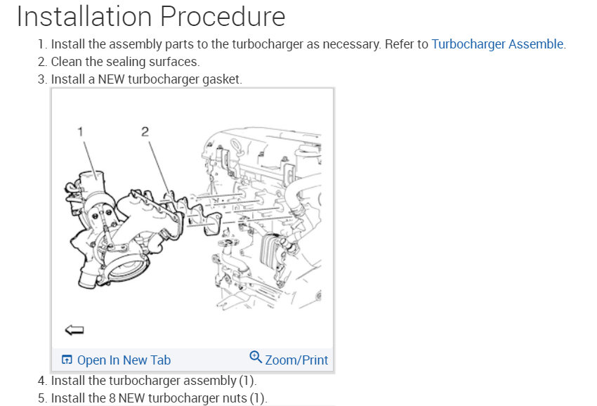

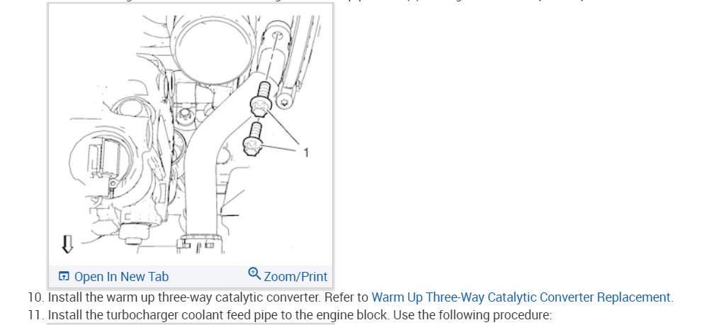

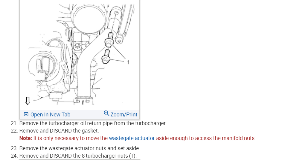

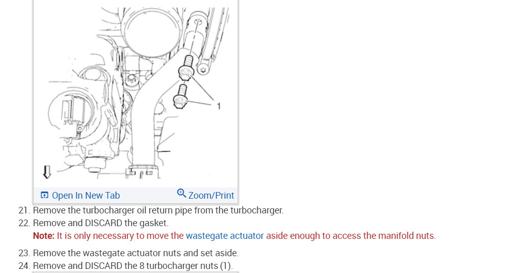

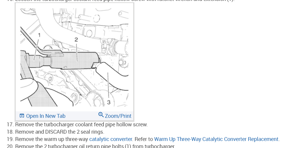

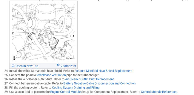

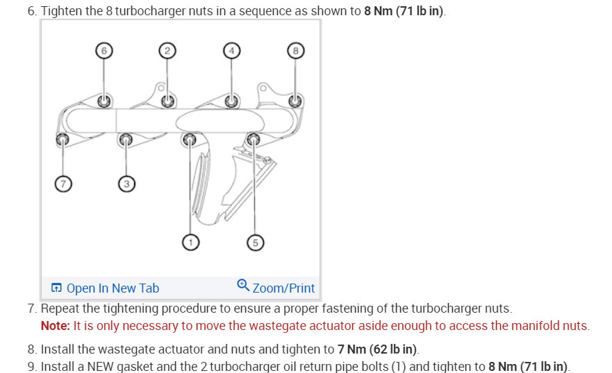

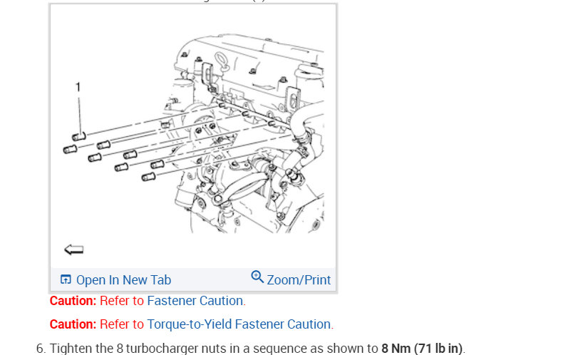

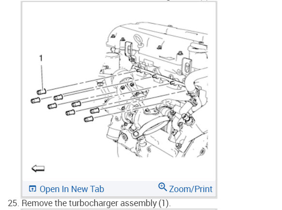

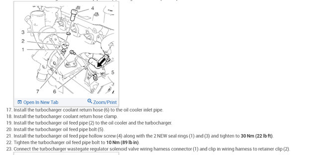

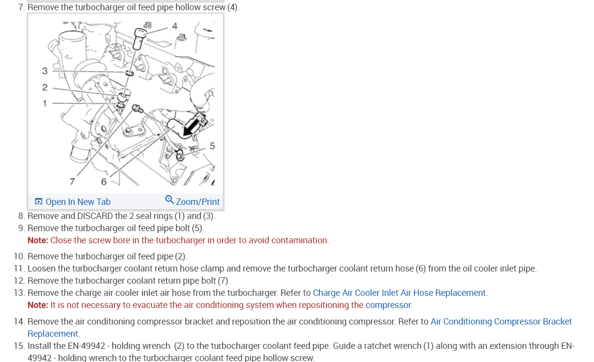

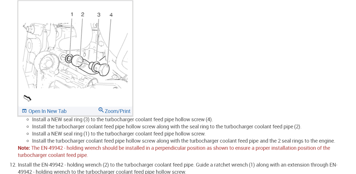

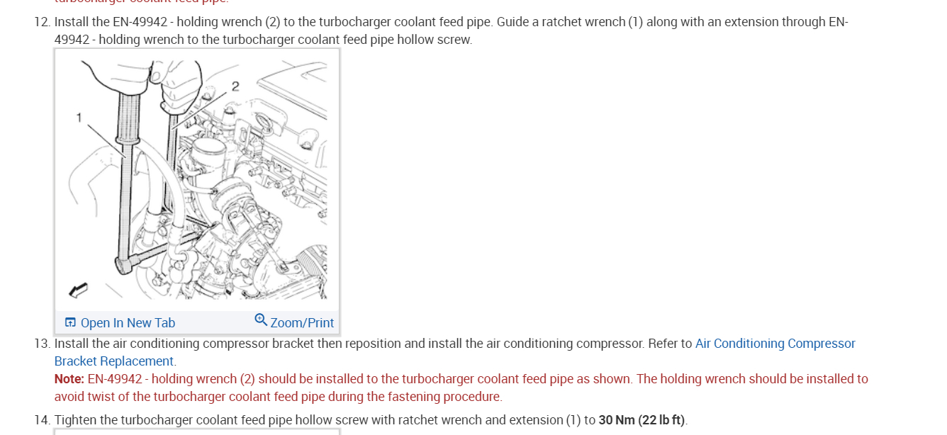

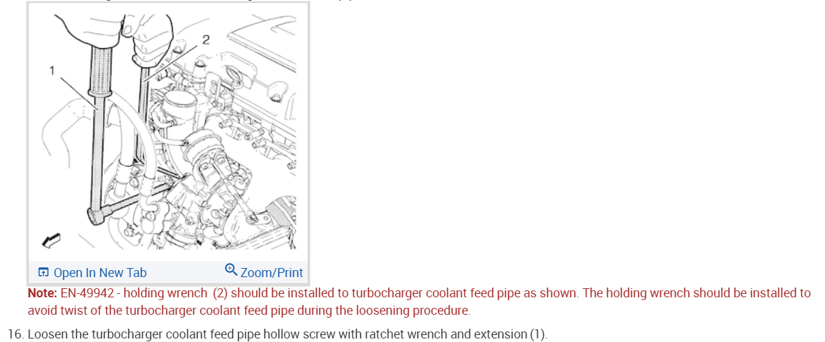

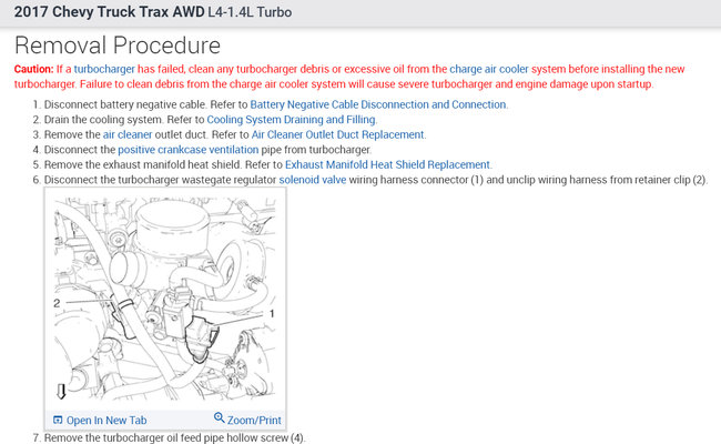

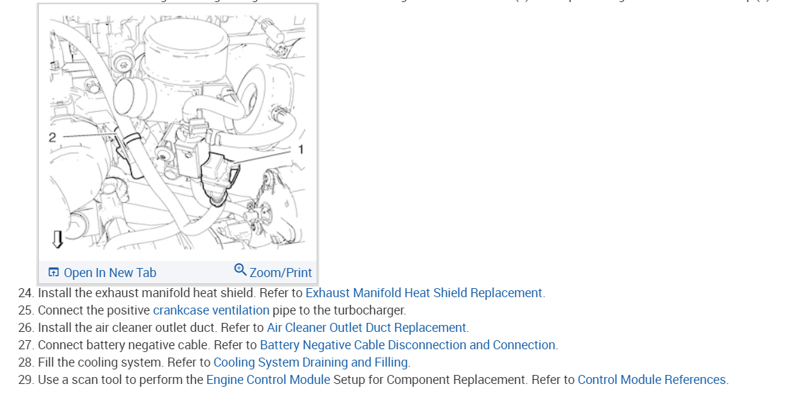

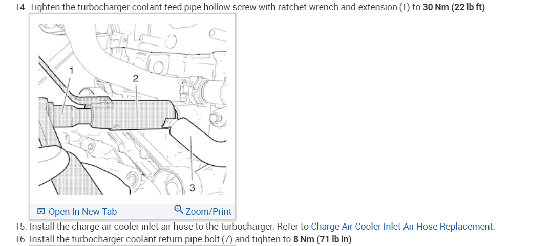

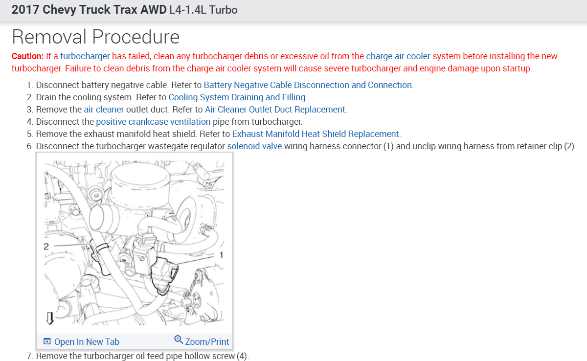

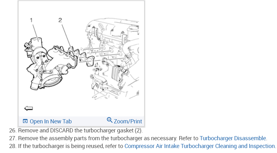

I have seen this problem when the turbo is no good, is it a new turbo, rebuilt used? The way you can tell if the turbo is good is to check the shaft endplay. Check out this guide and the diagrams below that show the correct way to install the turbo.
https://www.2carpros.com/articles/how-turbo-chargers-work
