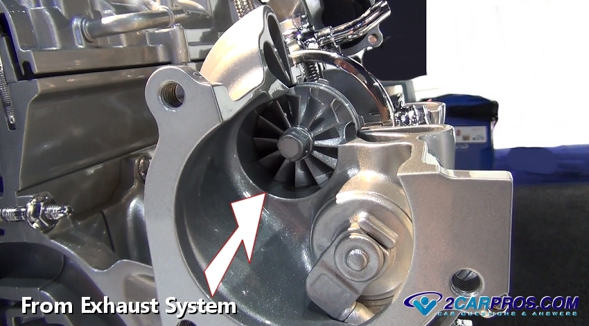

When the engine exhaust valves open red hot fire is released into the exhaust ports where it is collected into the exhaust manifold which is plumed into the exhaust side of the turbo (turbine) which causes the turbine to start spinning, these gases are then released from the turbo and back into the exhaust system, a turbo is generally located close to the engine to maximize performance. As engine RPM increases so does the exhaust system volume, both exhaust and intake turbines spin faster.
exhaust turbo

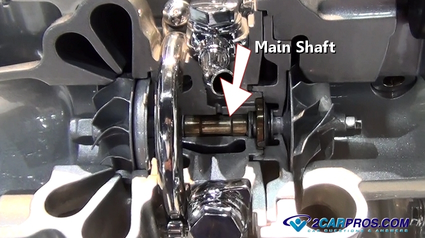

The exhaust and intake turbine fans are supported by a main shaft and two bushings within the turbocharger housing, the shaft is then lubricated using oil supplied by the engine, the oil is controlled using shaft seals to prevent the oil from leaking into the intake or exhaust sides. This is why when a turbo wears out the engine will smoke as the oil is burnt internally.
turbo main shaft
