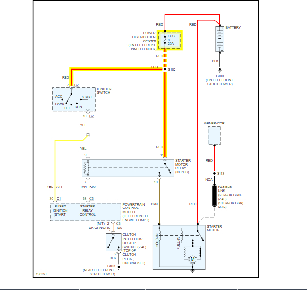

Engine shut off while driving
CRAIG SNI
  • 2005 DODGE STRATUS
  • 2.7L
  • V6
  • 2WD
  • 129,000 MILES
I only get the transmission indicator lights and trip odometer on the dash. Blower works but not the radio. Engine will not turn over. No starter clicks or noise or fuel pump sounds. No indicator lights came on at or before the engine shut off. Any ideas?

I attached a wiring diagram for you to view. Check the fuse listed for power on both sides. This fuse feeds the ignition switch which ties all the issues into this.
+1
Saturday, July 6th, 2019 AT 6:23 AM

Thank you for the wiring diagram, I found out the fuse for ignition (#8 20amp) blown, replaced fuse and ran fine.
What would make this fuse to blow?
Sunday, July 7th, 2019 AT 7:14 AM
That's a good question. There are about 6 things the fuse controls plus all the wiring.
See if it blows again. If it does, then diagnostics will have to be done on the wiring and the components to find the reason.
