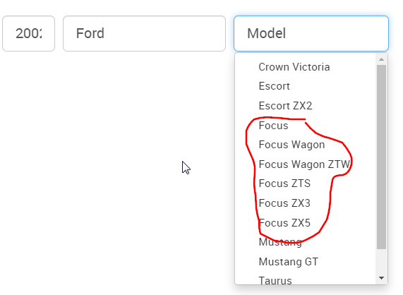

Okay, I know you sent me what you had on my fuse panels but they were not for my car. I have one under the dash on drivers side then one under the hood same side. I need to no the relays names and locations.
Tuesday, July 2nd, 2019 AT 6:02 PM
Okay. Please tell me which body model that you have of the options attached and I will send you what is in the service manual.
Tuesday, July 2nd, 2019 AT 6:46 PM
VERONICA WIMMS
  • 144 POSTS
Its a Ford Focus SE manual 8th vin numbers a 3it doesn't have any type of extras like alarm although it does have a triangle on the dash that blinks a red light. I thought it was the hazard light button, but they don't come on or blink wen pushed. It is a sedan not a wagon model.
Tuesday, July 2nd, 2019 AT 9:42 PM
Okay. According to Alldata the diagrams I sent are correct. The battery junction box is on the rear LH side of the engine compartment. The Central Junction Box is on the LH side under the dash which seems like it matches what you are seeing on the vehicle.
