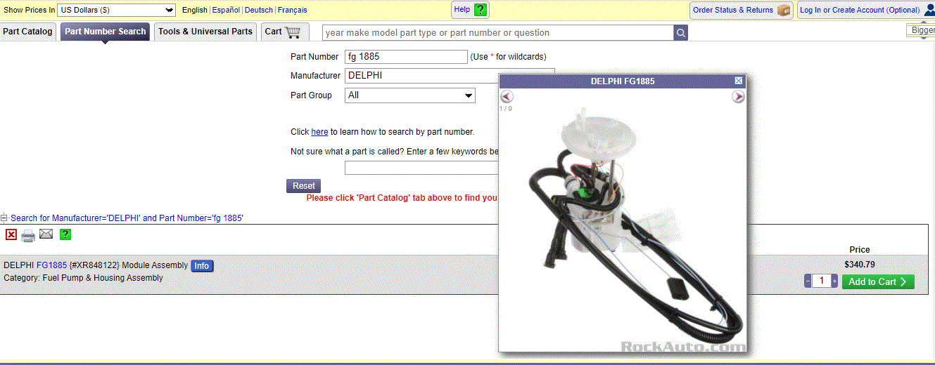

My plan now:

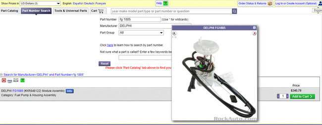

replaced diodes if no place back old pump no buy a new pump assembly. Maybe is the whole assembly looking at the Delphi FG1885 Fuel Module for replacement.
Sunday, September 13th, 2020 AT 7:16 AM
  • 52,797 POSTS
Pump attached.
Sunday, September 13th, 2020 AT 7:28 AM
JAIMSTER
  • 29 POSTS
That is exactly the pump I was looking at Amazon has it for $319.00.
Sunday, September 13th, 2020 AT 1:17 PM
  • 52,797 POSTS
Good deal.
Sunday, September 13th, 2020 AT 1:31 PM

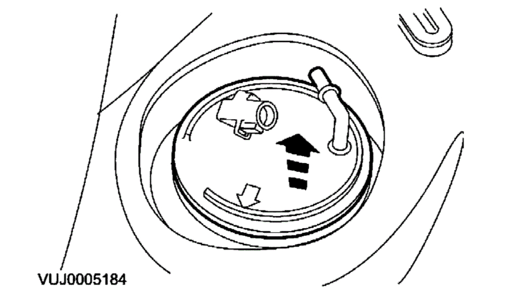

Good morning Roy,
I was trying to find out if there is DIY on replacing the entire fuel pump assembly not just the pump?
Monday, September 14th, 2020 AT 5:35 AM
  • 52,797 POSTS
The unit you provided is the assembly. You have the complete unit with the pump.
I attached the procedure below for you to view.
Remover/Installer, Fuel Pump Module/Fuel Transfer Pump Locking Ring
310-072A
1. Warning:
place the vehicle in a quarantined area and arrange no smoking/petrol fumes signs about the vehicle.
Before any work is carried out on the fuel system, ground the vehicle to earth and maintain the ground connection until the work is complete.
Do not smoke or carry lighted tobacco or open flame of any type when working on or near any fuel related components. Highly flammable vapors are always present and may ignite. Failure to follow these instructions may result in personal injury.
The fuel system remains pressurized for a long time after the ignition is switched off. The fuel pressure must be relieved before attempting any repairs. Failure to follow these instructions may result in personal injury.
After carrying out repairs, the fuel system must be checked visually for leaks. Failure to follow these instructions may result in personal injury.

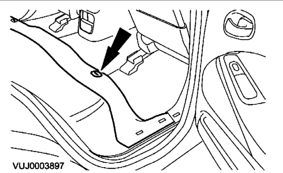

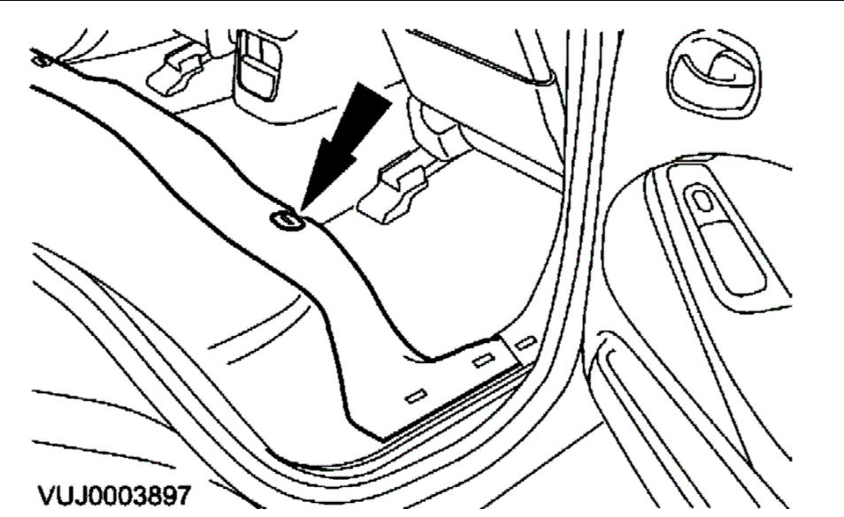

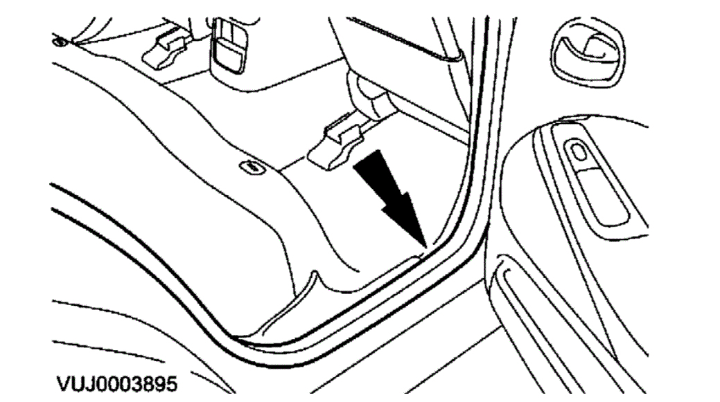

6. Detach and reposition the door opening weatherstrip.
ImageOpen In New TabZoom/Print

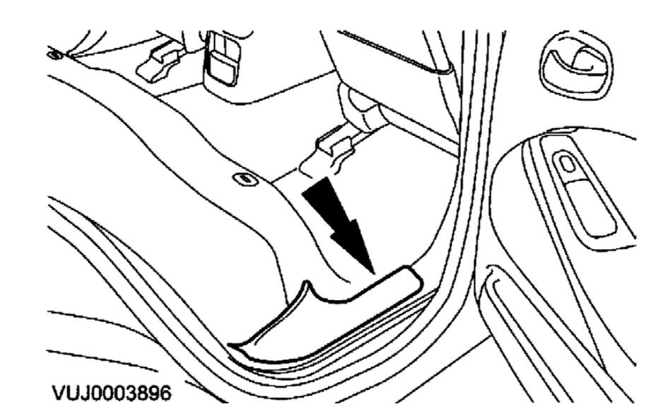

7. Remove the scuff plate trim panel.
8. Detach and reposition the floor covering.
9. Detach and reposition the rear seat cushion insulation.

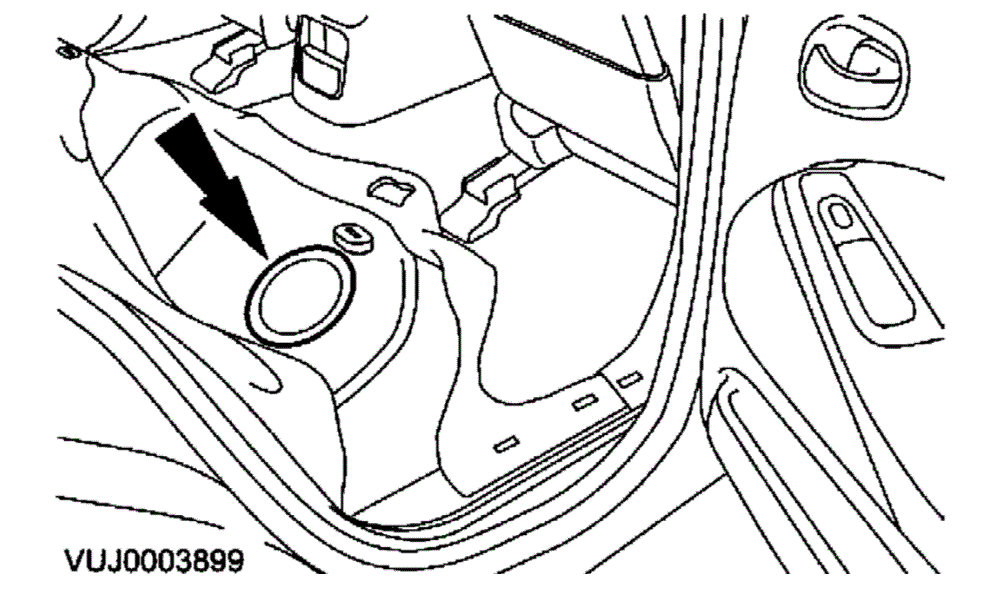

10. Remove the floor aperture cover.

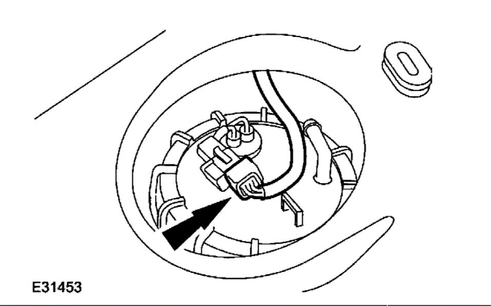

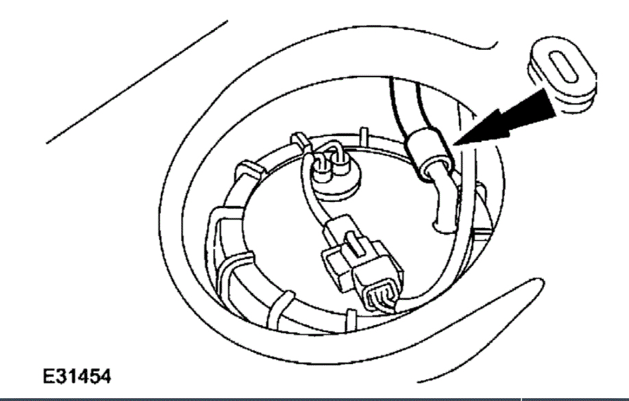

11. Disconnect the fuel pump module quick release coupling.
12. Detach the fuel pump module electrical connector from the retaining bracket.
13. Disconnect the fuel pump module electrical connector.

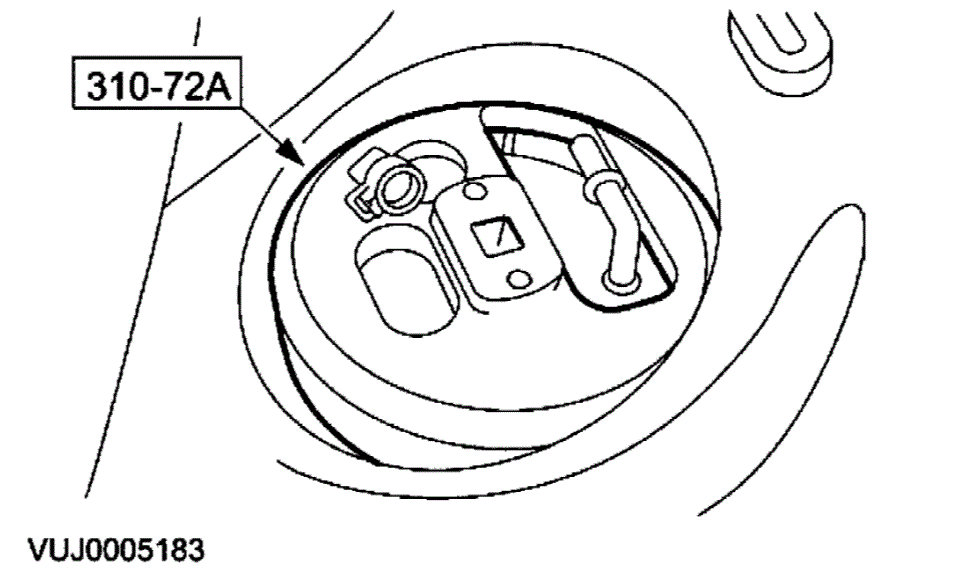

14. Using the special tool, remove the fuel pump module locking ring.
15. Detach and reposition the upper part of the fuel pump module.

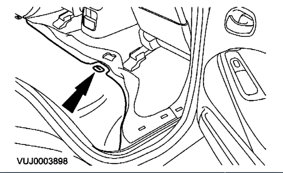

16. Detach and reposition the left-hand rear door opening weatherstrip.
17. Remove the scuff plate trim panel.
18. Detach and reposition the floor covering.
19. Detach and reposition the rear seat cushion insulation.
20. Remove the floor aperture cover.

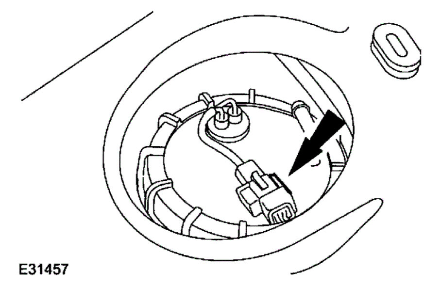

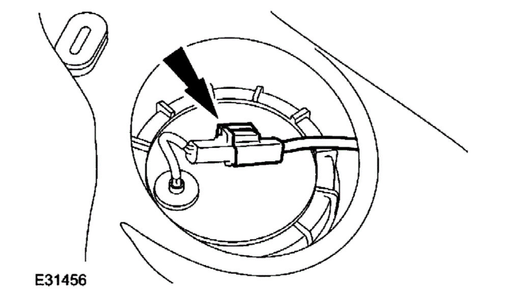

21. Detach the fuel transfer pump module electrical connector from the retaining bracket.
22. Disconnect the fuel transfer pump electrical connector 1.
23. Using the special tool, remove the fuel transfer pump locking ring.

I m sorry, these instructions do not mention anything about the quick connect hoses. I believe there two connections on the new assembly and there is also one two prong electrical plug. Million dollar question : how do you get to those?
Monday, September 14th, 2020 AT 6:11 AM
  • 52,797 POSTS
You need a special tool to remove them.
You can go to a parts store and they sell a set of them for expanding the spring lock. The tool is plastic and the tool comes in different sizes.
The set is about $10.00 to $12.00.
Monday, September 14th, 2020 AT 6:13 AM
JAIMSTER
  • 29 POSTS
I wasn't referring on " how to disconnect them" it's mostly how to reach them? I just don't see them they are not visible. Guess they have to be way across the top of the tank. I m assuming.
Hopefully I wont have to lower the whole tank!
Monday, September 14th, 2020 AT 9:25 AM
  • 52,797 POSTS
They are right at the pump once you open the access plate.
If they are not, can you post some pictures?
