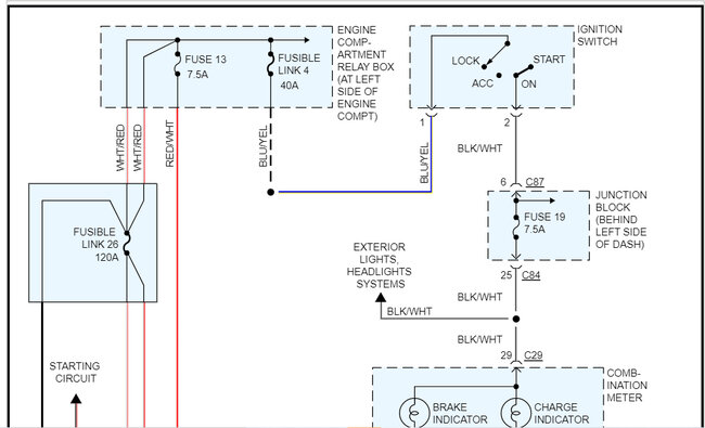

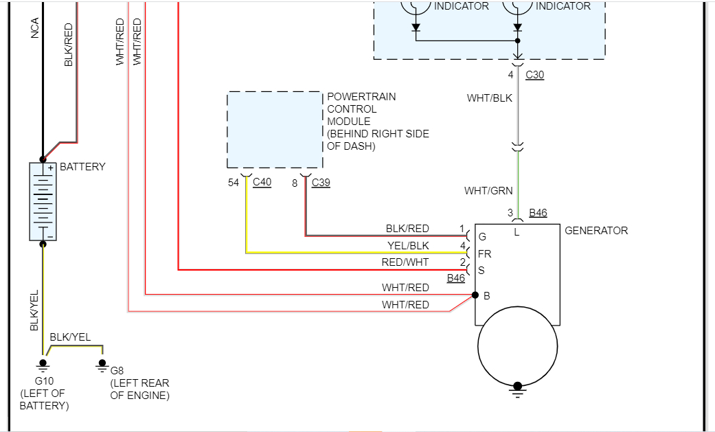

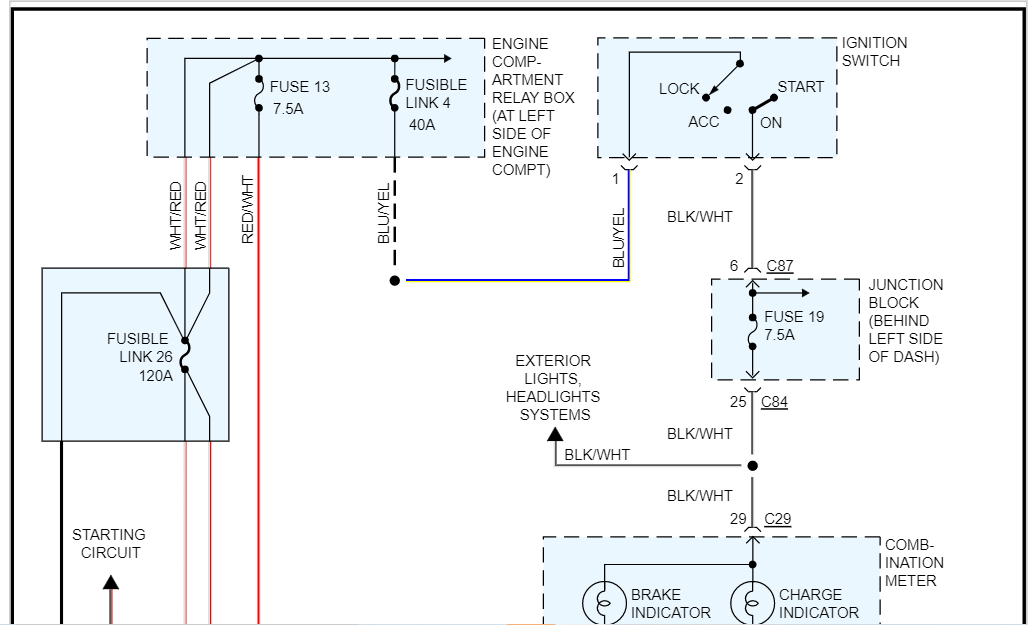

The components can both be good but there could be a wiring issue that is preventing the alternator from charging the engine.
Do me a favor. Follow the directions in this link and let me know the results:
I attached the wiring schematic below, so you have a reference. Make sure the red wire with a white tracer and the white wire with a red tracer both have power at the alternator.
Let me know what you find.

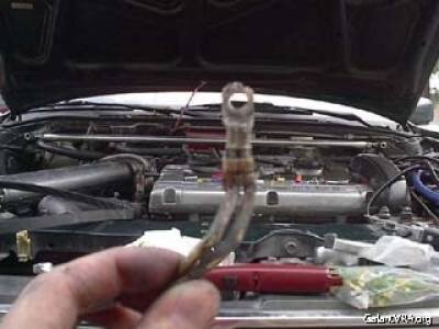

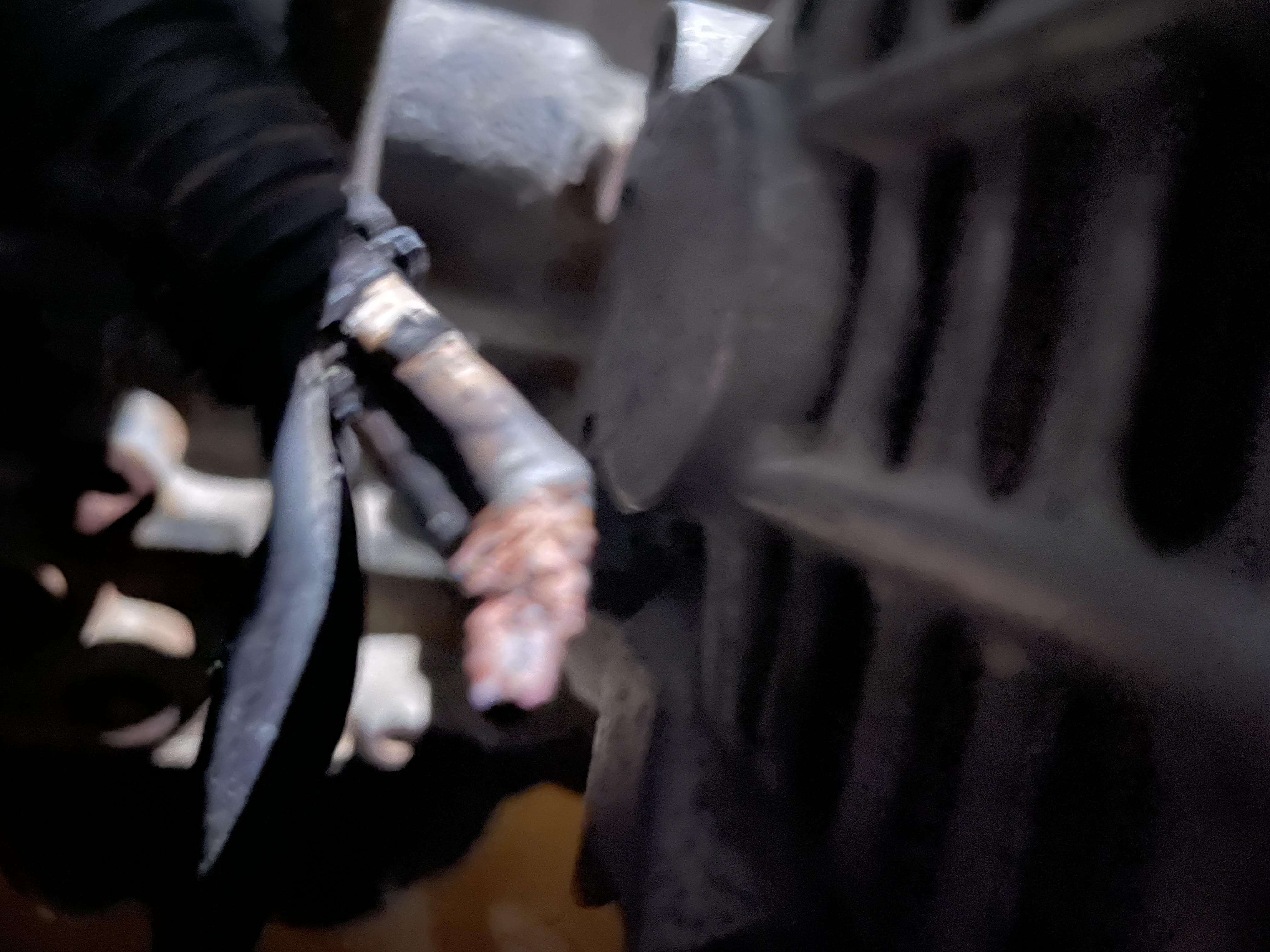

So, I found the issue this wire was loose and snapped while I was re-installing the alternator.
This is what it should look like.
Tuesday, November 8th, 2022 AT 8:42 AM
JACOBPAULSEN
  • 64 POSTS
But that snapped and now it looks like this.
Tuesday, November 8th, 2022 AT 8:44 AM
JACOBPAULSEN
  • 64 POSTS

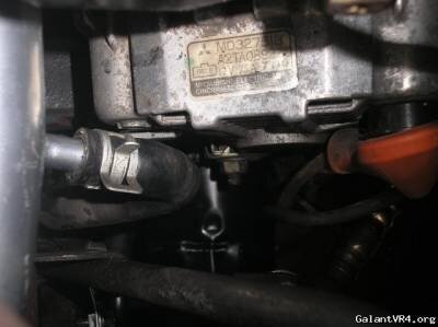

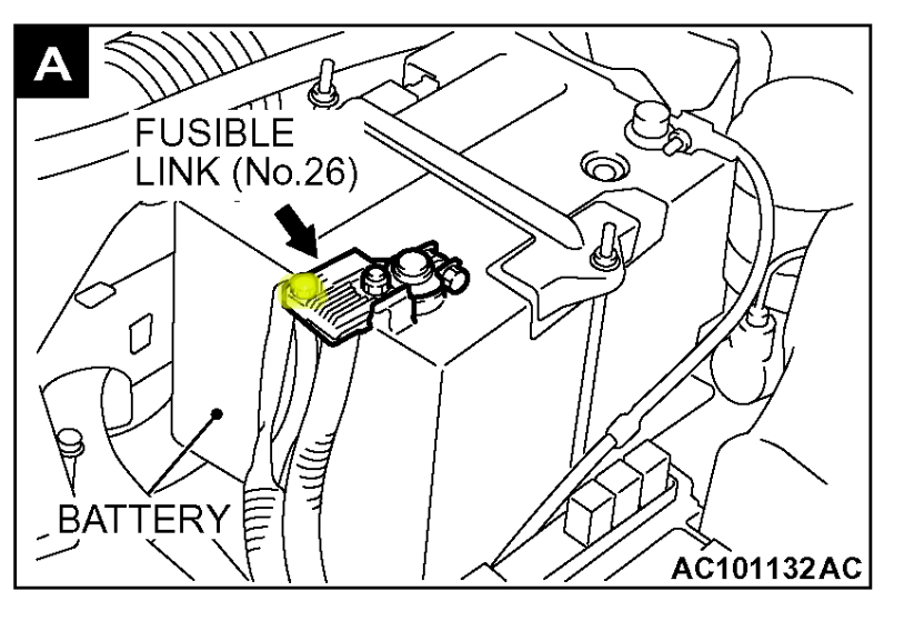

Also, what is this orange rubber thing called on the alternator?
Thanks,
Jake
Tuesday, November 8th, 2022 AT 8:45 AM
  • 110,192 POSTS
The orange thing is simply a rubber wiring insulator to prevent anything from touching that wire. It will always have power and will short if grounded.
As far as the wire you found, what color is that? It appears to be a fusible link. If the wires are white with the red tracer, the fusible link needs to be replaced.
A fusible link, in this case, appears to be a typical wire, but they are designed to fail just like a fuse if there is too much power through them.

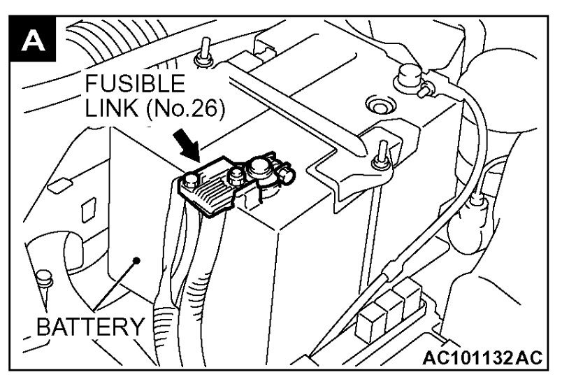

Let me know. Note If you look at the first pic I attached above, you will see fusible link 26, 120 amp. That is what goes to the white/red wires to the alt.

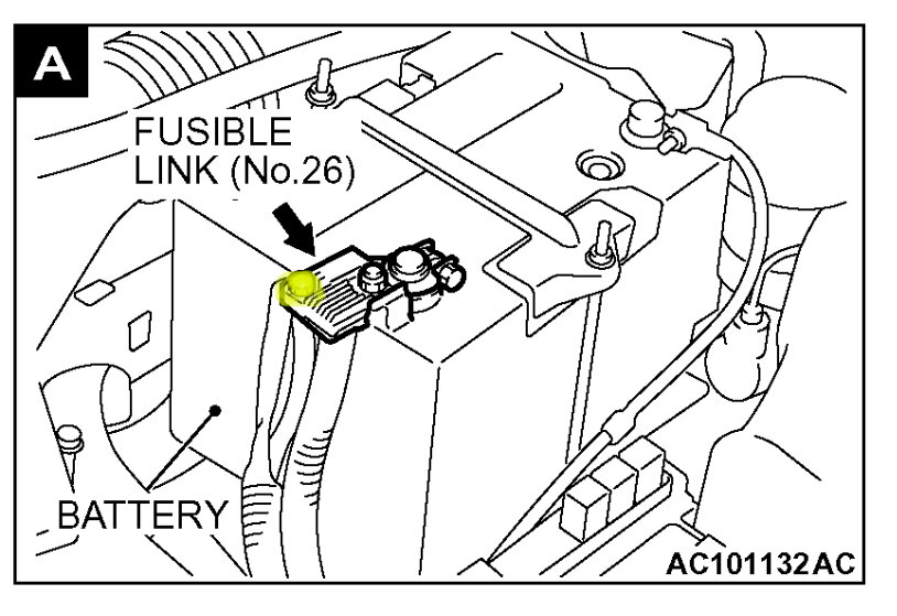

Let me know. Also, the fusible link runs from the battery to the alternator. I attached a pic below showing where it connects.
You will likely need to buy one specific to this vehicle. If you can't find one, we'll have to make one.
See pic below.
