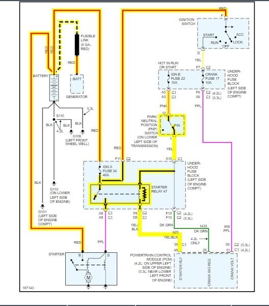

Good morning,
Does the security light or theft light go off after about 10 seconds? If it stays on, it could be security.
https://www.2carpros.com/articles/how-to-reset-a-security-system
I attached a wiring diagram for you to view. You will need a test light or voltmeter to do some checks.

Thank you for your help. Can I run another question by you? I think it's something in the steering column causing it to short out and drain the battery. I tried replacing the tumbler but I can't move it once inserted to put it in the correct spot, it keeps getting stuck. Do you know if Chevrolet usually have electrical issues like this? Because I can't seem to pin point what's actually causing the issue?
Monday, August 3rd, 2020 AT 8:29 AM
Okay, this could go back to the battery issue. If your battery voltage is low, it will cause the key to stick in the switch.
You must have 12.6 volts at the battery. If you have 12 volts or lower, the battery is almost dead.
Monday, August 3rd, 2020 AT 8:34 AM

I've already replaced the battery twice, but whatever electrical issue is going on is draining the power from the battery. Prior to replacing the battery, I changed the ignition switch, and it finally turned over, but when I went to restart it, it was completely dead again. I didn't think it was the battery at the time because it was only 3 weeks old, but eventually had it tested and it was totally dead. So that's when I bought another battery, eliminating that to be the cause of the issue. I also had been using the silver release button on the back lock cylinder to remove the keys from the ignition, but the last time I tried releasing them, the button wasn't firm like It should have been, and it was also extremely hot, which it should never be, in addition to being a little loose. It's at a shop now being looked at, but before paying extra money to get a new steering column, and on unnecessary labor, I wanted to get a second opinion. Based off of the information you know, do you have any ideas on what you think the problem is?
Monday, August 3rd, 2020 AT 11:30 AM
At this point, I have no idea since I cannot see it, touch it or diagnose it.
The best I can do for you is to help with what the shop tells you.
https://www.2carpros.com/articles/how-a-car-electrical-system-works
When they get back to you, get an estimate in writing with an explanation of the failure and post it to this question so I can review it with you and see if what they want to do makes sense.
Monday, August 3rd, 2020 AT 11:38 AM

Okay, he said he wants to replace the whole steering column, for $345.00, than an extra $150.00 to get it re-coded, but doesn't think that's the main issue.
Monday, August 3rd, 2020 AT 1:34 PM
Okay, why does he need to replace the column?
The price is not bad but what is the root cause of failure?
Monday, August 3rd, 2020 AT 1:38 PM
DANIELLE MAIDA
  • 6 POSTS
I'm not sure why he wants to replace the whole steering column. I think he needs to check the ignition switch and the lock cylinder to see if their installed correctly or just order new ones to see if that is the cause of the problem. He's not actually sure where the problem is originating, but wants to replace it anyways, my guess is just to be sure?
Tuesday, August 4th, 2020 AT 7:22 PM
It sounds like a guess to me.
I would tell them that if it does not fix the issue, you will not pay for it. They are guessing on your dime.
