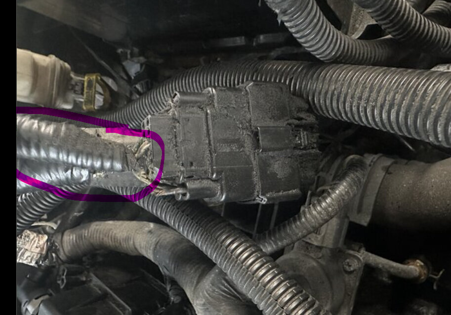

Okay yeah, I never saw connector c113. I’m pretty sure that’s the problem there’s a wire that’s broken and i’m pretty sure it’s the purple one, the whole connector is really dirty though so it’s hard to see but using the picture for reference i’m 99% sure it’s the right one.

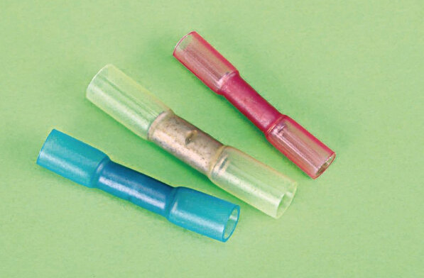

Is the wire broken close to the connector? Can you take a picture? Since it's just a power feed, I usually use heat shrink crimp connectors to keep any moisture out in the future. These are what I use if there isn't room to solder a connection. You strip off about a 1/4in of insulation off the wire end, crimp the connector on, then heat the ends, it will shrink down on the wire. And the really good ones have a type of adhesive that seals the connector to the wire. I use a heat gun to shrink the connector down, but you can use a lighter just as long as you don't overheat the heat-shrink section. If the C133 connector is dirty inside, auto parts stores carry terminal cleaner, it's a spray you can use for inside the connectors that will evaporate, not leaving any harmful chemicals inside the bulk connector.
Take a picture of the connector so I can see how bad it is. I'm surprised you had any voltage reading at all.

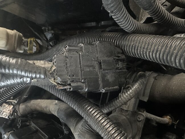

Here is a picture of it.

Is that electrical tape all over that conduit? I'd take a look at the wiring under there, is that where the broken wire is? Looks in rough shape at the beginning of the connector.

No, it’s the same material that’s on the rest of the wiring harness and yeah, it’s pretty bad there are some other wires that aren’t fully connected either.

When doing wiring repairs, and there's insulation that has been missing off the wire for a while, strip the insulation back to crimp a connector on make sure the wire hasn't gotten corroded inside the insulation further up. Even a small section of wire that's missing insulation can become corroded inside. The corrosion just grows up into the wiring, so be sure it's clean wire strains when doing the repair. I've had whole sections of wire corroded inside just from a pin hole in the insulation. Sometimes the wire is actually missing inside the insulation because the copper strains just disappeared. You want your repair to last so a in a couple months you don't run into the same issue again.

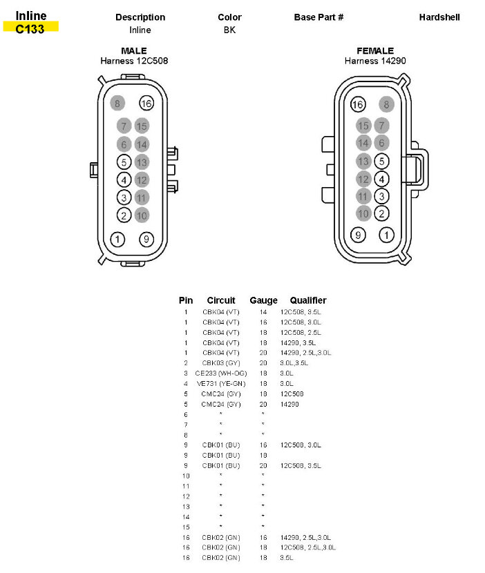

Okay i’ll keep that in mind. Some other wires pulled out of the connector too, how would I reconnect wires to the connector and could you find me a diagram showing what wire goes to what pin on the connector.

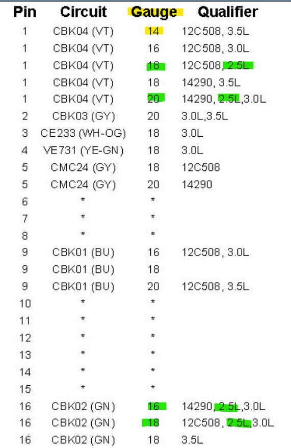

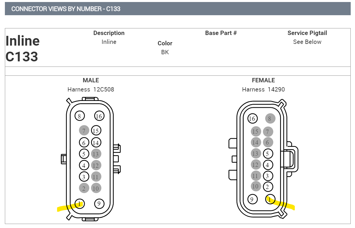

AL514
  • 5,584 POSTS
This is the pinout for that bulk connector with the wire coloring. Taking apart connectors like this is really difficult. The easiest, faster way is to just bypass the connector with new wiring, If the pins are pulling out of that connector like that, I think someone else has tried to fix it before and messed it all up. It doesn't look like there are many wires actually used in the connector if you look at the pinout.

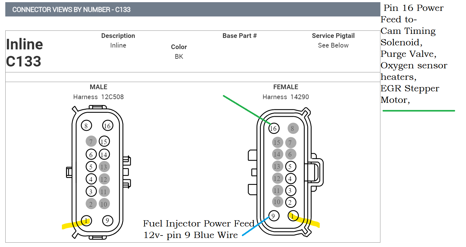

AL514
  • 5,584 POSTS

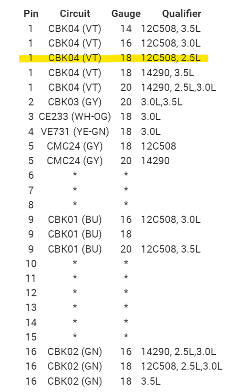

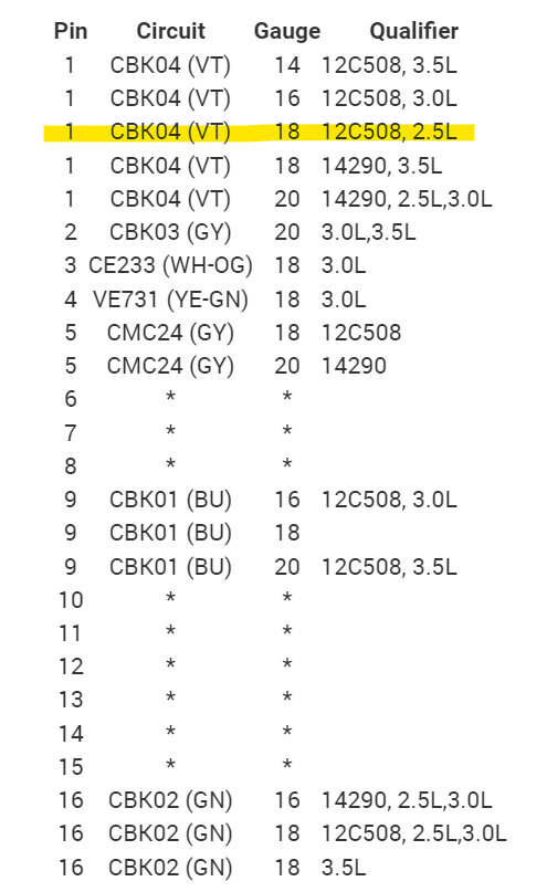

Yeah, I don't think there is anything on that connector that carries more than 20amps, I'll see if I can ID each pin, but I'm sure you'll be safe with 12. Actually, on the connector pinout diagram it shows that 14 gauge is the biggest wire in the connector, Ill post that for you to see, so you can use 14 or 12, the fuse is a 15amp fuse if I remember correctly, but those ignition coils won't pull 15 amps.

AL514
  • 5,584 POSTS
Okay, did you verify there's 12volts to each coil? And when you crimp those connectors, you have to make sure they are a solid connection. Did you do the entire connector of just the wires that has an issue?
Pin 9 is the fuel injector power feed, pin 16 powers the Cam Timing Solenoid, Purge Valve, Oxygen sensor heaters, EGR Motor,
Just need to figure out what pin 5 is for, but it sounds like there are other wiring issues going on. If that connector wiring was that bad, there has to be other wiring in the same condition. You've got 3 cylinder misfires, so if there is power to all the coils and injectors, then there has to be either wiring issues on the control side (ground) of those components, or the misfires are being caused by a vacuum leak, which is also causing the high idle.
