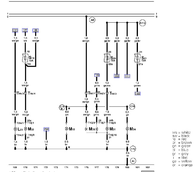

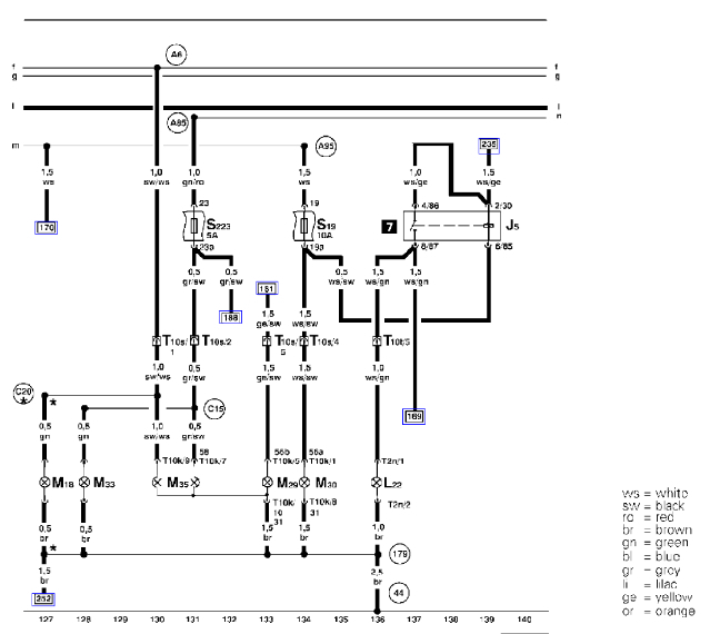

Looking for a fuse or circuit to test as my driving lights (not headlights) won't turn on when the light switch is pulled.
Friday, March 27th, 2020 AT 11:40 AM
DANNY L
MECHANIC
5,648 POSTS
Hello, I'm Danny.
Here is a tutorial showing how to check wiring:
I've attached 4 pictures of the front lighting circuit diagrams you've requested. I've cut the pictures (left and right side) into 2 pieces to be viewed larger in size.Hope this helps and thanks for using 2CarPros.
