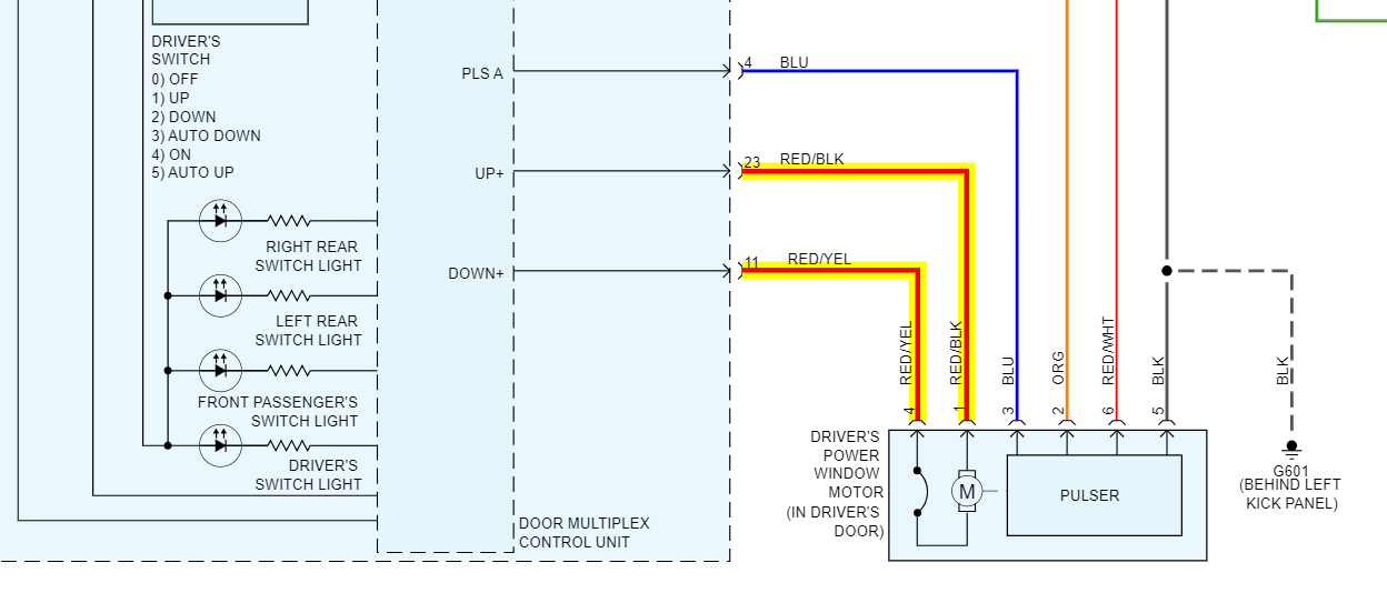

I seem to have the opposite problem of most who have posted regarding power window problems on the van listed above. All windows work except the driver's side. I ordered a new switch assembly and tried programming it with what info I had available, and it's exactly the same. Any ideas?

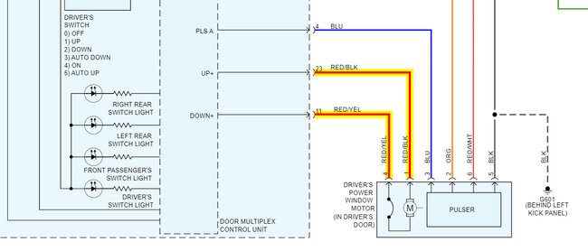

We need to check if the motor is getting power. The motor itself or connector could be bad.
If you look below, I attached a portion of the wiring schematic for the driver's door. There are two wires that go to it. One is red with a yellow tracer, and one is red with a black tracer.
When you press the button for the window to go down, power goes through the red wire with the yellow tracer to the motor, then out to ground via the red/black wire. When you request the window up, the opposite happens. Basically, the polarity to the motor is switched causing it to run in different directions.
So, I need you to check if that is happening. Disconnect the connector. Check each wire for power. You can use a test light or voltmeter for this. Also, you can use the ground that should be provided via the wiring as I mentioned, or another known good ground.
Let me know what you find.
See pic below.

The voltmeter (set on 20v) reads only.1-.2 volts on each wire with the key on the #2 position. There is also a clicking noise in the switch at all stops.
Monday, August 21st, 2023 AT 6:54 AM
  • 110,192 POSTS

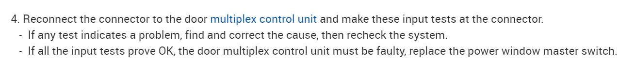

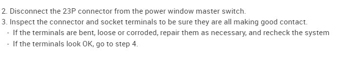

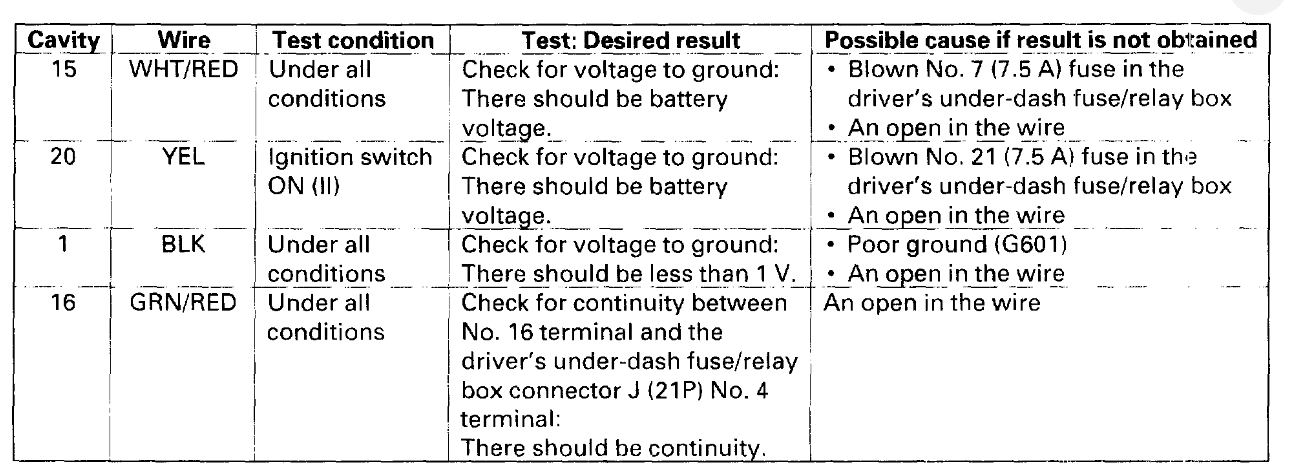

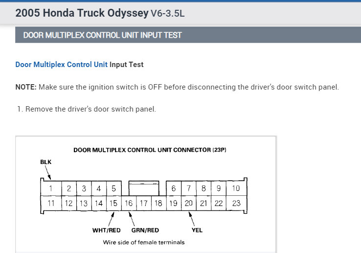

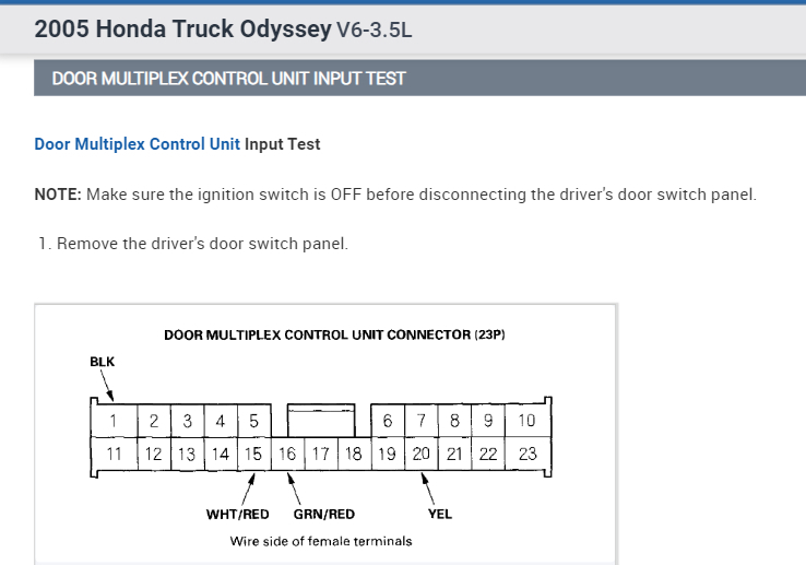

That is why the window isn't working. There isn't enough power. Now that you have confirmed the power is an issue at the motor, we need to check it at the door switch. Follow the same wires back to the door switch and check there. If there is no power at that point, we need to check if there is a ground issue or other related electrical cause.
If you look below, I provided the diagnostics for the multiplex door control module (main driver's window switches). Take a look through them and let me know if you are comfortable performing them.

Sorry, I guess I wasn't clear. I checked the voltage at the connector to the switch, not at the motor.
Monday, August 21st, 2023 AT 7:05 PM
  • 110,192 POSTS
No problem whatsoever. If we don't have 12v at the switch, the window won't work. Is it possible for you to check the power at the motor as well just as confirmation? Also, did you look at the chart above indicating where the issue could be based on test results?

So, I left in the morning and didn't think I'd have time to check the connector at the motor; but I did. It's reading 11.6 v on both the red/yellow and red/black when the switch is activated up and down. Does that pretty much incriminate the motor? Thanks again,
Marvin
Wednesday, August 23rd, 2023 AT 9:56 AM
  • 110,192 POSTS
Hi Marvin, if it is getting power, the motor is the most likely suspect. Since you are getting power to both, that means the opposite is providing ground as needed. That leaves the motor.
