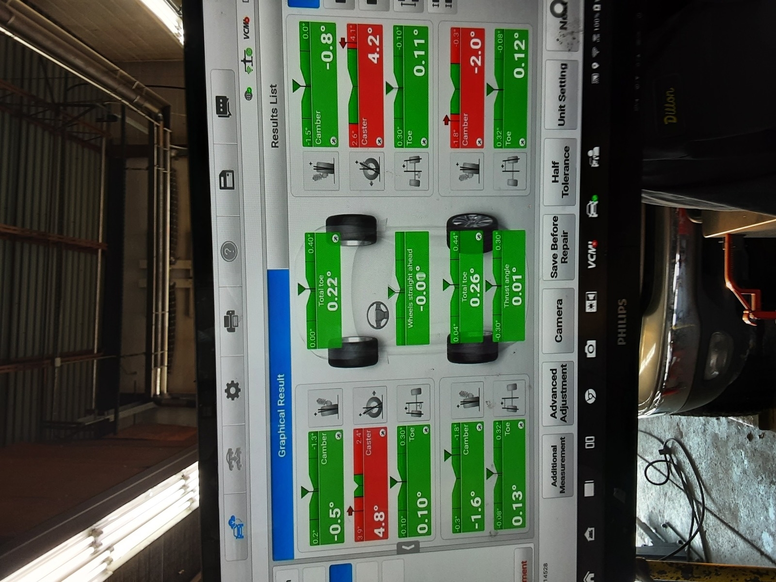

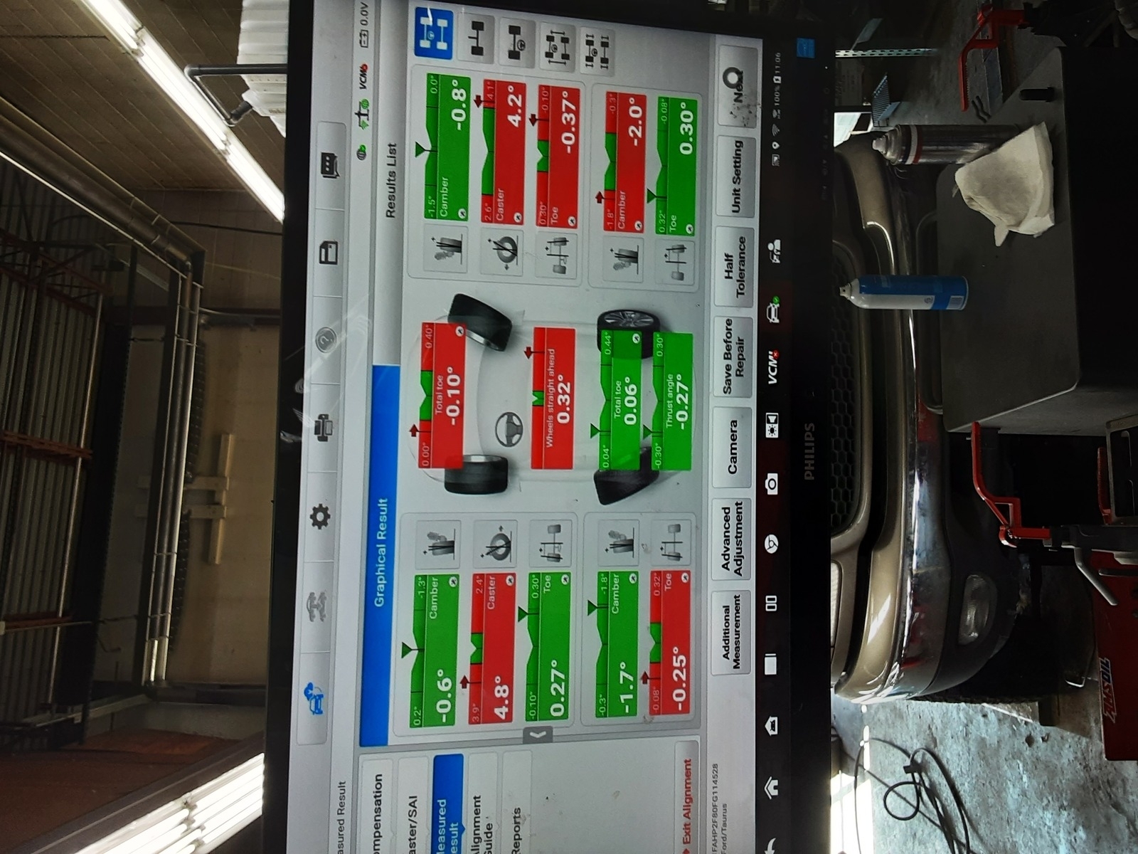

Okay that makes sense. Also, I have my alignment paperwork, can you take a look? My caster is way off, but they did the alignment with the used (all different) tires I have on. I’m replacing with brand new tires this weekend. But my question is how do I get my caster to be in spec? Because I think that’s what’s causing the pull under acceleration. That and tires. It’s just that I’m getting so many different answers I don’t know where to start.
(First pic is before alignment. second is after)
Mar 4, 2025 at 10:58 PM
STEVE W.
  • 15,172 POSTS
Caster typically won't cause a pull. Camber and toe can. The rear camber could be enough to cause an issue but that might not be adjustable without an add on kit to allow adjustment.

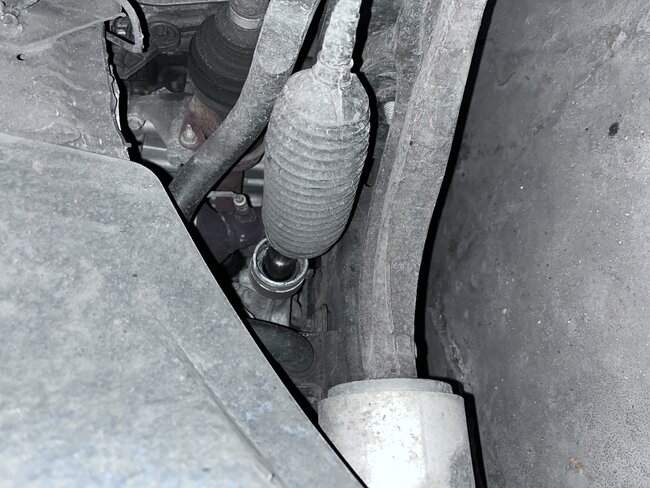

I was looking under my car and I saw this on the passenger side. I believe that’s the rack and pinion. (pic below) Could that be what’s wrong? The loose sensation in the wheel and it pulling to one side. The higher the speed the more my steering wanders back and forth.
Mar 11, 2025 at 2:09 PM
JAY0318
  • 16 POSTS
Or would that be the inner tire rod? I’m new to all this I don’t fix cars but being a women shops try and recommend things I don’t need sometimes so I’m trying to pinpoint myself with the help of you of course.
Mar 11, 2025 at 2:29 PM
STEVE W.
  • 15,172 POSTS
That is the inner tie rod end and the boot that covers it is off. That isn't a good thing as it can cause a lot of wear, however if you can try to "steer" the tire and don't see or feel play in that joint it isn't what is causing this. The thing is you will want the boot repaired to keep any more damage from happening. It might just need a new clamp ring installed.
