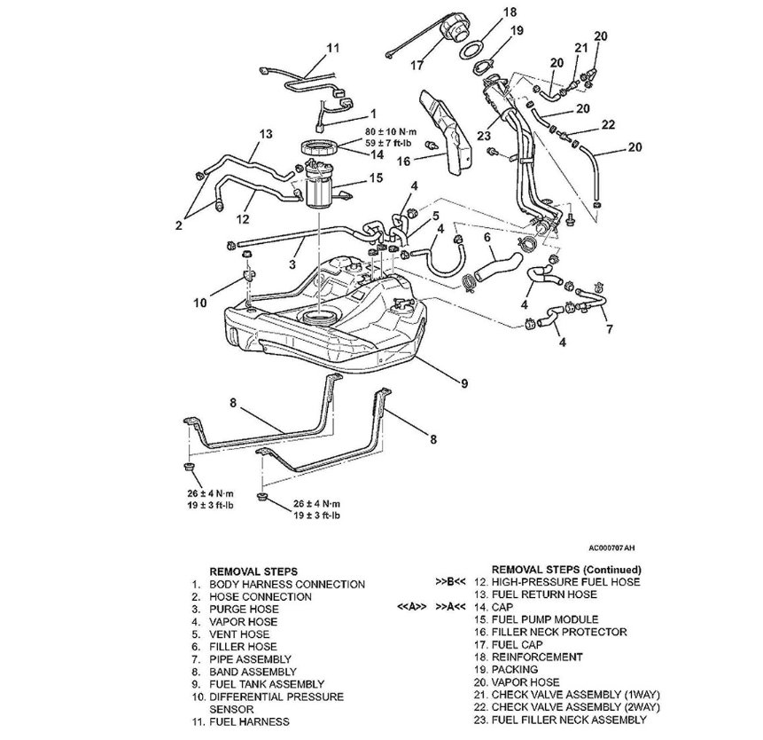

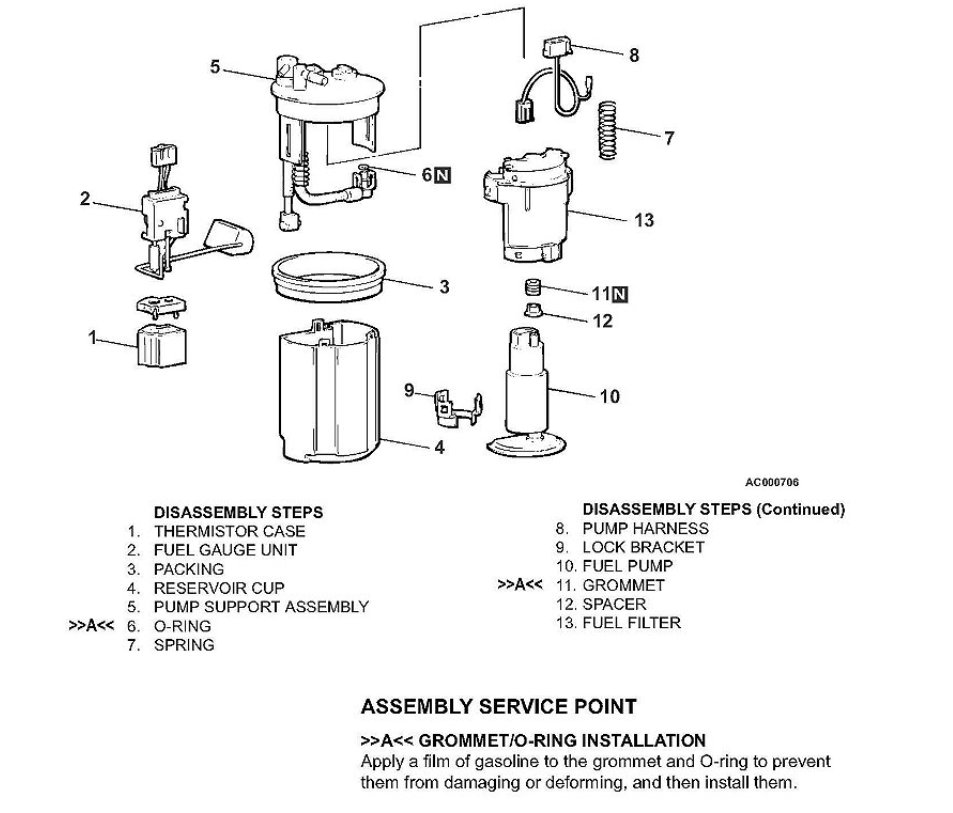

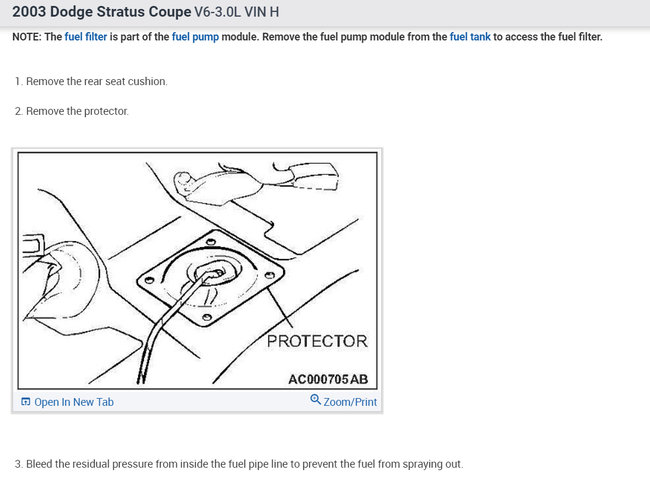

Where is the fuel filter located?

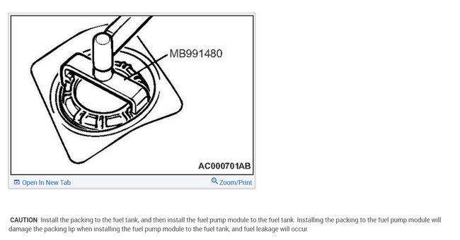

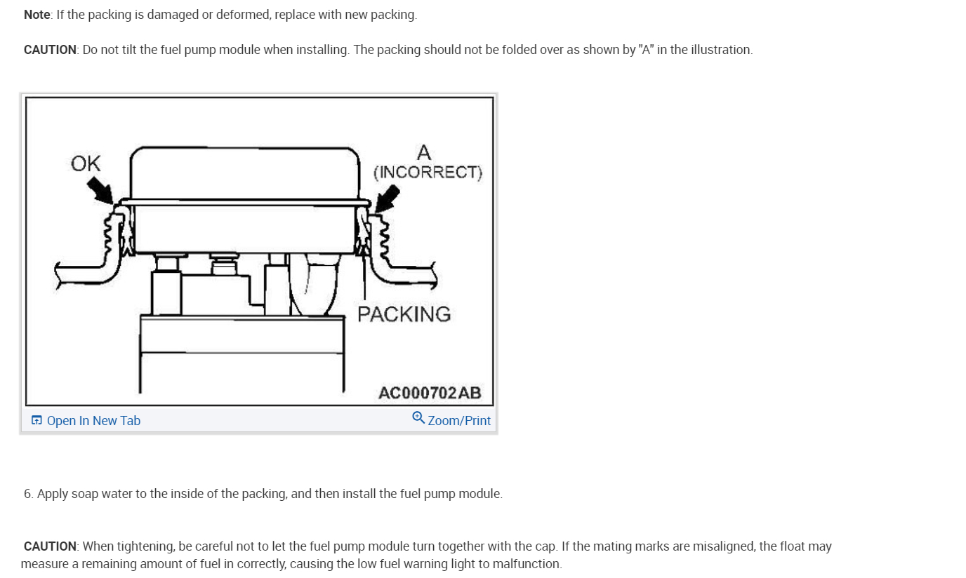

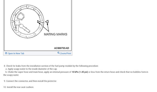

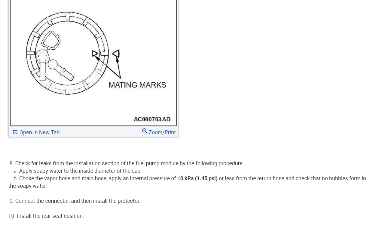

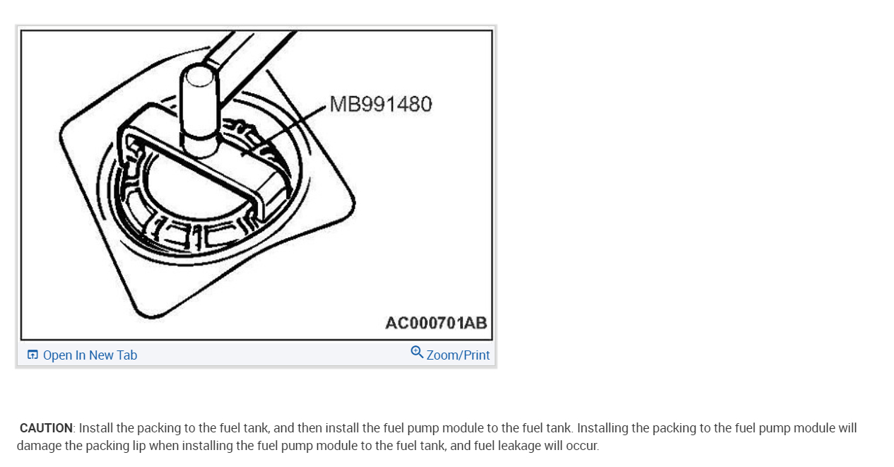

Here is a guide to help walk you through the steps of how to change your fuel filter with diagrams and instructions below to show you on your car.
https://www.2carpros.com/articles/how-to-change-a-fuel-filter
